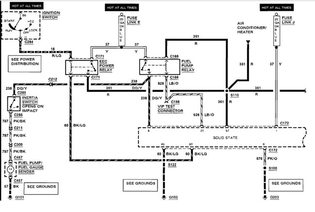

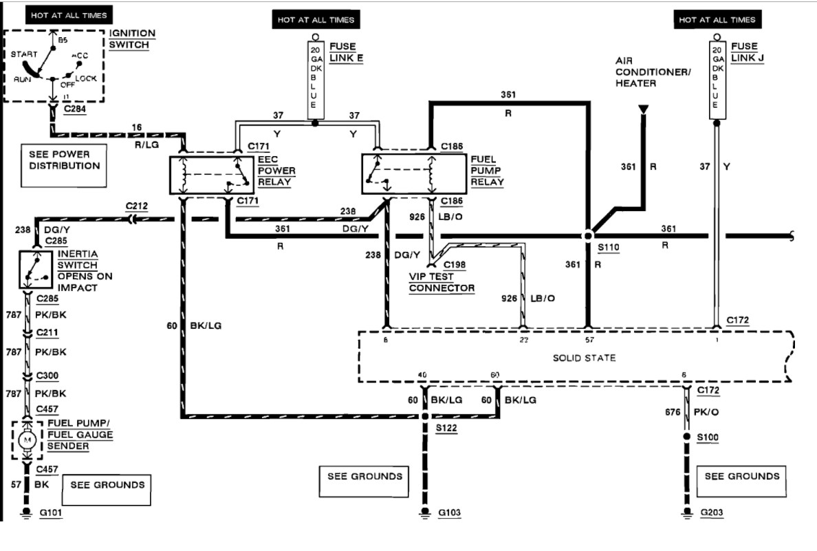

Went to start vehicle but just flooded so bad filled cylinders with gas and drained into the oil pan. I kept trying it and finally would not fire. Figured out through the internet the fuel pressure regulator went on it was bad changed it but will not start now. More from the internet found the EEC power relay tested okay. checked the fuel pump relay the test explained to check number two and number four wires are okay. When I jumper number three and number four wires to manually activate the fuel pump this is not supposed to start the fuel pump until I turn the ignition key on but it starts the pump with the key off. Would there be something in the ignition that is sending power there all the time?

Couple questions you say the fuel pump runs all the time no matter what? and what do the spark plugs look like can you send me a picture?

Thanks for getting back. The pump keeps going when I do the test. Power when I jumper the wires should just be when the key is on. The plugs were pretty good and I put new ones in now. Old ones gone

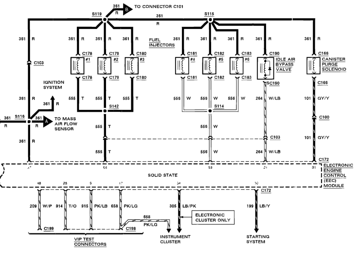

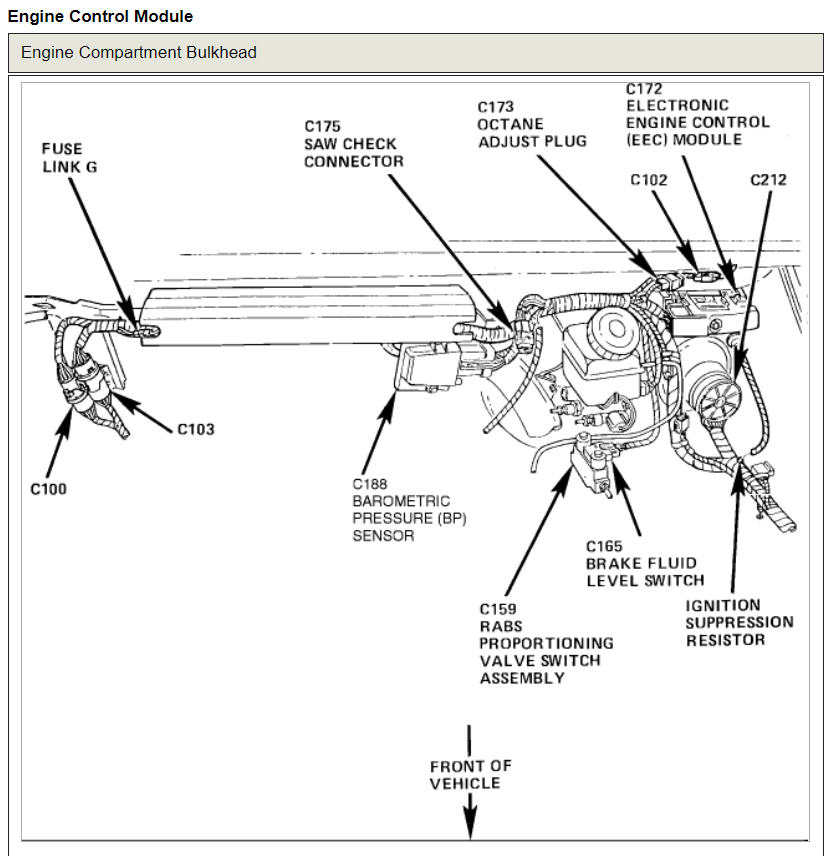

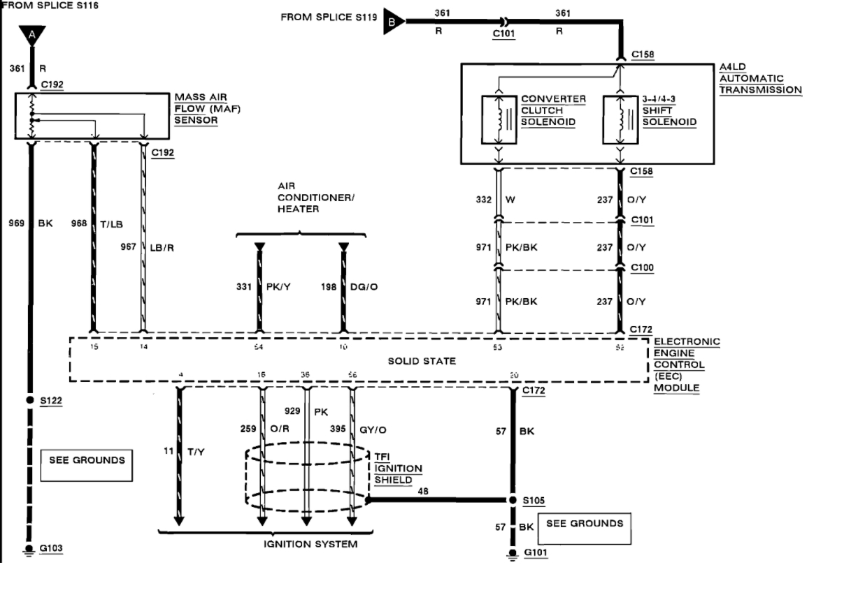

O man, It seems like the computer is having a problem the codes are all over the place, Check the power and ground for the PCM then replace it with a used up here is the locations guide and wiring diagrams to do so.

Well thanks for being so helpful and responding. The codes meant nothing like you said but somehow with taking the fuel pump relay and the eec power relay apart from their connectors and putting them back together again many times while testing them when I was checking the codes while turning the key off and on I noticed that the fuel pump started cycling. I had put on a new fuel pressure regulator on which was the original problem but didn't start the pump. The motor started today and finally smoothed out after awhile but I am going to check the fuel pressure when I can get a fuel pressure tester.Thank you so much for this web site that we can share our problems and you bare with us and I will keep an eye out to maybe help someone else.A word to the wise if your fuel injected motor starts flooding don't keep trying the engine will never be the same. THANK AGAIN
