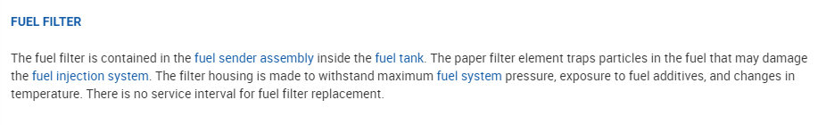

Looking for a fuel filter.
Sep 3, 2019 at 3:39 PM
More than likely you cannot find it because this vehicle has the filter as part of the fuel sender or pump that is inside the tank.
These are not serviceable. Which means you do not need to replace it unless you need to open the tank and pull the sender for some other reason. Basically, if the pump/sender fails, then you get a new filter with it.
Let me know if you have questions. Thanks
