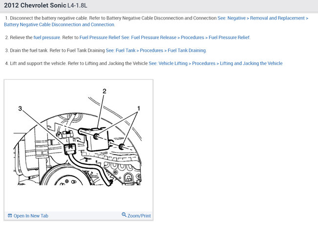

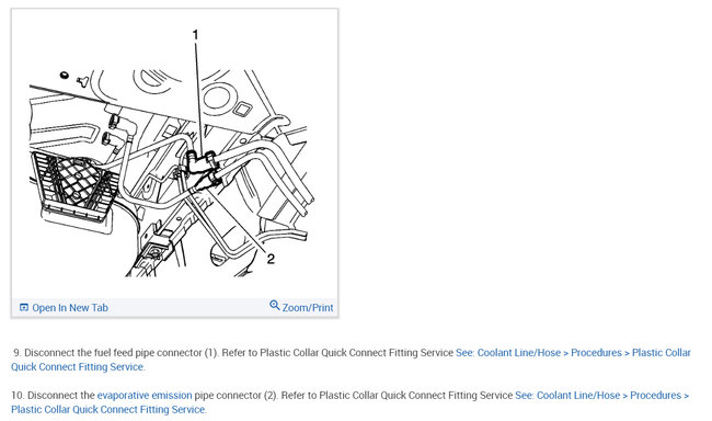

I have a 2012 Chevy Sonic and every time I fill up with gas it won't kick over and run unless I feed it gas. I looked it up and realized I can't change the fuel filter and I also checked the fuel pumps and hope that's not the solution to my problem. Please any and all suggestions and input is welcomed and greatly appreciated. Thanks
Mar 16, 2016 at 9:45 AM
HMAC300
  • 48,601 POSTS

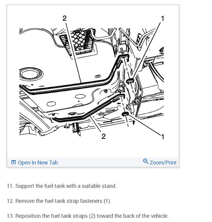

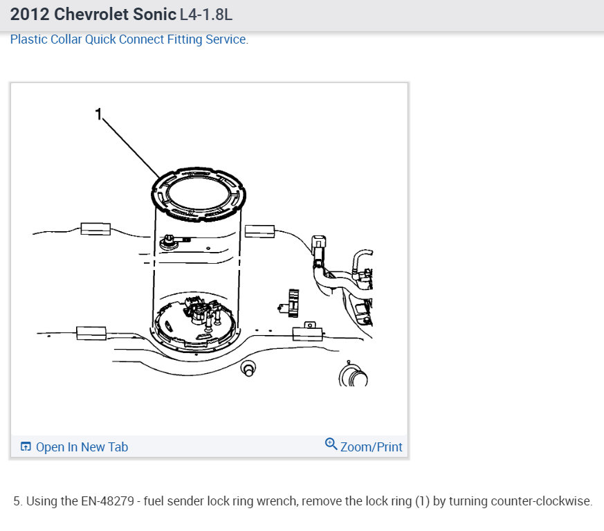

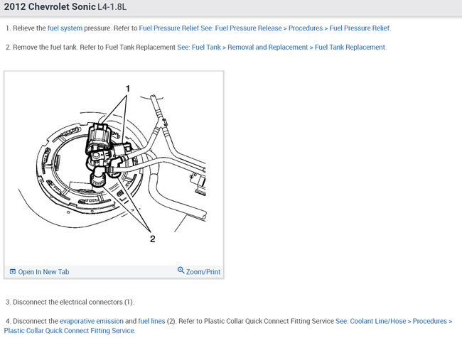

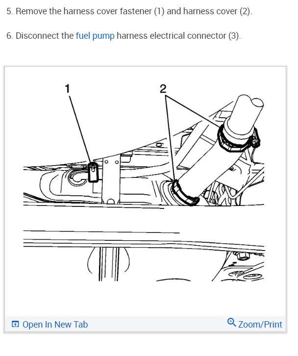

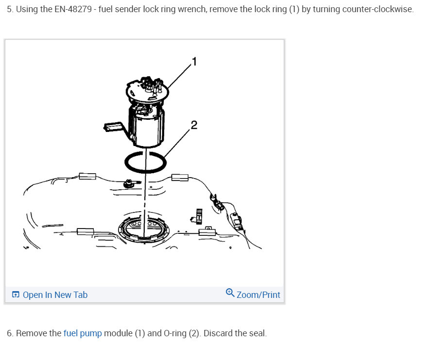

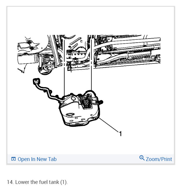

The fuel filter is in the tank on this car here is a guide to help walk you through the repair with diagrams below to show you how on your car.
https://www.2carpros.com/articles/how-to-change-a-fuel-filter
