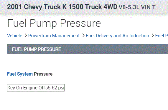

My truck keeps stalling out and backfiring when I press gas. No codes are pulling up. New fuel pump. Not sure why it is doing this. I have a new transmission. ECM has been flashed.

Although the fuel pump has been replaced, the regulator could be faulty, so it is a good idea to confirm the fuel pressure is within the manufacturer's specs. Here is a link that shows how to test pressure:
Pic 1 below shows the fuel pressure specifications.
