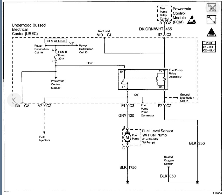

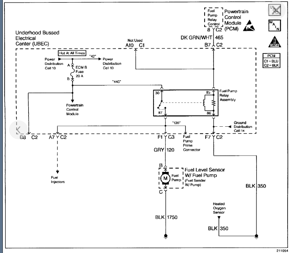

okay, so i rented the pressure gauge kit but to my dismay now the pump won't actuate when cycling the key. I wired the pump direct and it runs as does the old one I removed so I think I have an electrical problem. I checked the fuses and they are good. I swapped out some relays to no avail. I only have juice to one prong on the relay (there are 4) I'm not sure if I should have juice to more than the one. Something is keeping the fuel pump from running. My security light does not blink. It comes on but goes out so I don't think the anti-theft is the problem. I checked the ground at the rear of the truck and it is not broken. I even ran a ground wire from the battery to the pump but no success. Is there an inertia switch on this truck? Any help appreciated. Also my gas gauge doesn't work with the new pump which I suspect is the sensor or fingers on it are not making good contact.
Jun 6, 2020 at 6:46 AM
I attached the wiring diagram. Let me know what pin you have power on. You should have power all the time coming from the fuse. Then when you turn the key on you should have power coming from the Dark Green and White wire on B7 which is the control wire from the PCM (terminal 85 on the relay). Basically this supplies power and the relay gets closed. The F7 (terminal 86) wire is the ground wire for the relay control so it should not have voltage on it.
When you have power on the B7 wire and it closes the relay you then have voltage on the A7 and F1 wire (terminal 87). This is what powers the fuel pump and injectors.
What I would suggest is jumping power from 85 to 87 terminal and see if the pump turns on with the key on.
Let me know what happens with this and we can go from there. Thanks
FYI, when you are looking at the relay and you remove it, the terminals are in the position shown on the diagram. So when the relay is out, the to left is terminal 30 and the top right is 85. So jump 85 to 30 if you have power on 85. Let me know. Thanks
