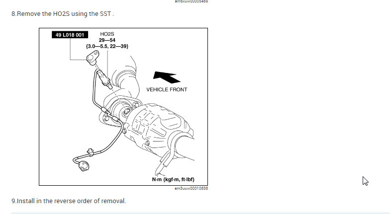

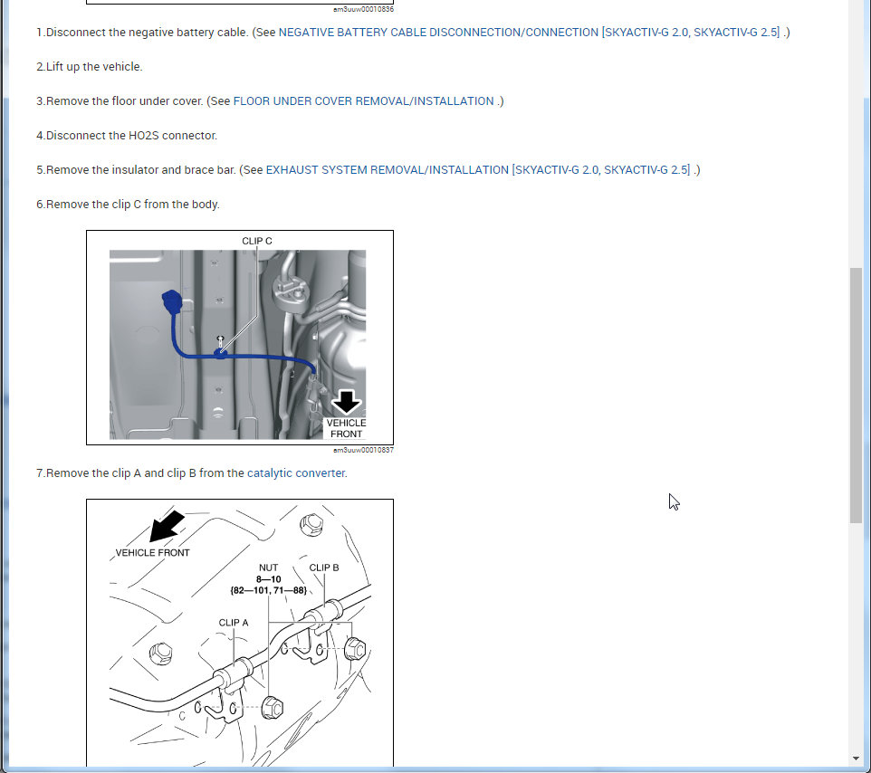

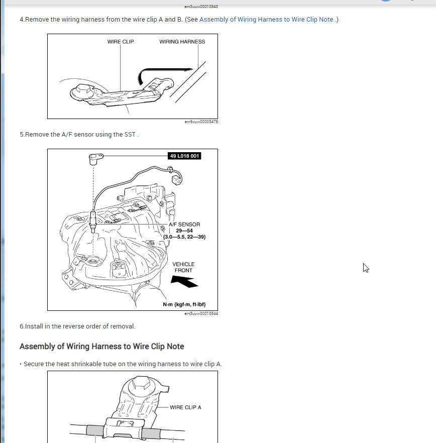

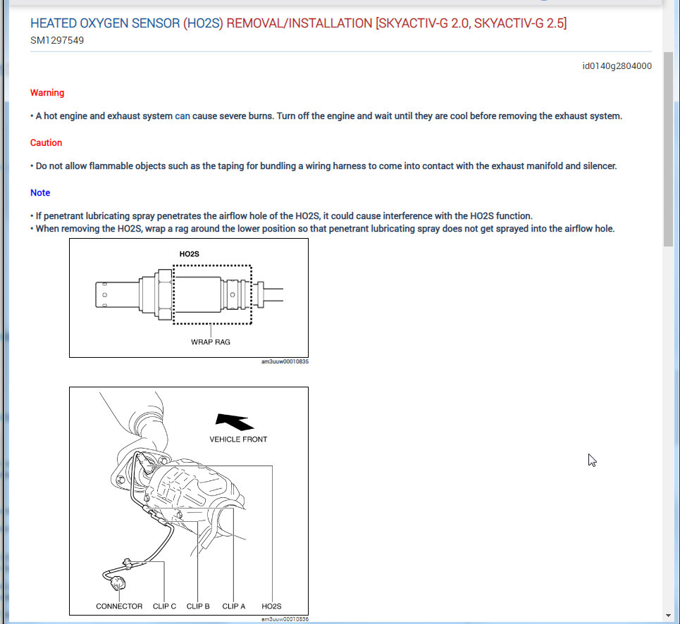

If it were me, I would replace the o2 sensors and then drive it about 150 miles to allow the PCM to relearn the new sensors and track the mileage as you go. I suspect it will get better as you drive.

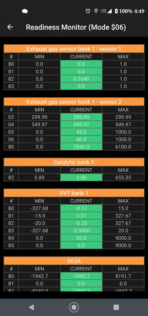

GIZMONATOR

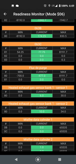

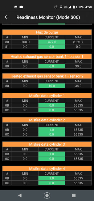

This is current obd scan.
Feb 1, 2021 at 7:01 PM
That is your emissions monitor data. Basically that is a snap shot in time. If the long term fuel trim was positive and the short term was staying negative then you have an issue there. The long term fuel trim is a better representation of what is happening because that is a larger picture as it takes a while to change that.
