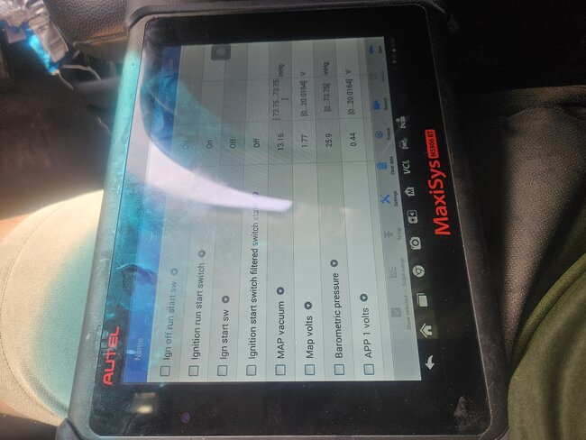

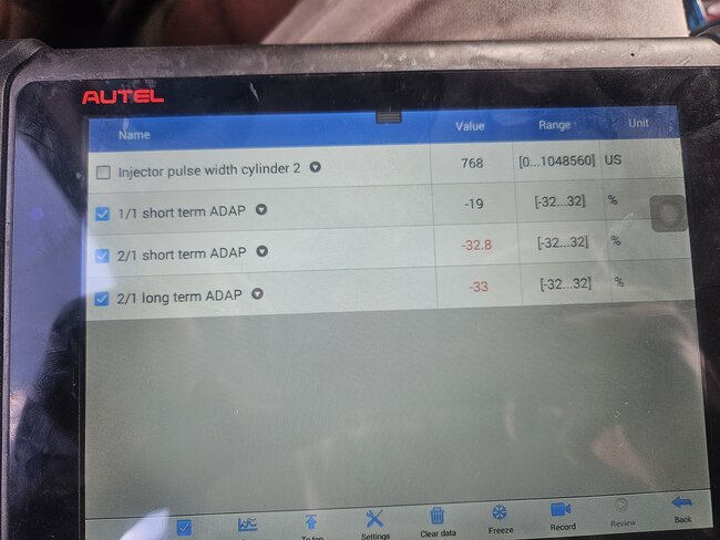

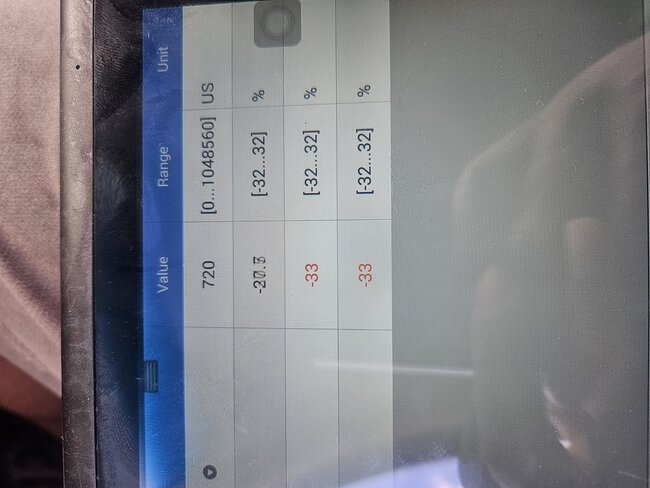

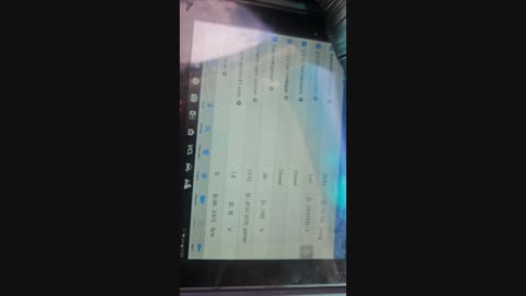

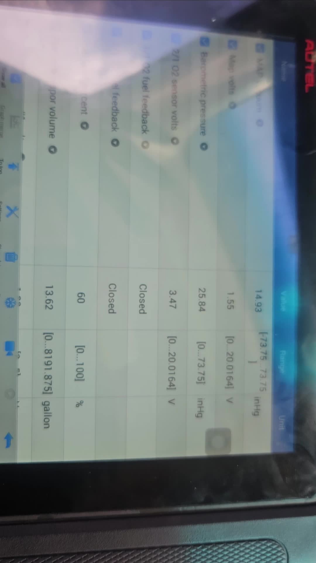

When i turn it on it struggles a little and then idles rough but will stay on but then if i press accelerator down let it go it wants to shut off. my fuel trim is showing -34 all my injector pulse are active and normal the

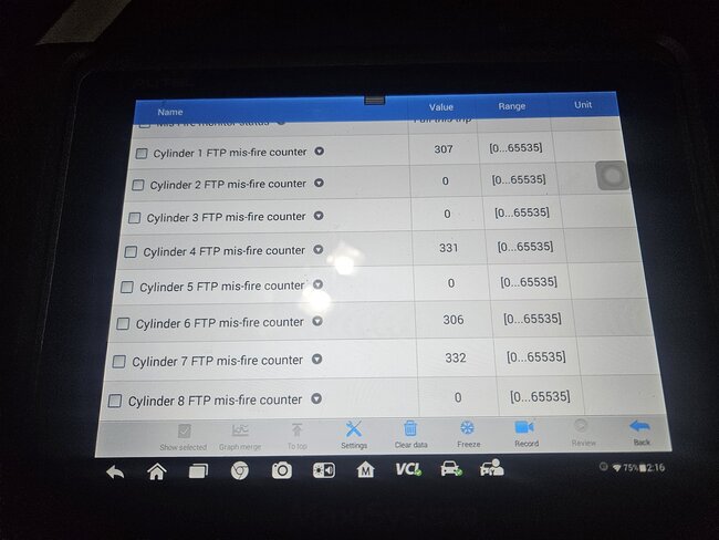

DTC code i got was p0172 and p0175 i was think vacuum so i changed all intake gaskets and check vacuum i have pics of what those show i reset codes and they haven't come back but it is still dying after i hit accelerator also i am not having any misfires.

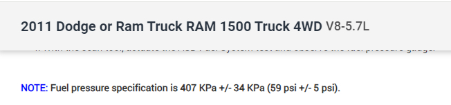

Are the fuel trims still the same? As far as a neg 34 STFT, that indicates the PCM is trying to cut the amount of fuel to the cylinders. Often, that is a result of a faulty fuel pressure regulator. Have you checked if the pressure is within the manufacturer's specifications? If not, that is where I would start.
Here is a link that explains in general how to check it:
I attached the manufacturer's fuel pressure specifications below.
See pic below.
Apr 5, 2024 at 1:46 PM
KINGJD123
  • 104 POSTS
Just checked it and it is in spec. what is the next you would try and yes they are still negative?

I went back through the pics you attached above. I didn't notice any for the engine coolant temperature sensor. Before starting the vehicle, what signal is the ECT sending to the PCM?
Apr 19, 2024 at 1:38 PM
KINGJD123
  • 104 POSTS
ECT is reading valid outside temperature I thought it could be IAC Valve so change throttle body same problem could the intake runner make it run rich on both banks. When I was cleaning intake, I took the runner off.
