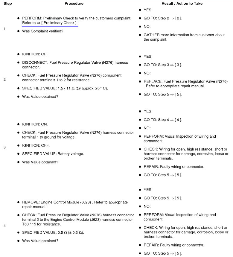

Car started slowly, turbo not working, acceleration is lacking, hesitates at times but still drives. Fuel pressure regulator malfunction.
Jun 22, 2022 at 3:08 AM
SQM
  • 6,383 POSTS

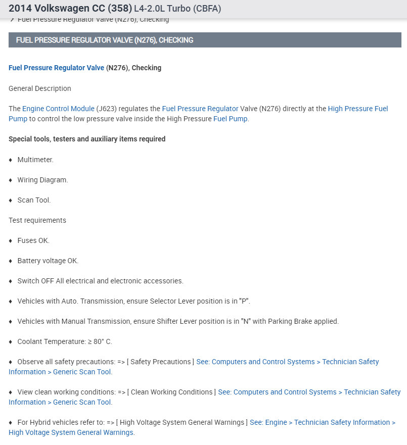

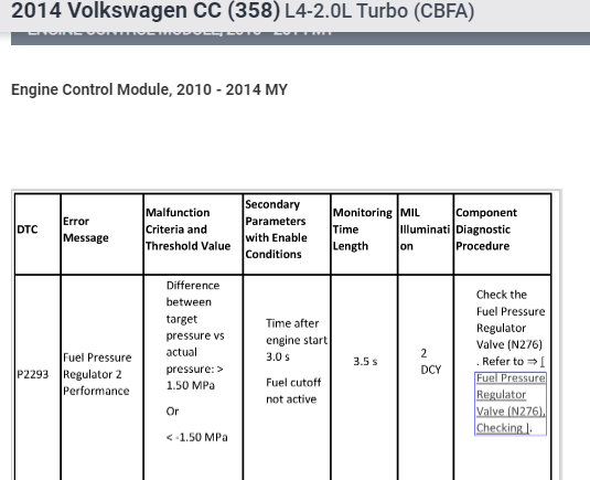

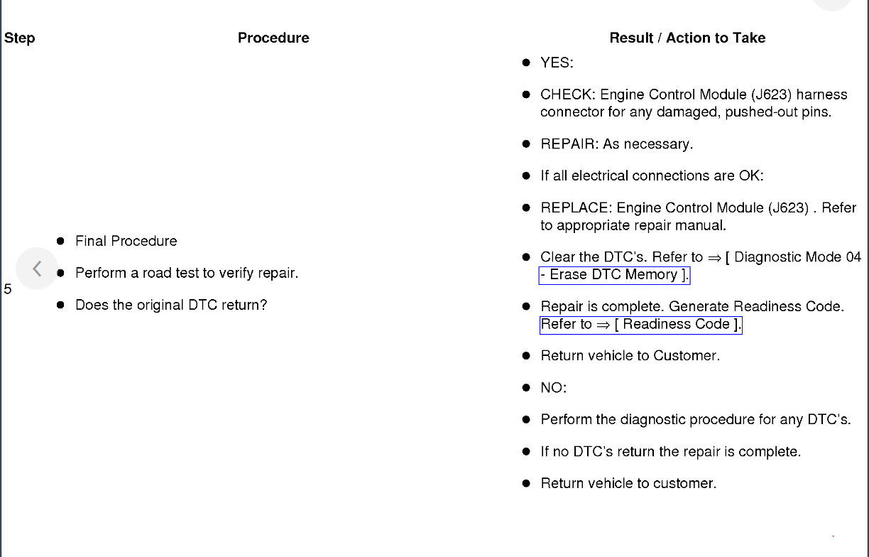

This could be due to a faulty fuel pressure regulator or an issue with the circuit.
I have attached the troubleshooting procedure for the code P2293 below.
Follow those steps, as it can help you determine the issue.
Let me know of any questions.
