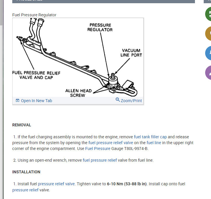

truck will stop at read lights and stop signs. after about thirty minutes it will start and run for about ten minutes and stop running again. i have no way to test the fuel pressure. the fuel rail does not have a test port. i fixed a broken wire under truck and i got the odometer started working.. i just don’t know we’re to start.

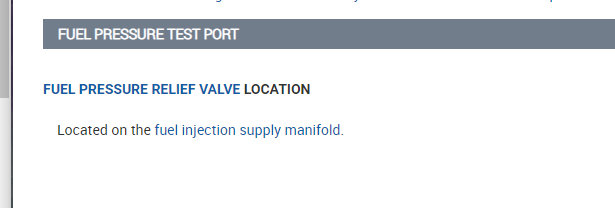

You are correct that there is no traditional schrader valve to connect a gauge as shown in this guide. This requires a special tool to hook up the gauge to the pressure relief valve.
Please run through the testing and info below and let us know if you have questions on this. Thanks

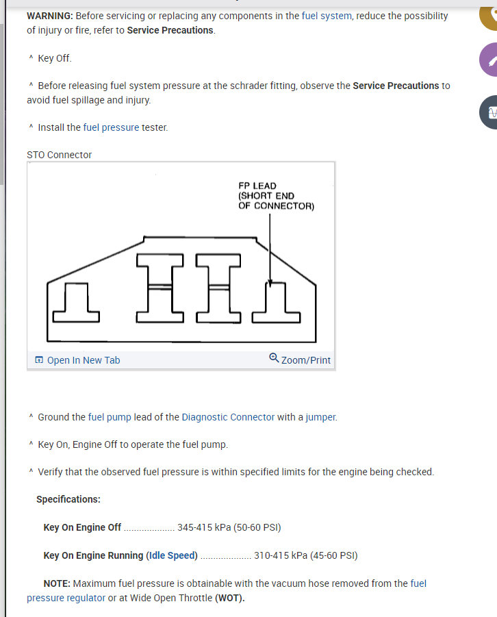

Good afternoon,
The test port is on the fuel rail. You can rent the tester at a parts store.
Key On Engine Off 50 - 60 PSI
Key On Engine Running 45 - 60 PSI
Check the spec with the key on.

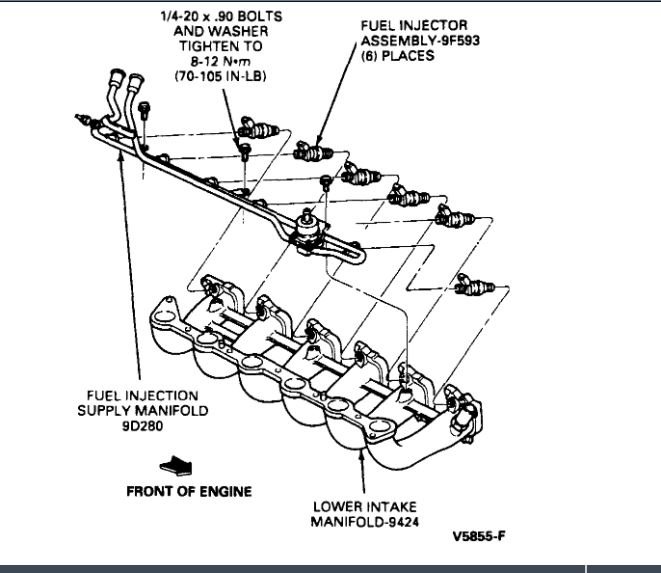

The 4.9 Ford does not come with a test port. so what else can I do? None of them do I have tried to get one at the junk yards. please check this out. now what else can I do?
Jul 28, 2021 at 8:39 AM (Merged)
Then you have to break into the fuel filter and install a T in the line. That comes with the test lit you can rent.

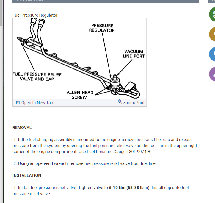

Hey Kapiton,
I got your message. I think we may be on different pages with the way we are describing this.
I think we are agreeing that there is no Schrader valve on the rail but the way in which Ford has you check the pressure is by removing that relief valve and install the tool number that is listed in the attachment below.
Or you can do what Roy suggested which is just open the fuel line somewhere else and put in "T" and attach the gauge to it there. General kits from any parts supplier will have what you need to do it this way.
