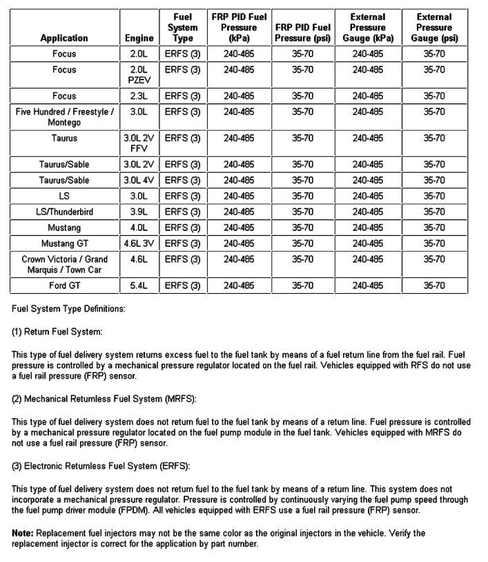

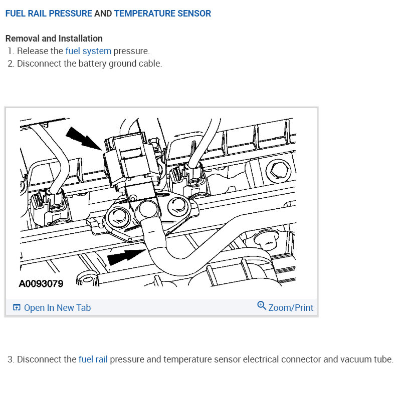

Hi, I would like to check the fuel pressure in my car. I can’t find a fuel pressure test port though. Does anyone know the location? Thank you for your help!

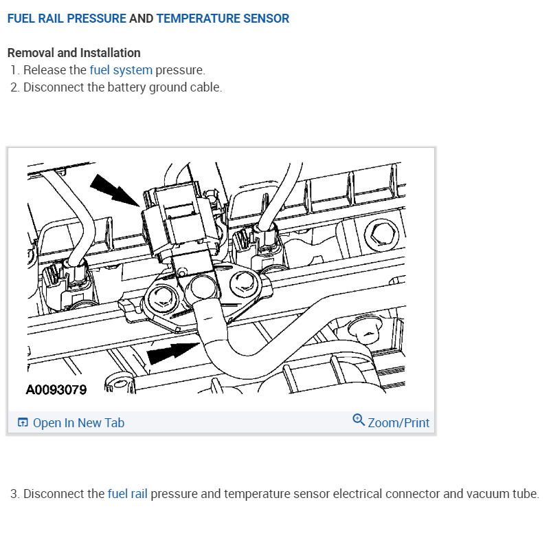

There is no valve so you must interrupt the fuel line and install a gauge here is the location of the fuel pressure sensor which you can change but if you use a scanner it can tell you the fuel pressure here is a guide you will need to use a better scanner than in the guide. To check the pressure the Rotunda Fuel Pressure Test Kit #134-R0087 or equivalent.
Let me know what you find, check the diagrams below.
