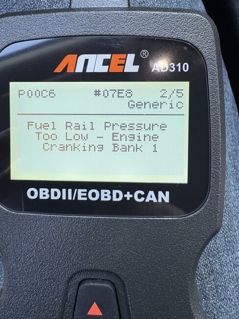

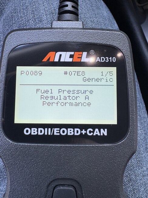

Hi, I believe the error code I’m getting is saying I have a bad fuel rail pressure sensor. Where is it located and how do I replace it? I’m needing some help on this.
Thanks
Jan 28, 2025 at 8:42 AM
DOMINIQUE DUPLESSIS

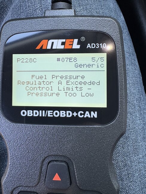

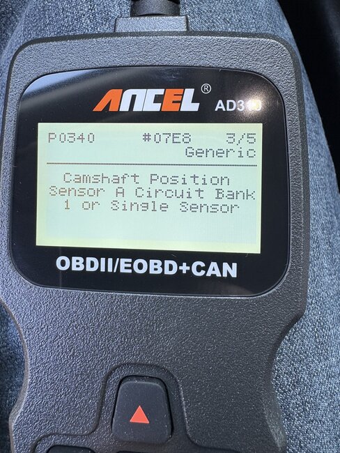

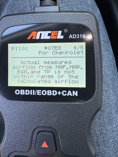

Here are the codes I got from my car.

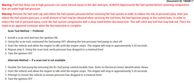

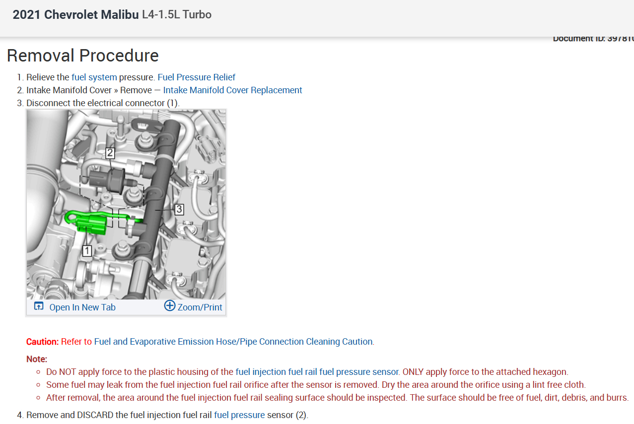

So there are three different problems, please make new posts for the camshaft and air flow issues, please post your new question here, you must be logged in.

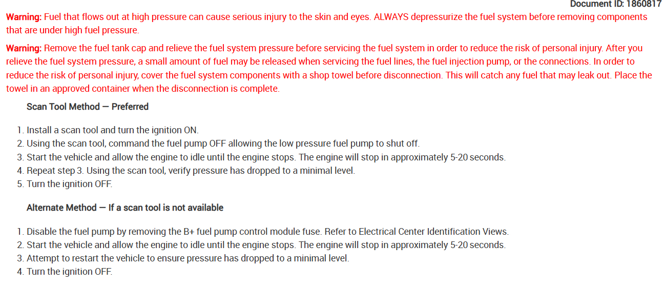

The fuel pressure sensor is a common problem, be aware that there is high pressure fuel involved, here is the location of the sensor and how to change it out. Check out the images (below). Please let us know what happens.
