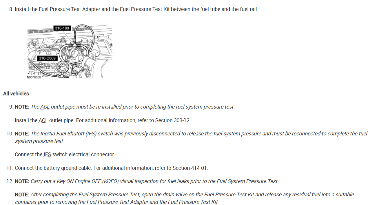

Where is the Fuel pressure sensor located?
2013 FORD EDGE
144,000 MILES • 3.5L • 6 CYL • 2WD • AUTOMATIC
GHASSAN DAHAM

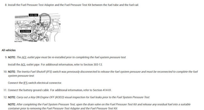

Please, can anyone help me? I need a picture for engine to describe the location of the fuel pressure sensor. And how can I check if the fuel pressure is normal ?
Thanks
Jan 30, 2025 at 5:34 AM
  • 55,224 POSTS

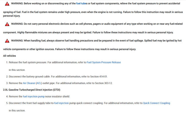

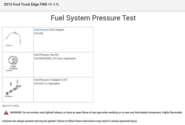

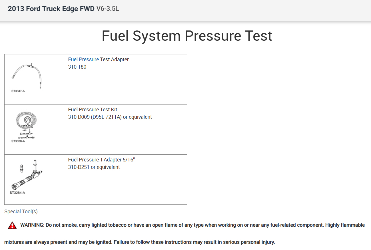

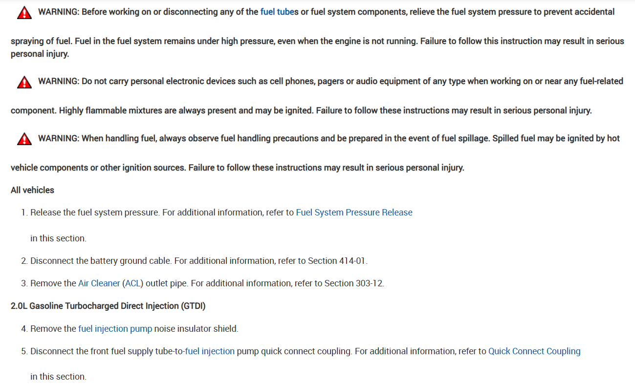

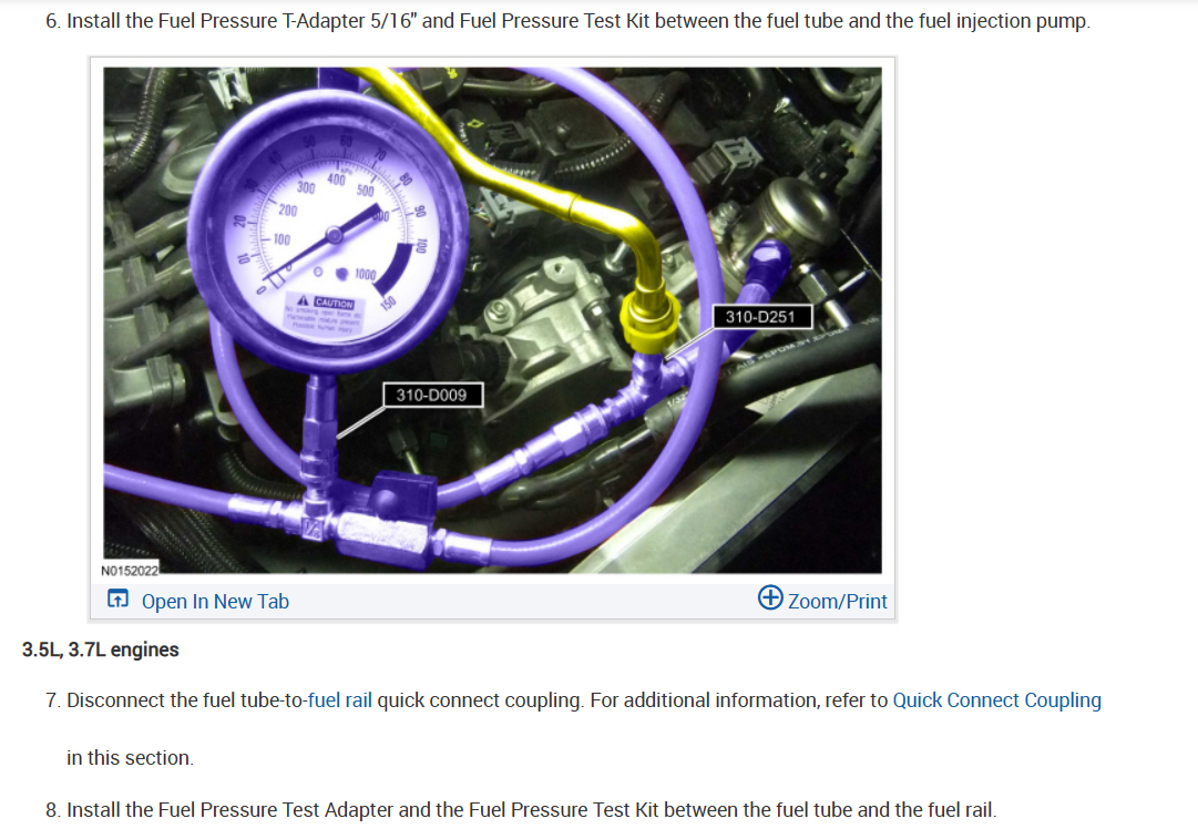

The fuel pressure sensor monitors the system but there is a high failure rate, but your car does not have one, it has a fuel tank pressure sensor is this what you mean? Here is how to check the fuel pressure, you can rent, and gauge set at the auto parts store. Check out the images (below). Let us know how it goes.
