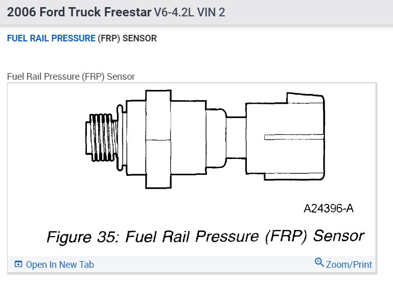

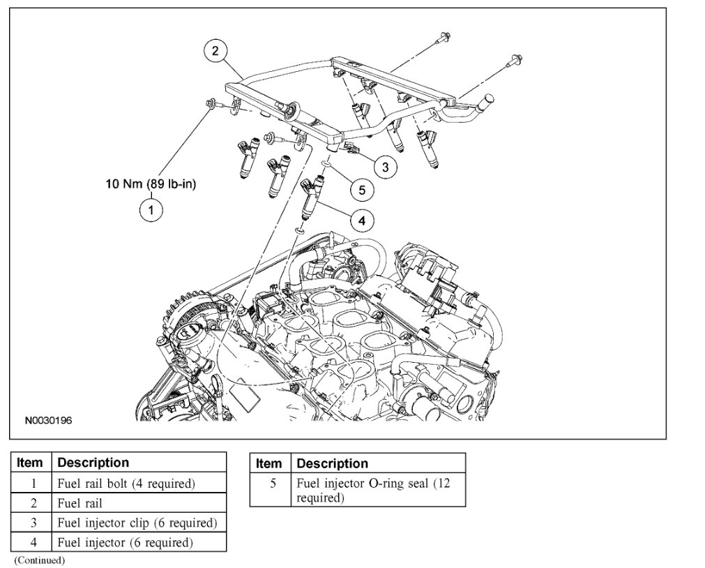

I’m trying to change out the fuel pressure sensor, but I can’t seem to find it on the fuel rail.
Jul 22, 2023 at 1:40 AM
  • 55,423 POSTS

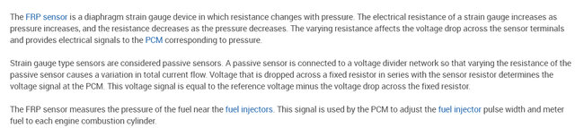

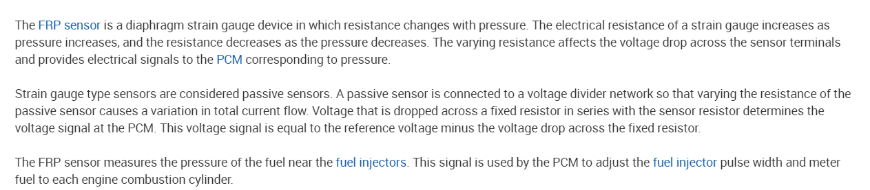

The fuel pressure sensor is on the fuel rail. Check out the images (below). Please let us know if you need anything else to get the problem fixed.
Jul 22, 2023 at 9:06 AM
  • 55,423 POSTS
There semes to be conflicting information on this car, it shows it has a fuel pressure sensor but the engine wiring diagrams do not show one. good luck! :/
