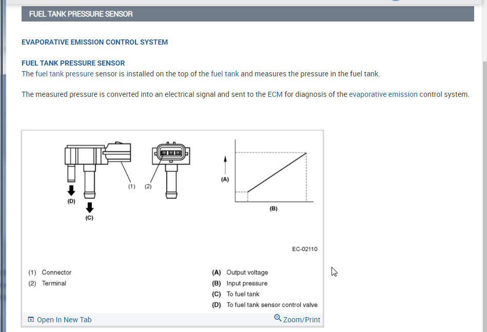

We need help locating the fuel pressure sensor and possibly with changing it out.
Apr 3, 2021 at 3:24 AM

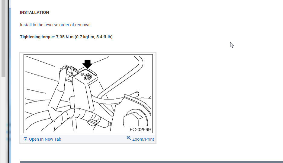

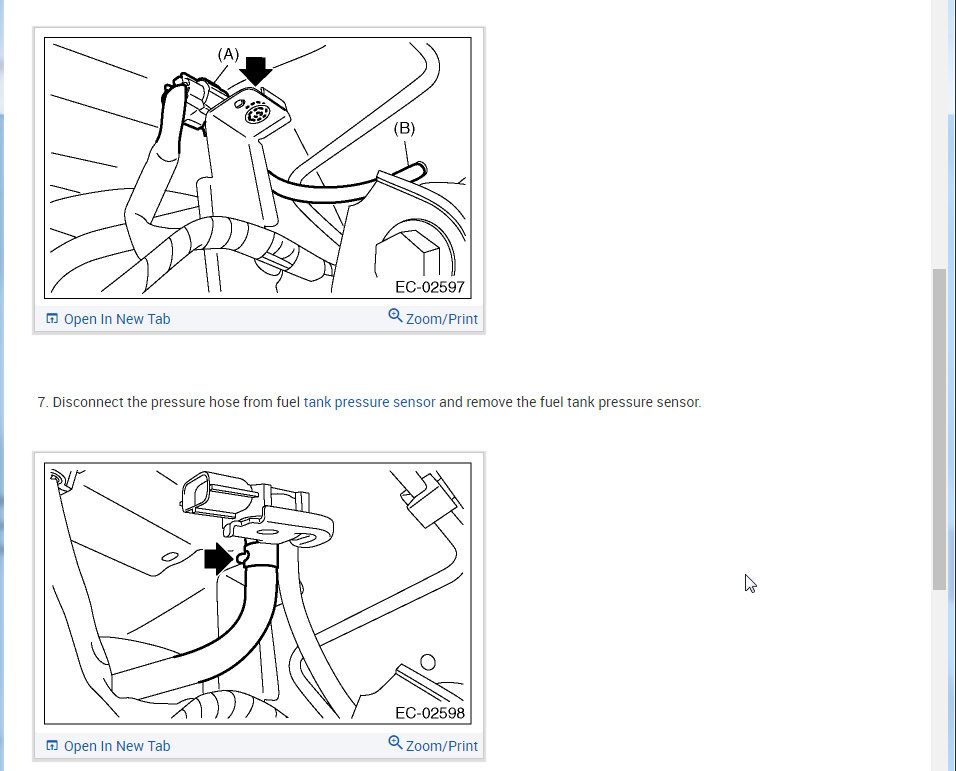

Is there a reason you are looking for this sensor? The reason I ask is you don't have a fuel pressure sensor but you do have a fuel tank pressure sensor.
It doesn't not monitor the fuel pressure but instead monitors the pressure in the tank and will vent the vapor through the emissions system if it gets too high.
I attached the info below on this sensor. Let us know what questions you have or if you have more info that would help with this. Thanks

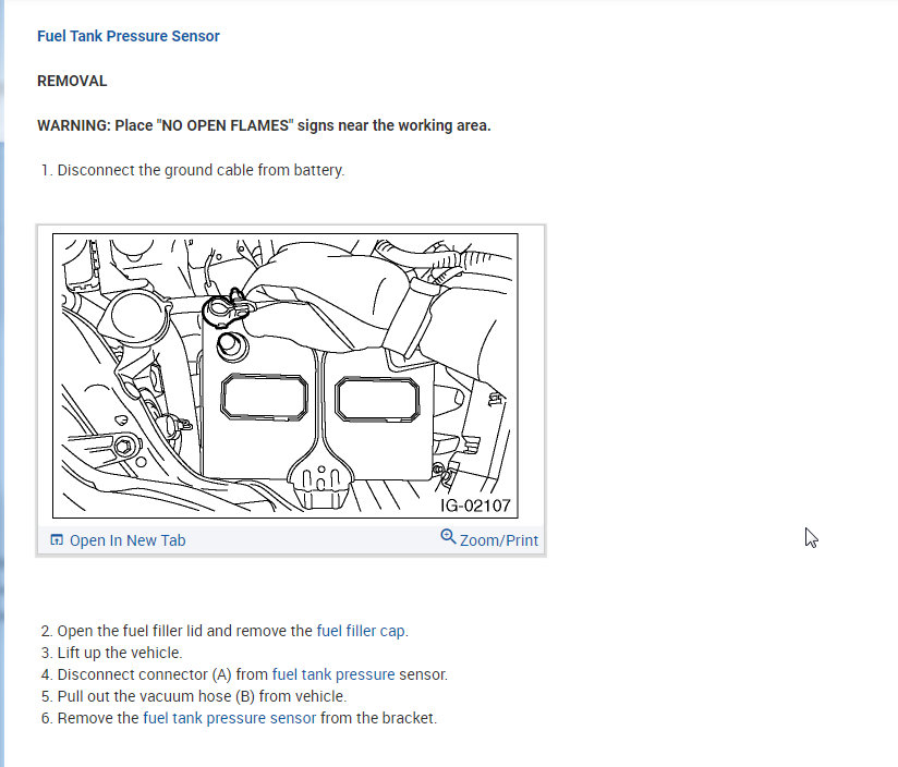

Thank you for your help. My car will occasionally have trouble starting and will shut off when it's idling. The check engine light is on along with traction control, brake light, and the cruise is flashing. We took it in and had it looked at. We were told it needed a new camshaft sensor and fuel tank pressure sensor. We have replaced the camshaft sensor ourselves and are looking to do the same with other sensor.
