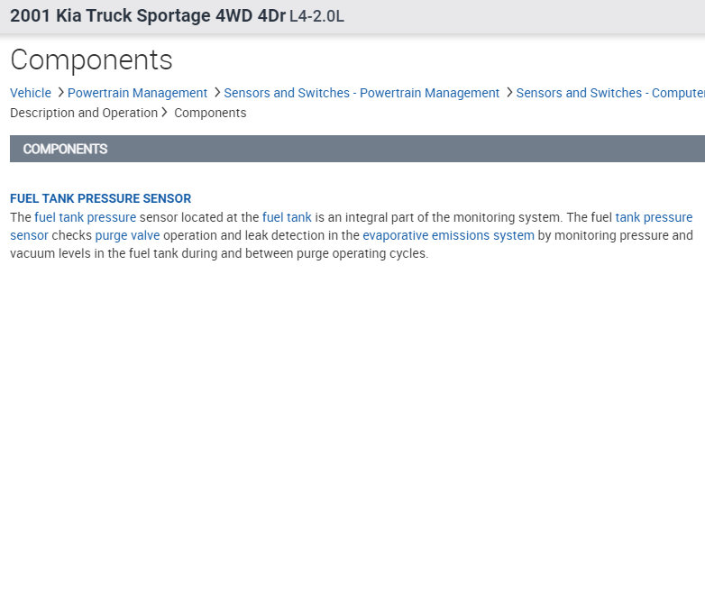

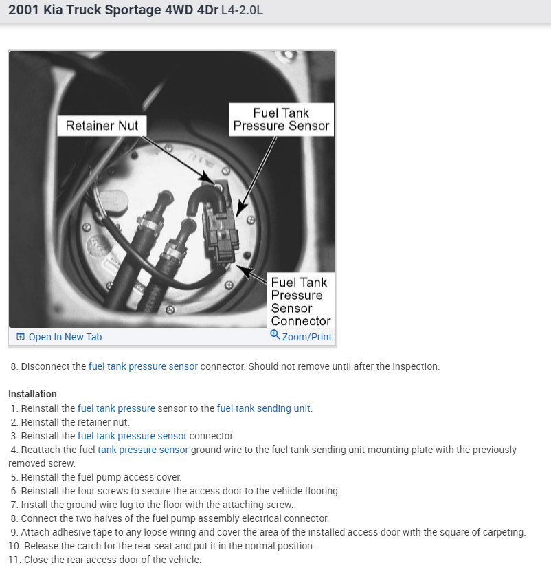

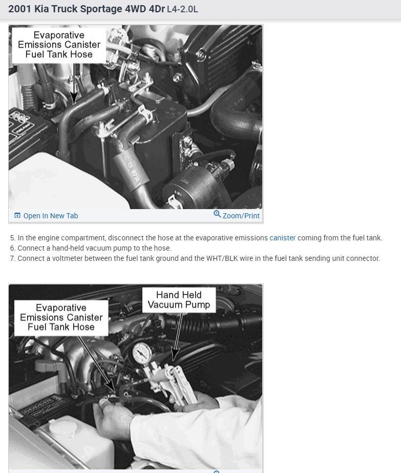

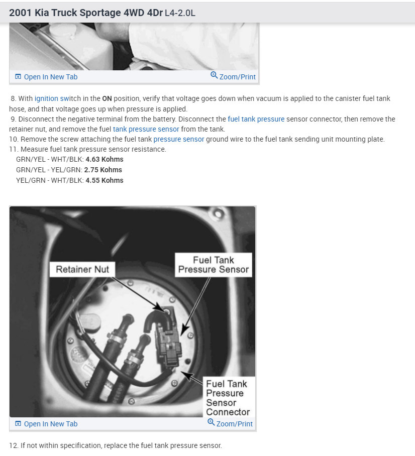

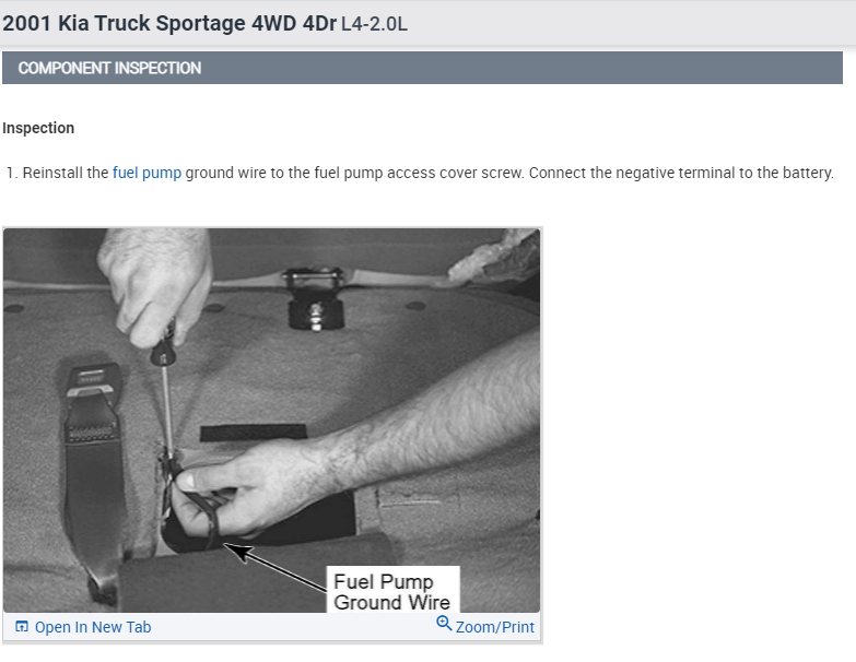

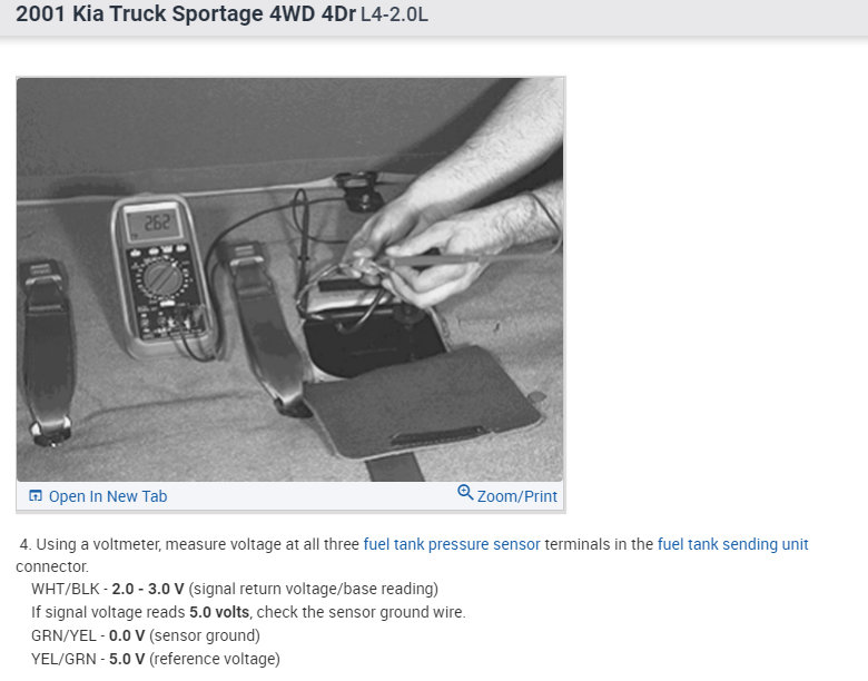

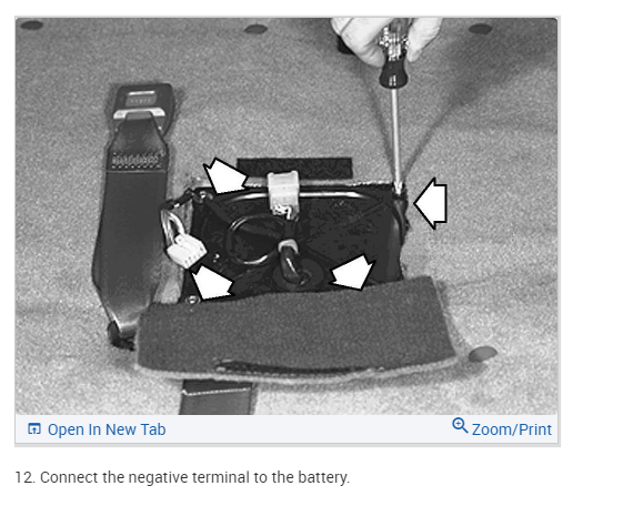

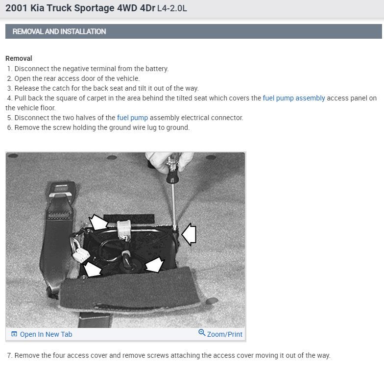

This vehicle has a fuel tank pressure sensor. Which is located on top of the fuel tank, on the fuel pump sending unit.
It can be accessed by lifting rear seat and opening the access panel on the floor.
A faulty pressure sensor can trigger the check engine light due to not providing correct data to the ECM.
What issues are you experiencing? Is your engine light illuminated?
