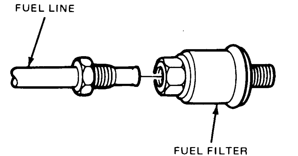

On a carbureted engine, a traditional regulator isn't used. There is a needle and seat in the carb that stops the fuel from entering. Also, the fuel pump also controls the pressure.
If you look below, I attached the steps for testing pressure specific to this vehicle. This is for a 2bbl carb. If the van has a 4bbl, let me know.

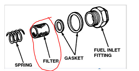

Next, if you are smelling fuel, check the fuel lines between the tank and the pump. Also, check around the carb for evidence of a leak. When checking the steel lines, there could be rusted pin holes that you don't see. However, the line is usually stained. Also, check to make sure the rubber hoses are not dry-rotted. Check the fuel tank as well for evidence.
Let me know what you find. Also, I am basing this vehicle still having a mechanical fuel pump. This is right around the time Ford changed to fuel injection.
See pics below. They used two different fuel filters. Both are at the carb area.

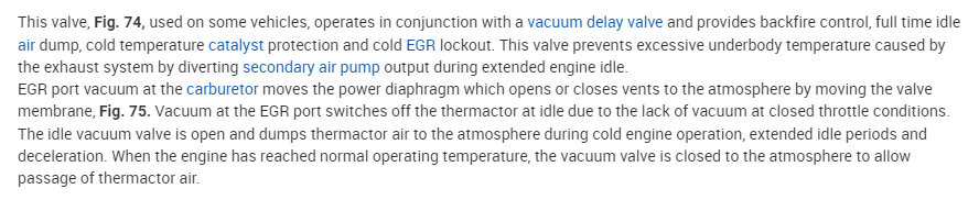

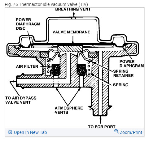

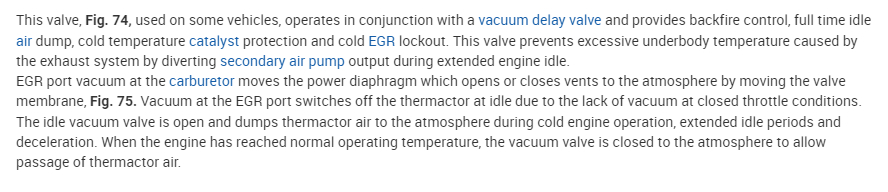

  • 109,885 POSTS

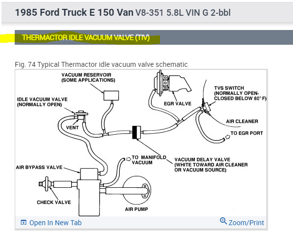

Hi.
I attached the part description and operation below for you. Also, this has to be a carburated vehicle because nothing it indicated in any of my manuals related to fuel injection. Therefore, the fuel pressure is regulated by the fuel pump.
Let me know if this helps.

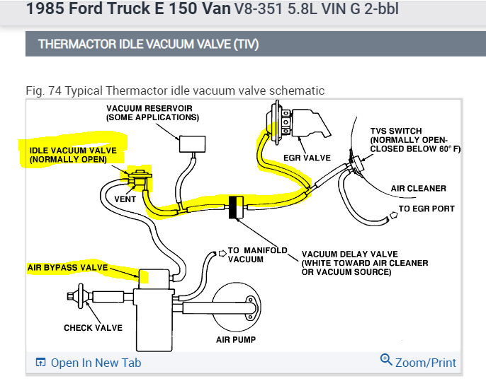

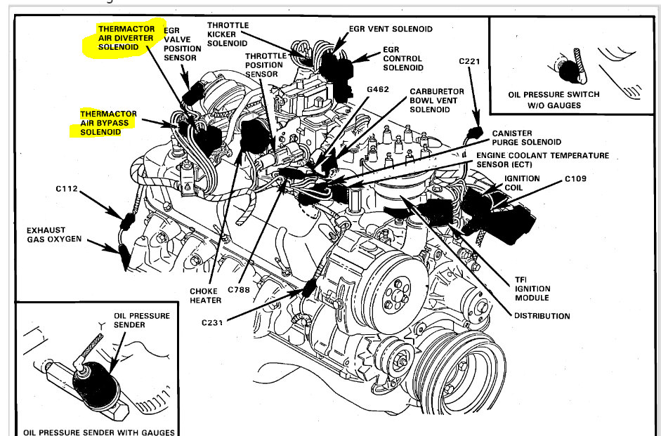

Hello, okay, where is the air bypass system located that your showing me in the diagram?
Tuesday, April 4th, 2023 AT 5:42 PM

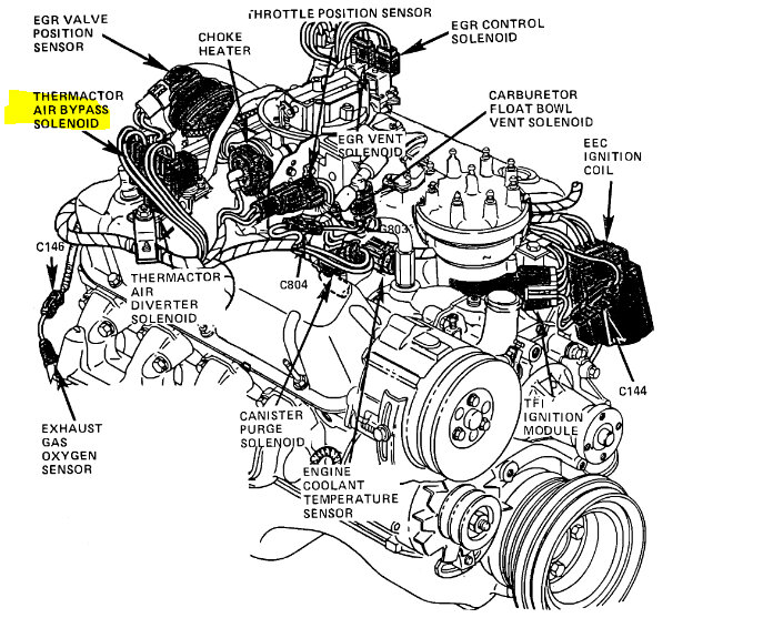

  • 109,885 POSTS
It should be at the rear of the passenger side top of the engine. I attached a pic below. See if it helps you locate it.
See pic below.
Tuesday, April 4th, 2023 AT 7:58 PM

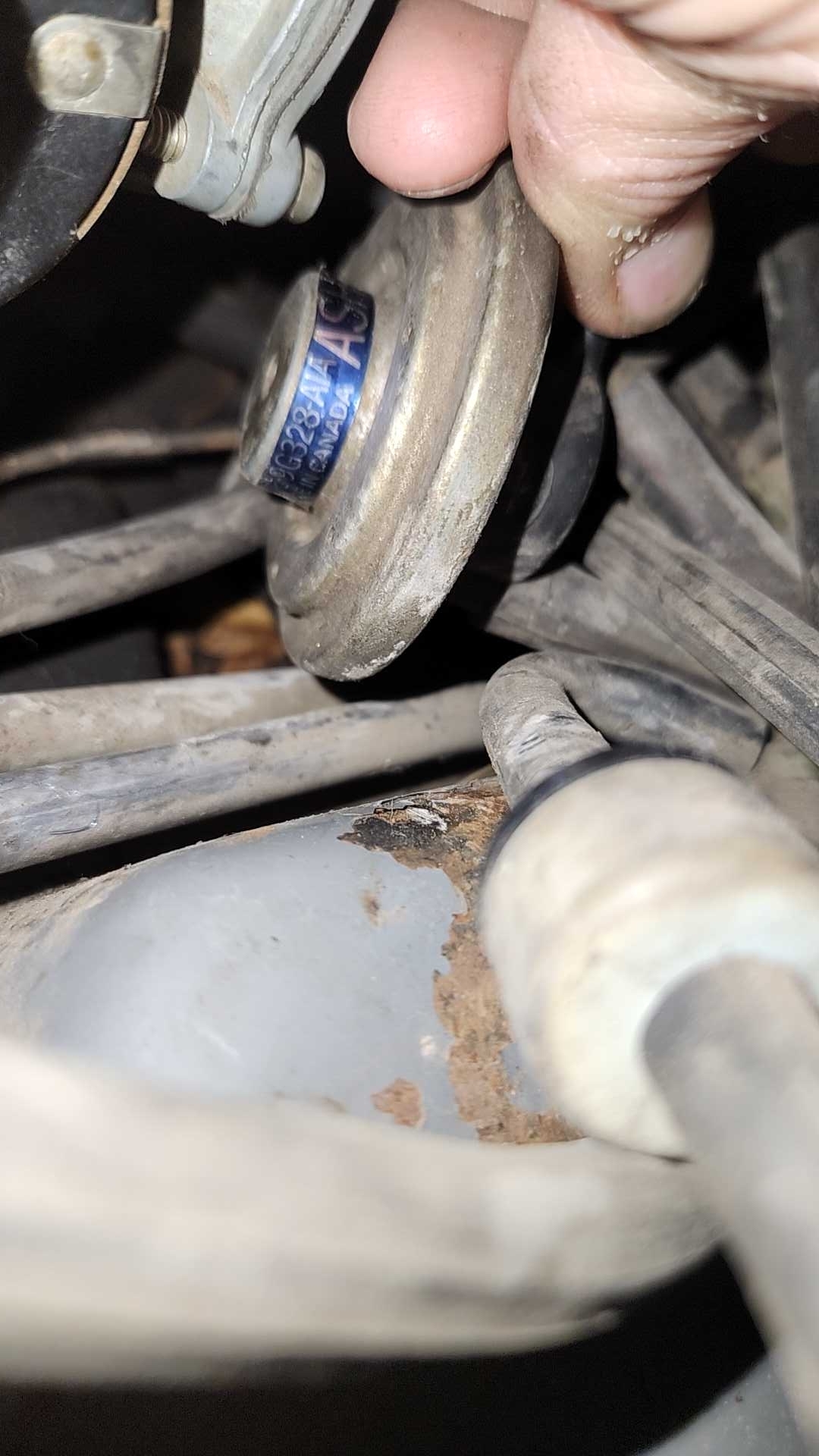

HIPPLESS1
  • 9 POSTS
Joe it's a 2 barrel 1985 Econoline e150 van 5.8l Windsor part 9g328 number I'm trying find out where I have to connect the hoses to and where are the place are located at to connect the one hose that's towards the top of the thermactor idle vacuum valve.
Thursday, April 6th, 2023 AT 4:07 PM
HIPPLESS1
  • 9 POSTS
This is the part I need to connect from wherever.

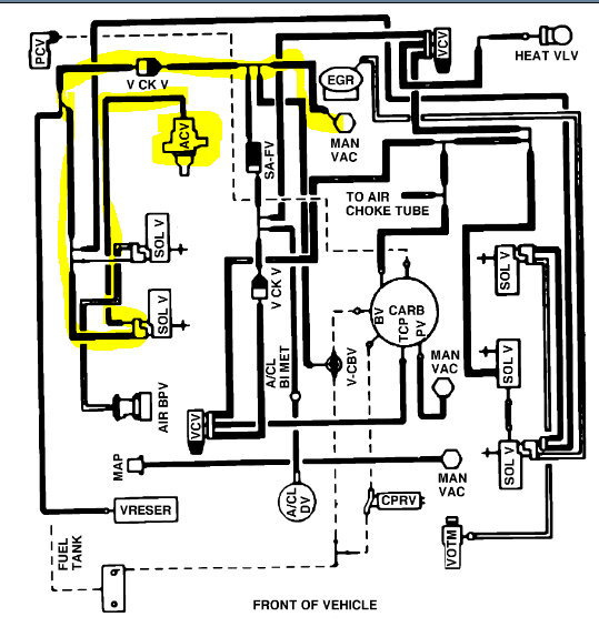

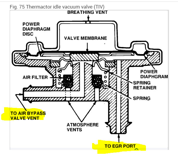

  • 109,885 POSTS
See pics below. That is where the vacuum hoses should run to. The different solenoid valves shown in pic 2 all get vacuum from the main source, the intake. See if either of these pics can help you locate what is needed.
Sorry to be vague. This is an older one that I haven't seen for a long time. All I have are the schematics to figure out where they go.

Hello Joe, those don't show the tiv vacuum valve part number from ford is 9G328 thermactor I need to know where the vacuum hose that's just under the top rim connects to and the hose route to that part it connects to remember 1985 Econoline e150 van with 5.8 Windsor motor 2barrell carburetor. And is there a replacement part for the part number I just gave upu. I'm having a hard time finding the thermactor idle vacuum valve.
Friday, April 7th, 2023 AT 10:33 AM
  • 109,885 POSTS
As far as the part number is concerned, it isn't listed in any of my manuals, so I'm not sure if it has changed.
As far as the valve is concerned, I attached two pics below. This is the only thing I have left. LOL Take a look and let me know if this helps.
Other than these, I would need to be with you to see exactly what you are dealing with. The lack of manual specifics for me is due to the model year. I wish I had a better response.
