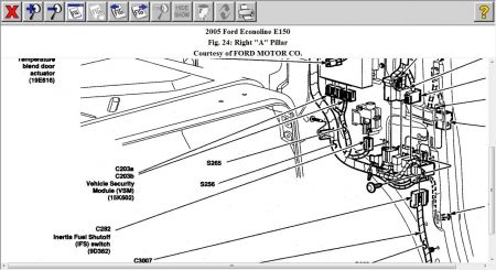

i was wondering where i can find the fuel pump sensor to reset... hit a vrick wall while parking, no signficant damage other than a bent bumper, mostly on the passenger side... then van didnt turn on... it feels like its almost there but cant never get the full crank.. thought its make the sensor since most cut off after a pretty good hit

Inertia Fuel Shutoff (IFS) Switch (Except Stripped Chassis)At right kick panel. See Fig. 24. Inertia Fuel Shutoff (IFS) Switch (Stripped Chassis)Behind left side of dash. See Fig. 22 FIG24
https://images.2carpros.com/forum/automotive_pictures/12900_f24_1.jpg
FIG22
https://images.2carpros.com/forum/automotive_pictures/12900_f22_1.jpg
