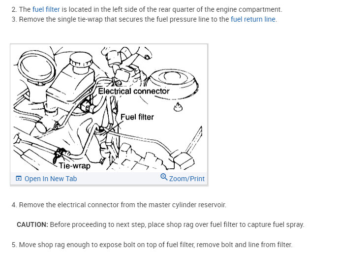

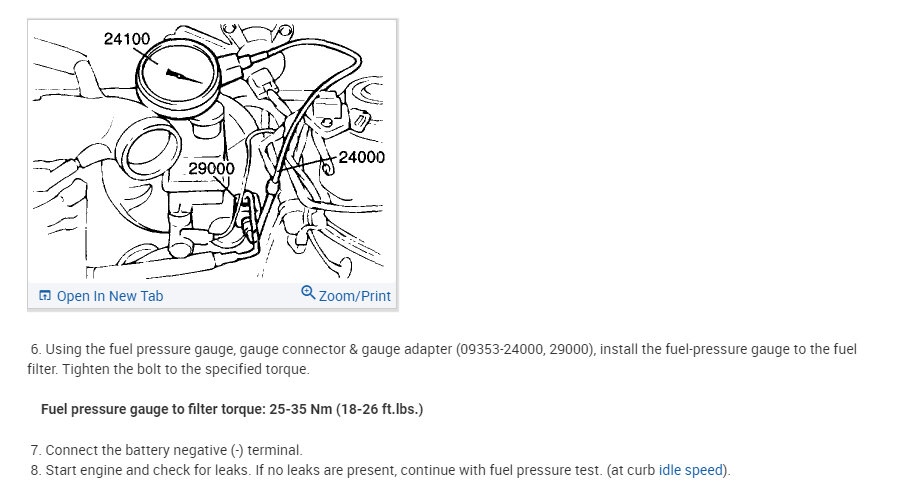

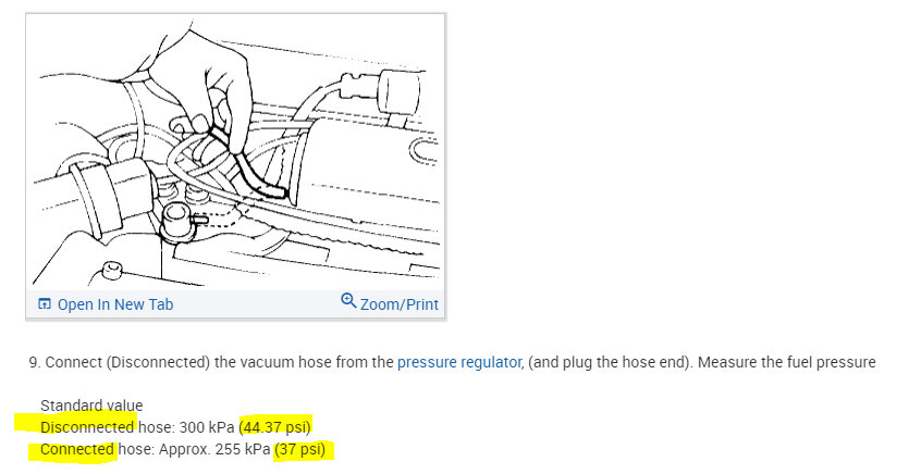

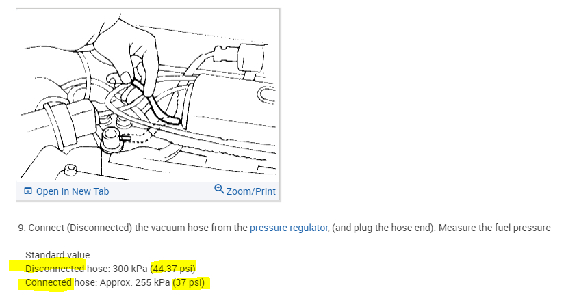

Replaced Fuel pump and don't know which fuse is or relay for fuel system and what PSI should be? I just got the fuel pressure kit to test it.
Oct 15, 2023 at 5:05 PM
  • 110,194 POSTS

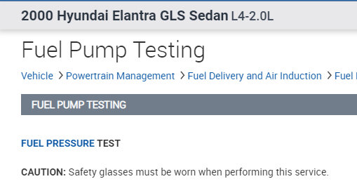

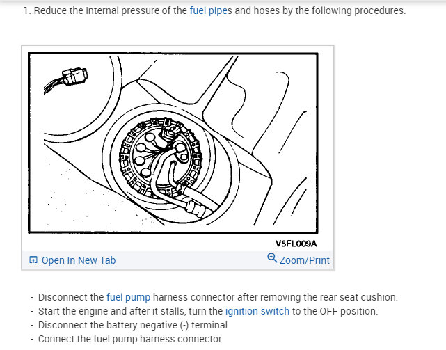

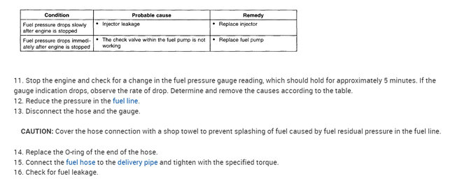

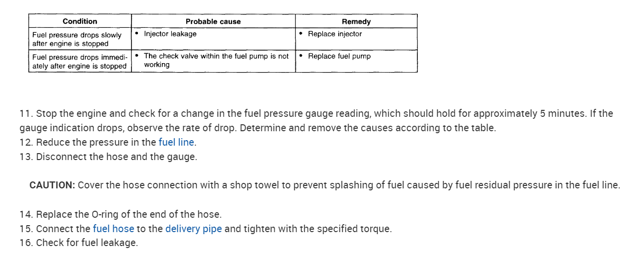

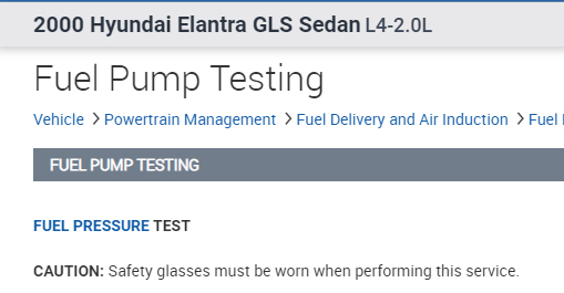

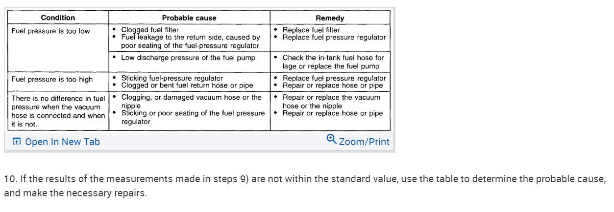

No problem whatsoever. To get you started, here is a link that explains in general how to test both fuel pressure and the fuel pressure regulator:
If you look below, I attached the manufacturer's testing instructions which include diagnostics at the end. Take a look through them and let me know if they help.
Let me know what you find or if you have questions.
