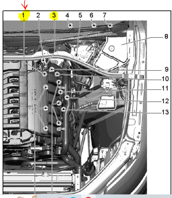

Code p2294, where is the fuel pressure regulator 2 located?
116,000 MILES • 3.6L • V6 • 4WD • AUTOMATIC
KIMOOOOOZ
  • 17 POSTS

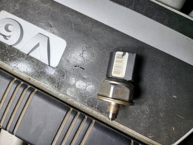

My OBD Show there are P2294 code in my car.
Which is the fuel pressure regulator 2.
I changed the one under the back seat. And i still have same code and same issue.
So, i don't know where is the fuel pressure regulator 2 located in this car.
Oct 12, 2023 at 6:23 AM
  • 110,251 POSTS

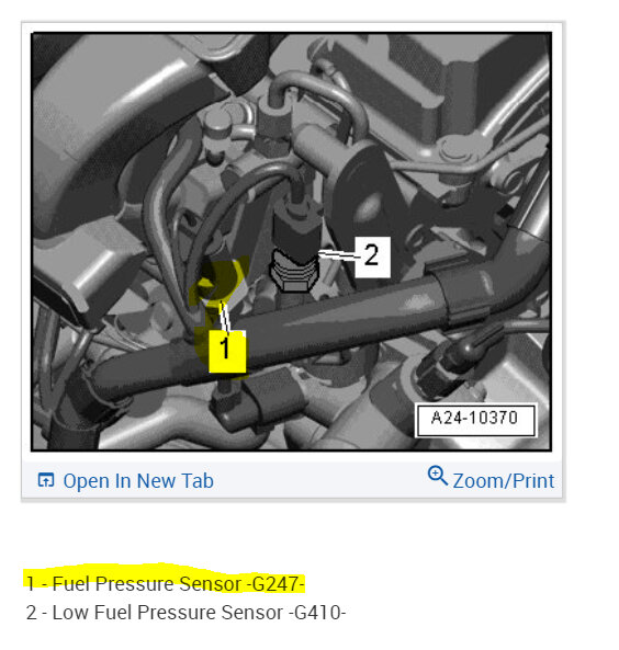

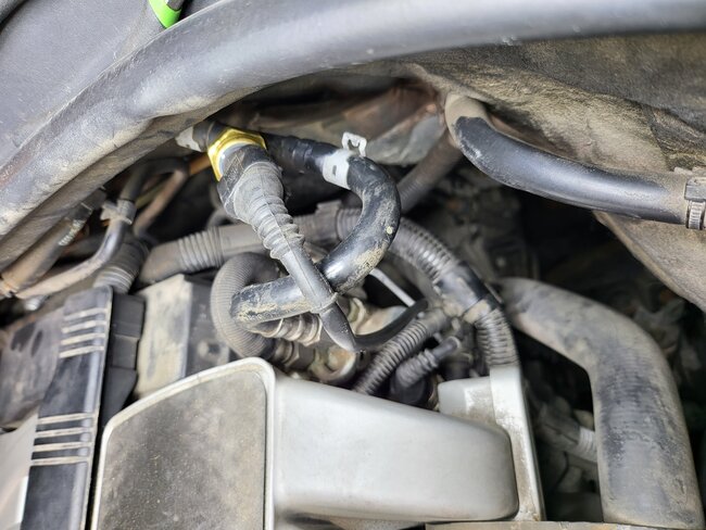

Based on the code, the sensor is located at the rear of the engine compartment on the left side. Is that what was replaced?

KIMOOOOOZ
  • 17 POSTS
Thank you for your fast reply.
But the one you showed me is the sensor (fuel rail pressure sensor) so this is not the fuel pressure regulator 2.
Oct 12, 2023 at 10:50 AM

I sent you a picture of my engine to show how it looks.

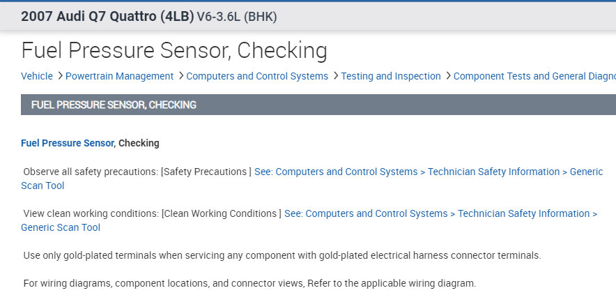

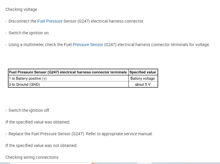

  • 110,251 POSTS

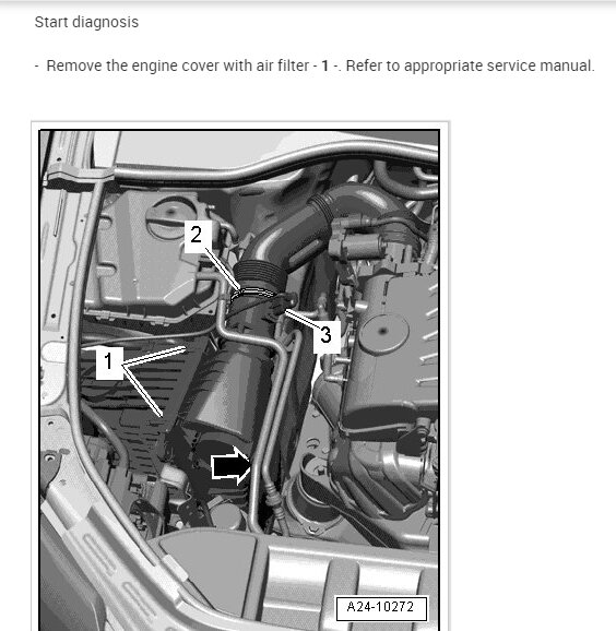

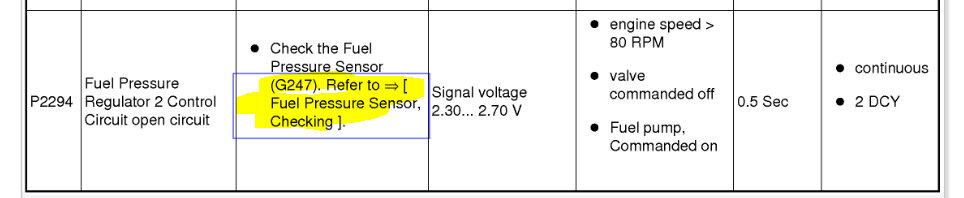

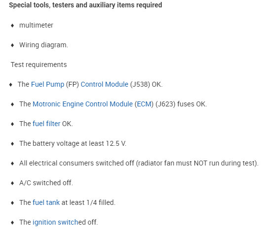

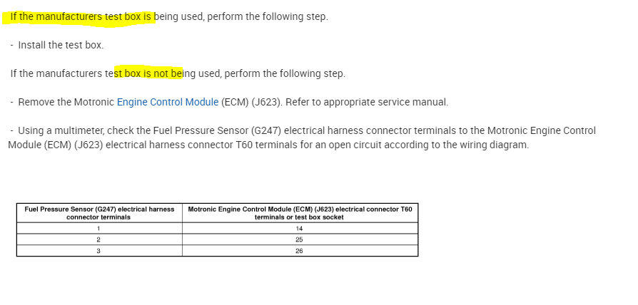

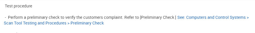

The sensor electronically regulates the pressure. I attached the diagnostics below specific to the code you have. It walks me straight to the sensor I mentioned. I believe the one you replaced is for the low-pressure fuel pump.
Oct 12, 2023 at 1:47 PM

Were you able to perform the diagnostics I attached above for the specific code? I ask because I know what you purchased is expensive. I don't want that replaced only to have the same problem.

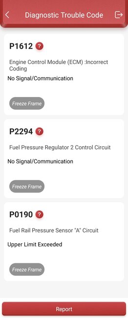

KIMOOOOOZ
  • 17 POSTS
To be honest i didn't, but i can do that tomorrow.

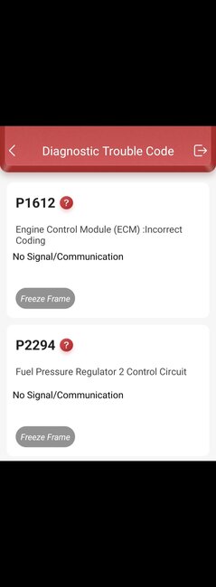

I want to let you know that i have P1612 code do you think this code is connected with the p2294 code?
Oct 19, 2023 at 4:20 PM
  • 110,251 POSTS
The P1612 is related to a coding error within the ECM. Have you done anything to it? Also, here is an interesting point. The code isn't relevant for this model year.
Certainly, if the ECM isn't able to communicate, it will cause all kinds of issues.
Oct 20, 2023 at 7:26 AM

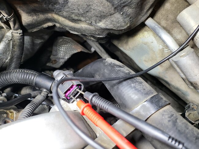

KIMOOOOOZ
  • 17 POSTS

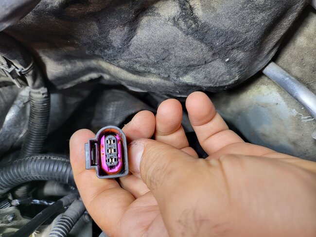

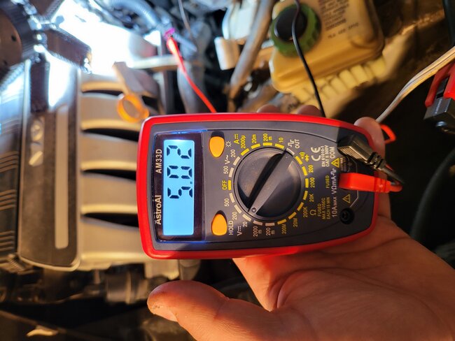

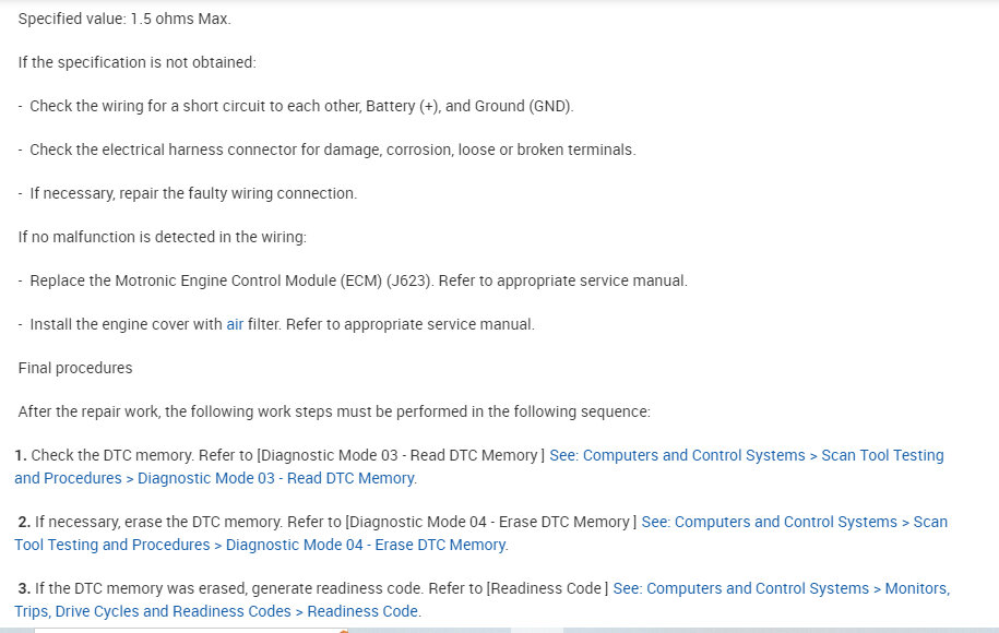

I did the test. It's the (G247) wiring and its shows that its connected.
Oct 22, 2023 at 6:06 AM
KIMOOOOOZ
  • 17 POSTS
I disconnected the sensor and i scan the car again its show me this code.
Oct 22, 2023 at 6:10 AM
  • 110,251 POSTS
Based on this information, I suspect the ECM either needs coded or replaced. Is that something you have the software to do? It will require vag-com software.
