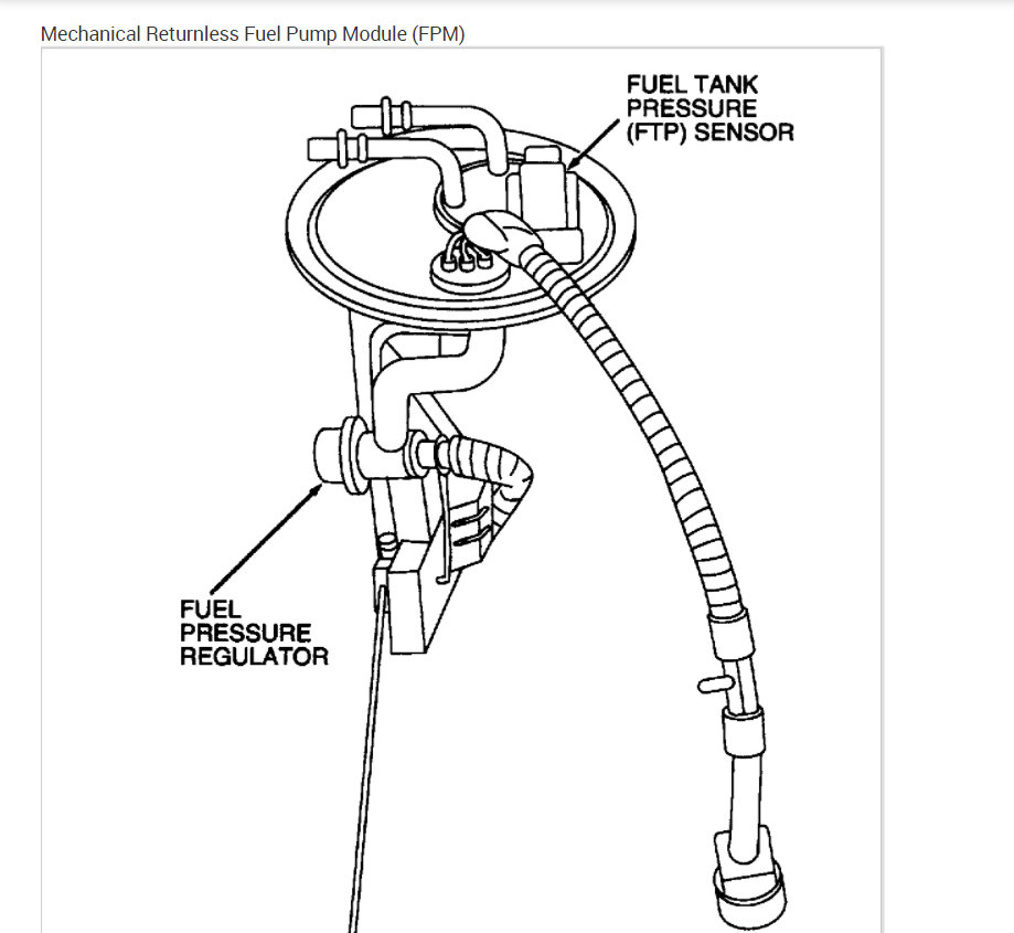

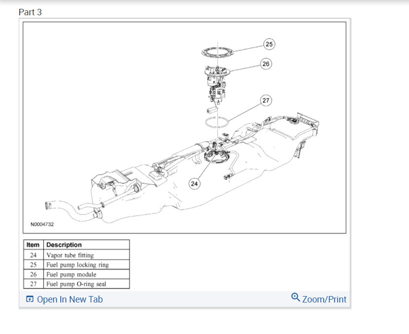

Good morning,

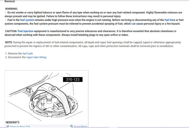

The regulator is in the pump itself in the fuel tank.
The tank needs to be dropped in order to access the pump. The entire fuel pump module will need to be replaced.
https://www.2carpros.com/articles/how-to-replace-an-electric-fuel-pump

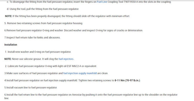

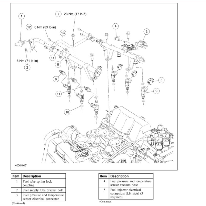

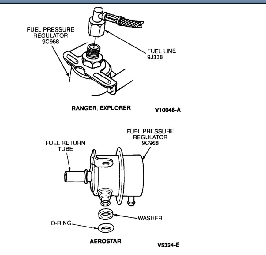

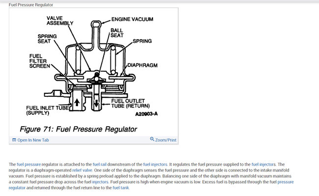

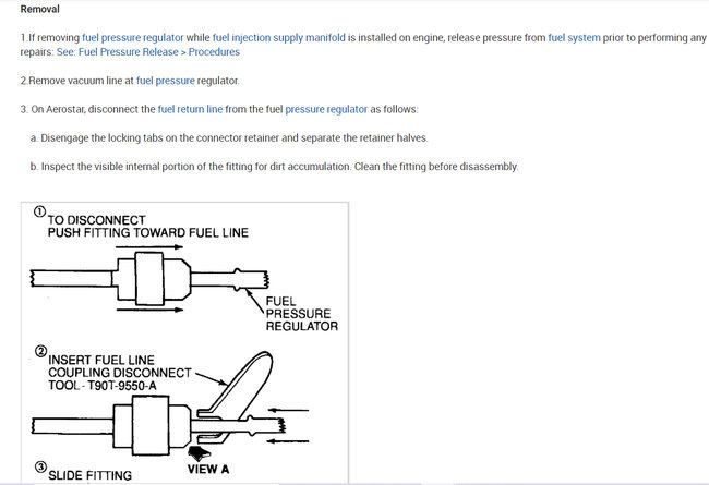

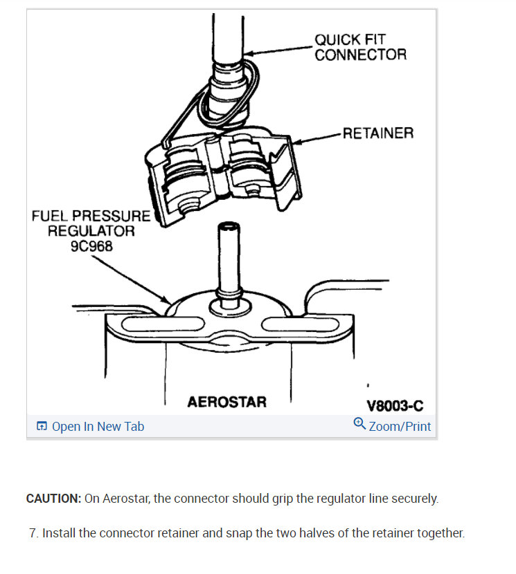

Thanks for the answer that I'm looking for. However, I do have the same question for a 1995-96 Ford Explorer engine. The previous owner dropped it in the 2005 rolling chassis and body but I don't know where 95-96 fuel pressure regulator is located. Any ideas on where it is?? Please include the diagram. It is useful to me.
Jun 28, 2021 at 12:30 PM
I attached the procedure for this and some pictures below for you to review.
It is located on the fuel rail for the injectors.
