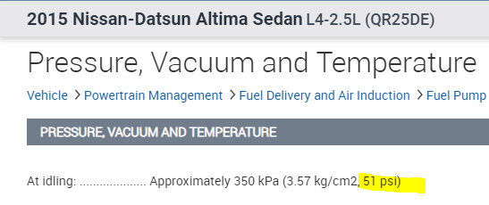

Crank but won't start. Will start with starter fluid being sprayed towards the carburetor but then shuts off immediately afterwards.
Oct 31, 2023 at 10:08 AM
  • 110,244 POSTS
Either we have a fuel pump issue, or the fuel injectors are not getting power. I need you to check the fuel pump pressure. You will need a fuel pressure gauge, but most parts stores will lend one to you.
Here is a link that explains how to test pressure:
If you look below, I attached the manufacturer's fuel pressure specifications for this vehicle. We need to know if the pump is working properly before we move on to the next possibility.
Let me know if this is something you are comfortable performing.
See pic below.
