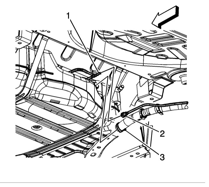

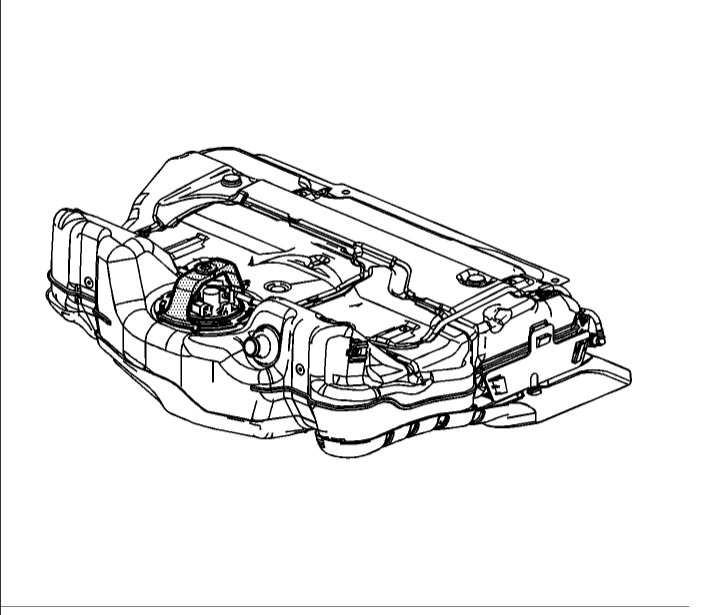

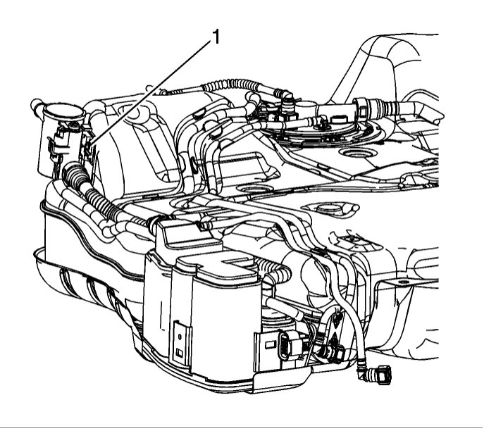

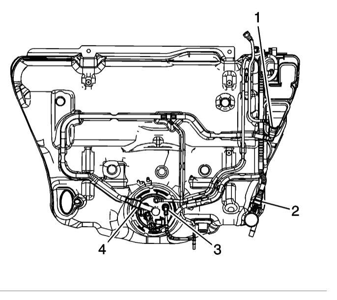

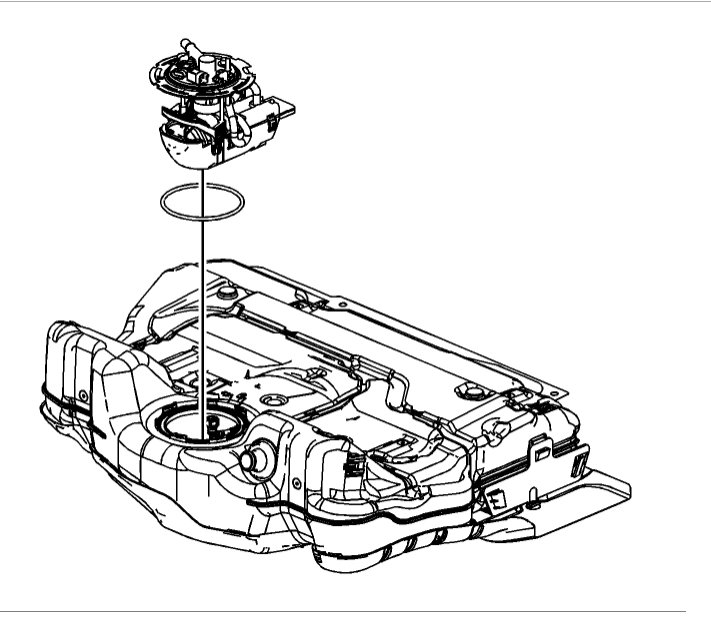

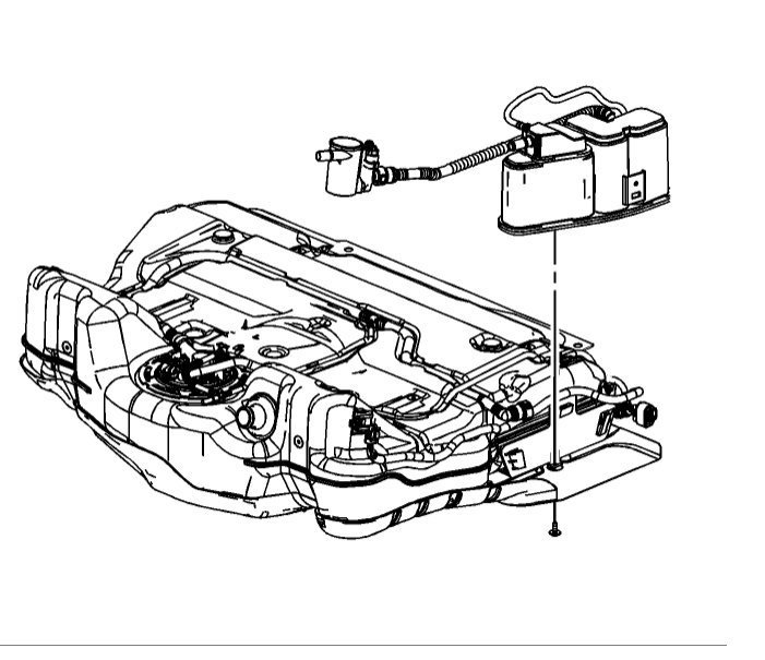

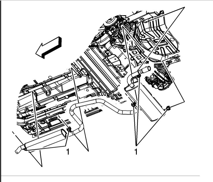

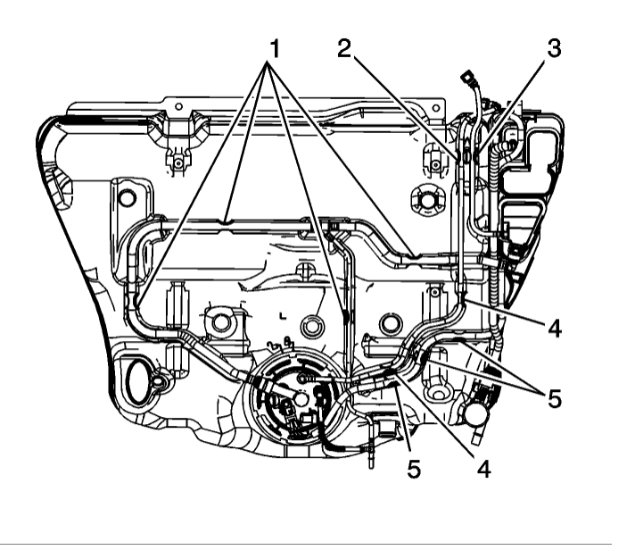

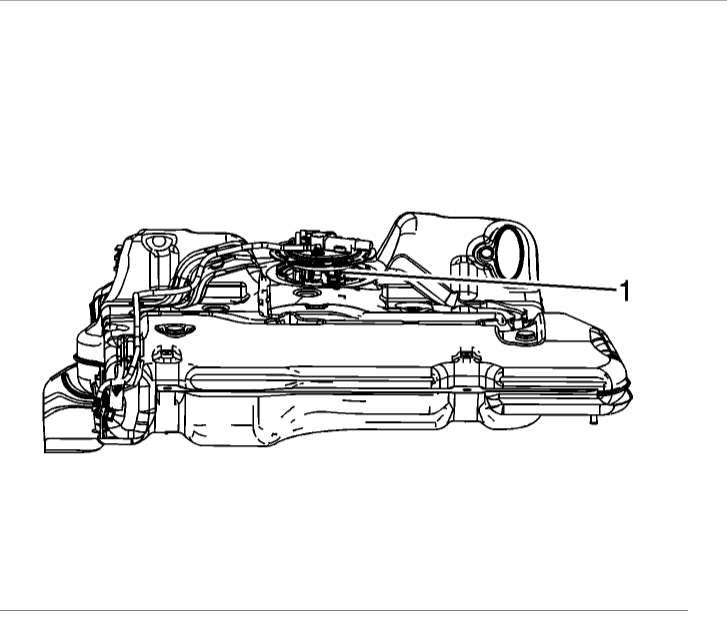

I need to empty my gas tank and I was told to do it from the fuel pressure regulator and hot wire the pump to run constantly and pump all the gas out. But, I do not know where it is located.
Jul 29, 2017 at 3:17 PM
  • 55,065 POSTS

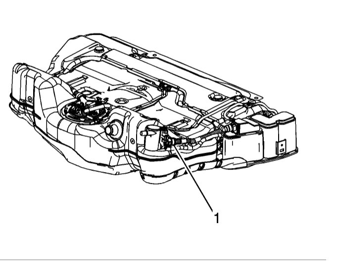

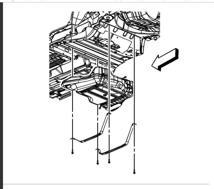

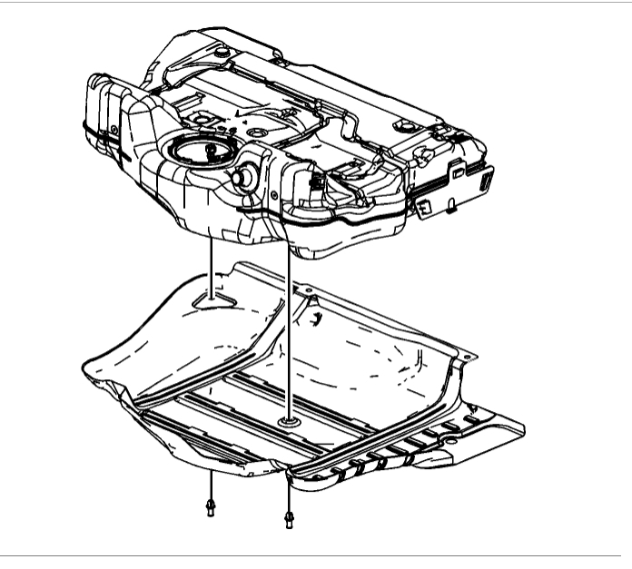

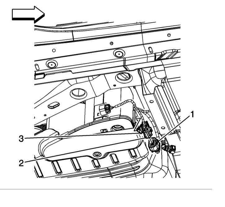

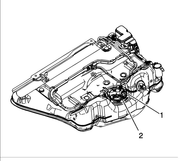

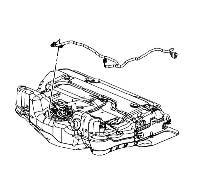

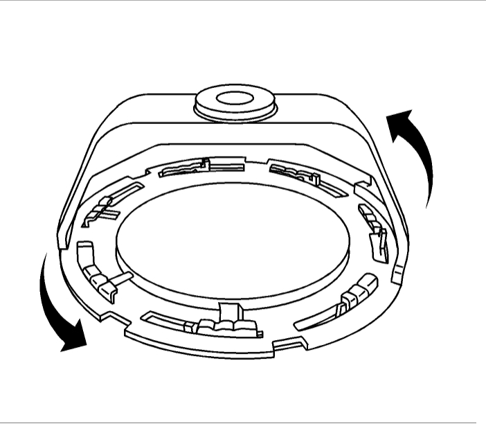

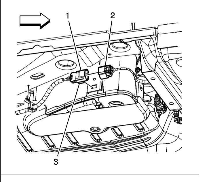

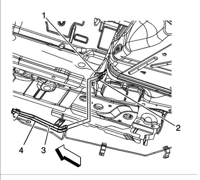

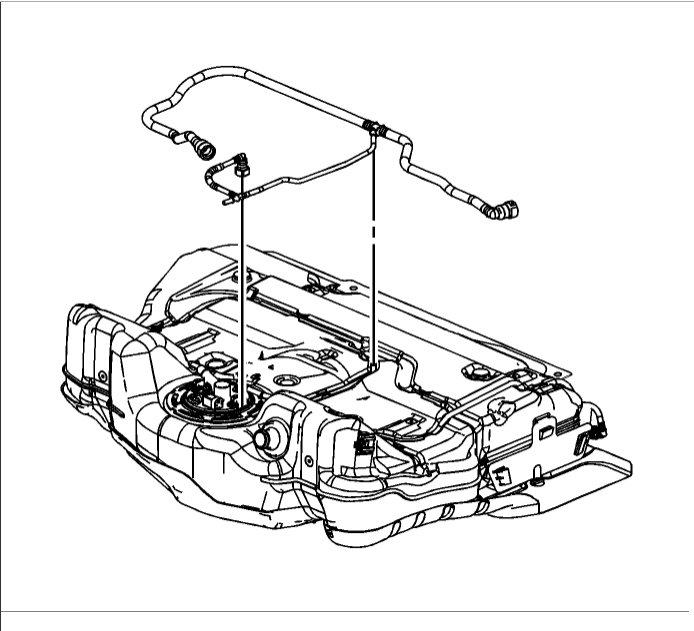

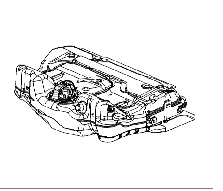

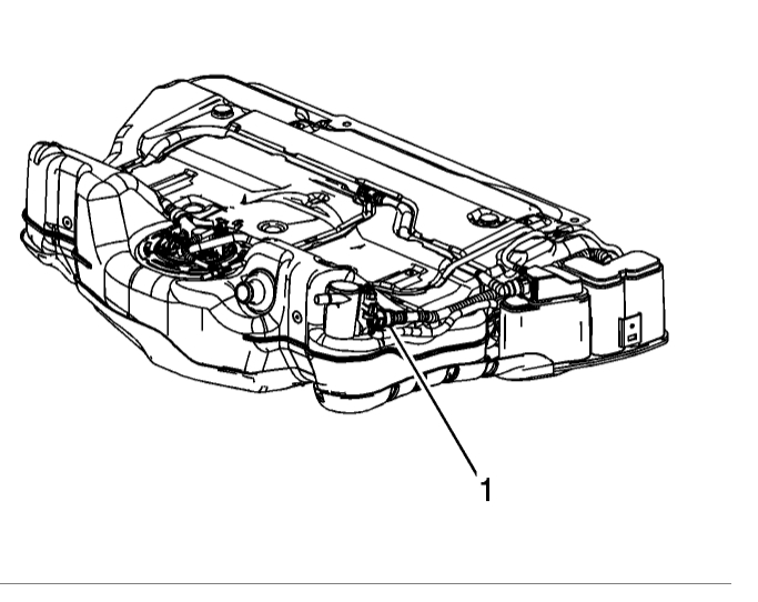

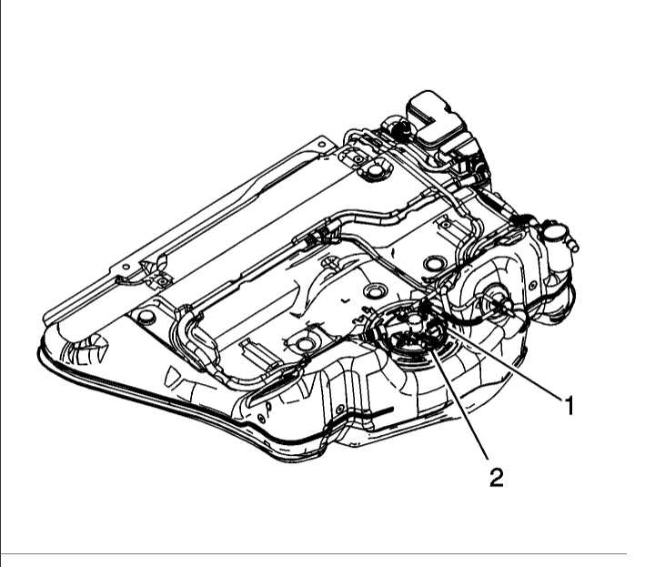

Your car does not have an external relay or a fuel filter. Here is a video to how to drain your fuel that will work must better.
You will need to jack the car up.
and
https://youtu.be/Q5MH2gnyFH0
Here are is a guide on how to drop the tank:
https://www.2carpros.com/articles/how-to-replace-an-electric-fuel-pump
Below is some diagrams to help you on your car.
