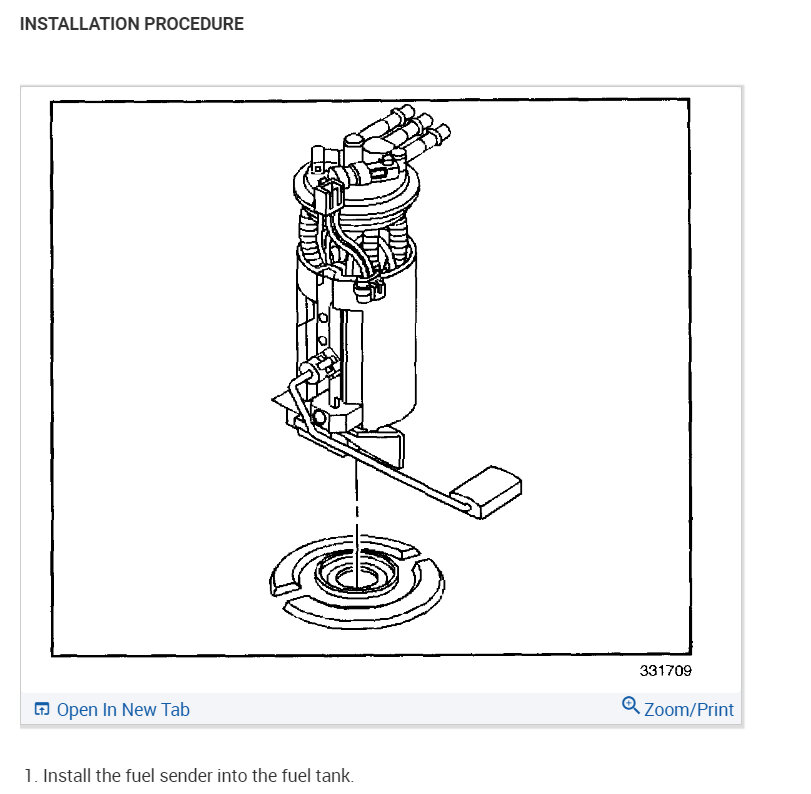

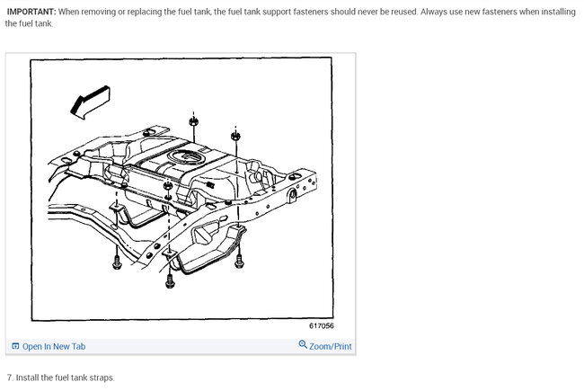

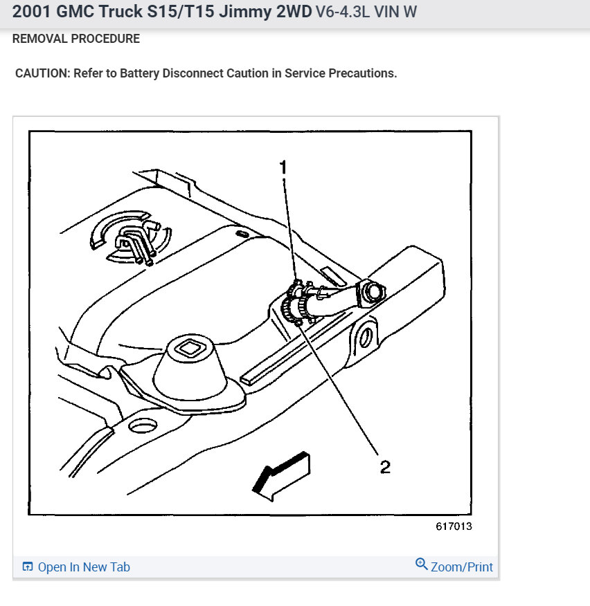

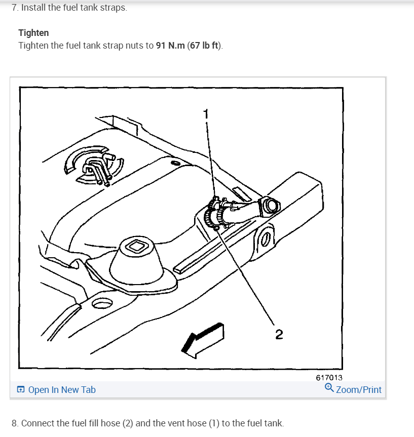

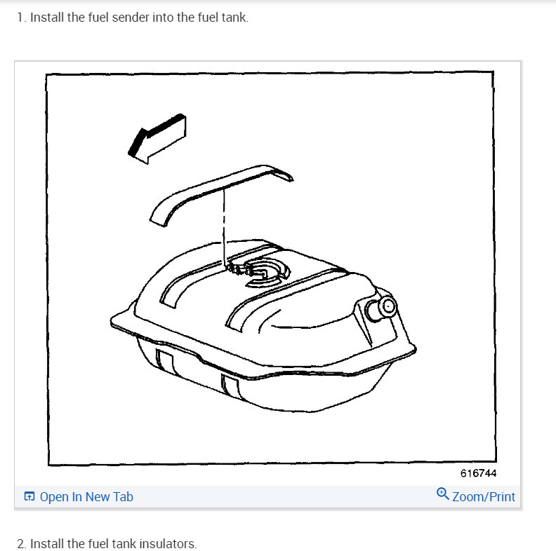

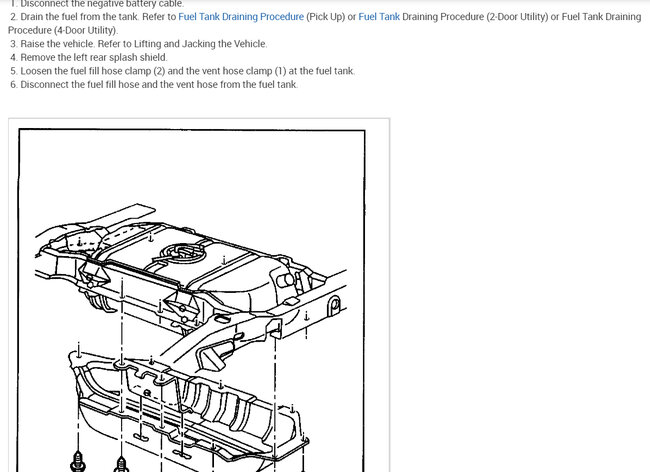

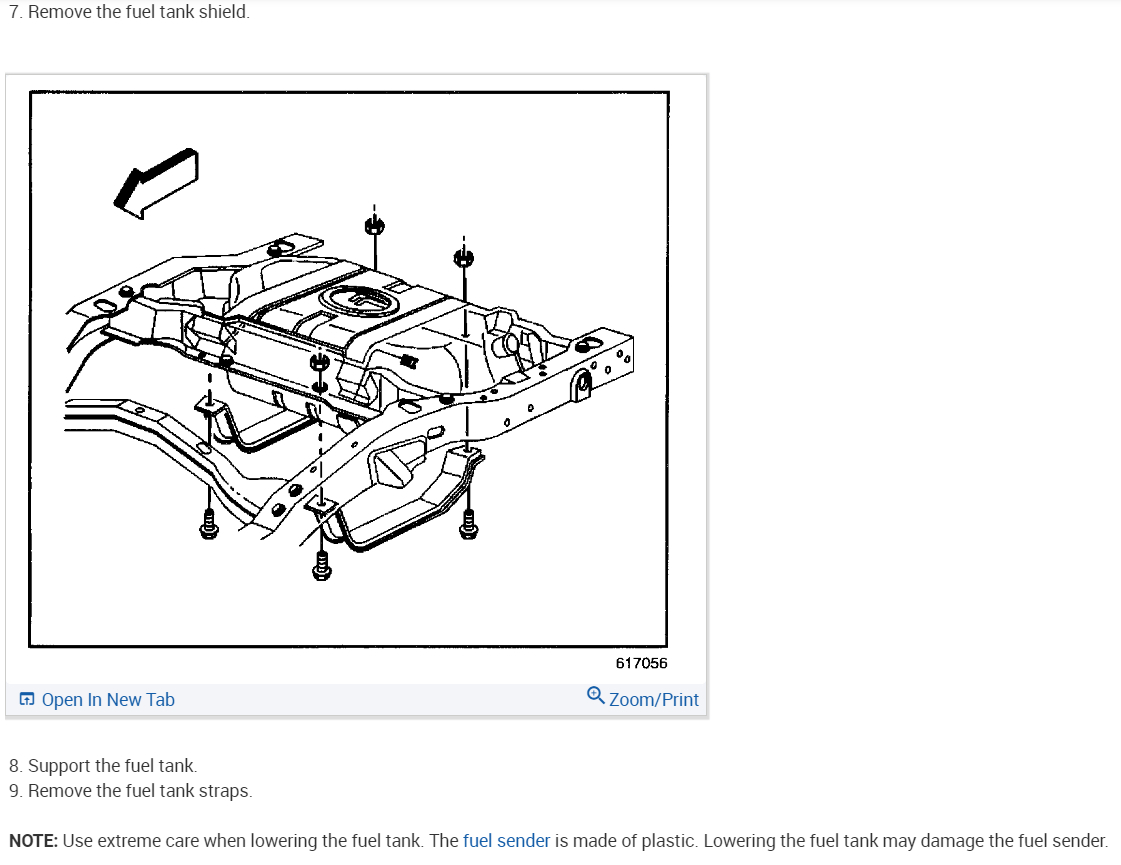

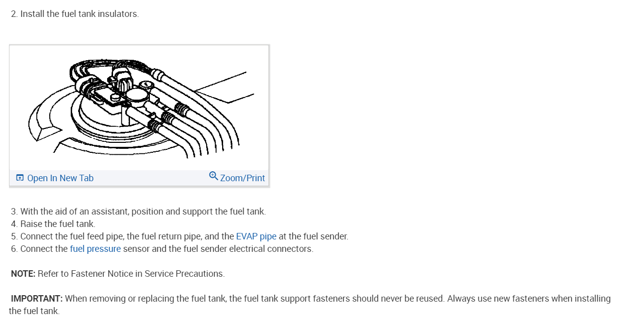

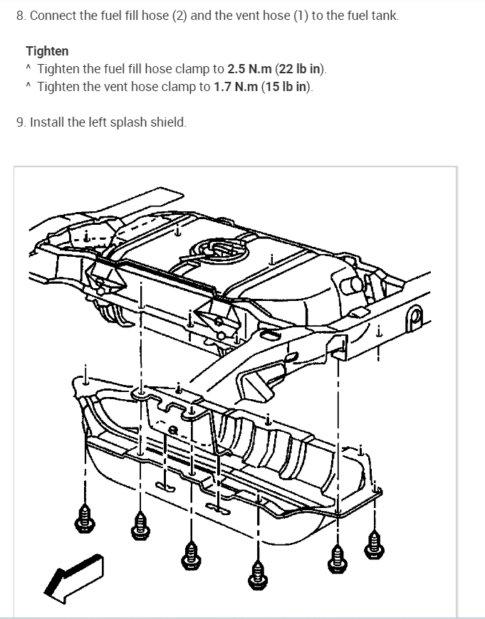

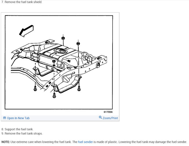

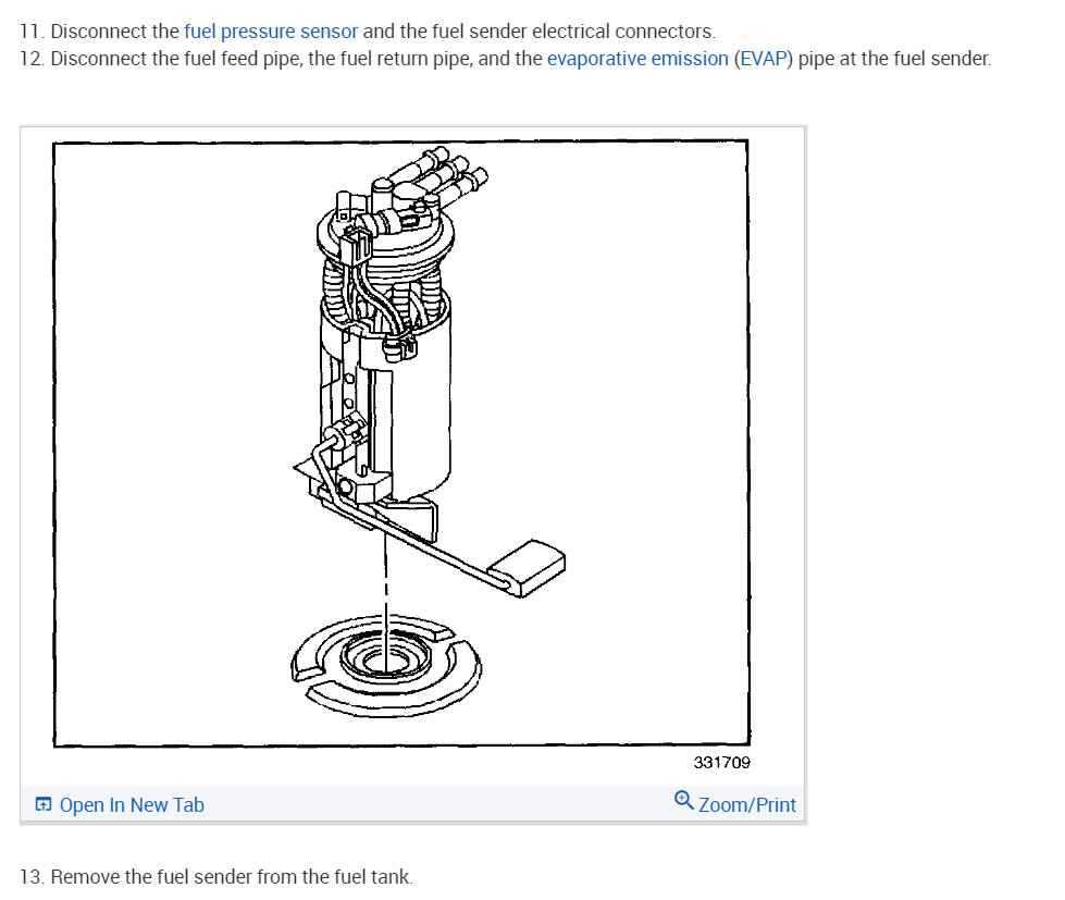

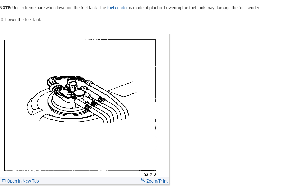

It looks like you found the problem, here is the fuel pressure stats:
Key On Engine Off .................... 60-66 psi
Here is how to change the fuel pump out. Check out the images (below). Please let us know what happens.
