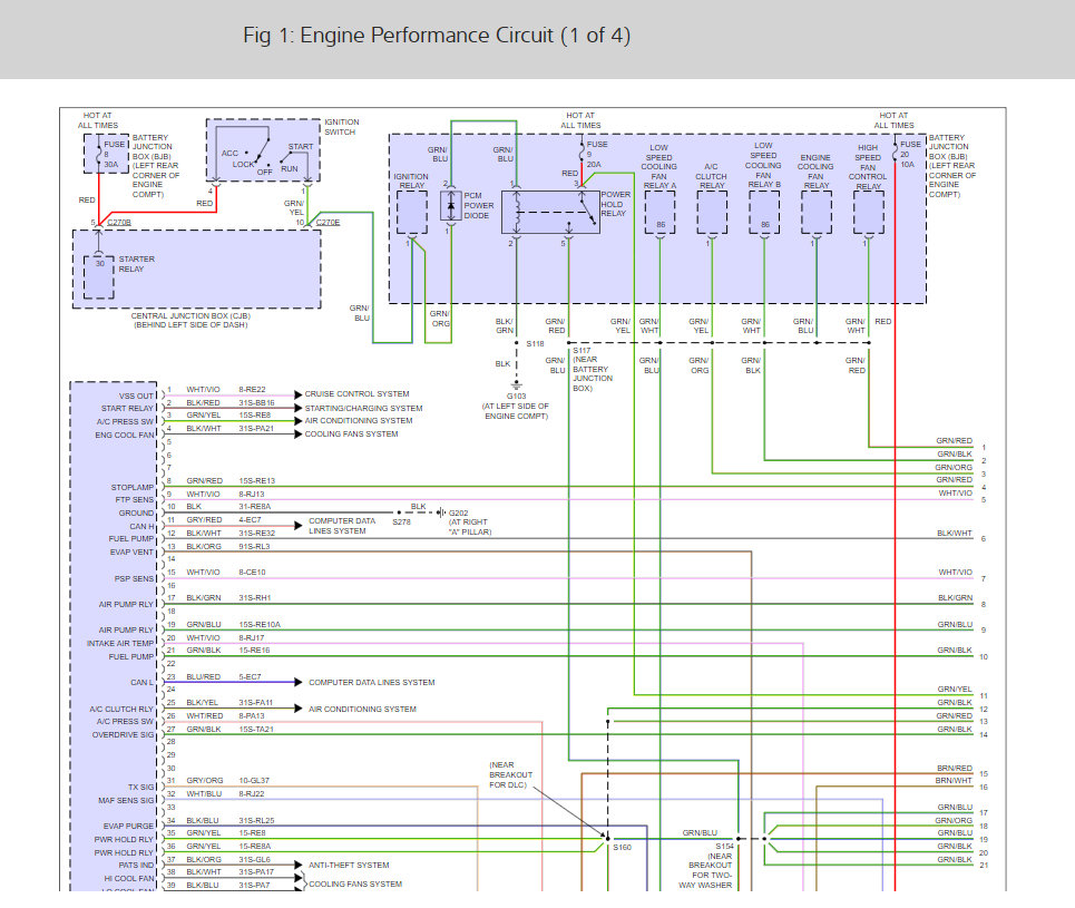

OBDII codes P0190 and P0191. Scanner shows 10 lbs of fuel pressure. Changed FRP sensor and fuel filter. Here's the weird thing: starts fine with 40-45 lbs of pressure according to the scanner. Warms up fine. After five to ten minutes of driving fuel pressure drops to 8-10 pounds (with accompanying engine stutter or shut down). If you turn off the engine and immediately re-start it the pressure reads 40-45 lbs again. After five to ten minutes of driving does it again. Cleaned FPDM contacts - no change. Maybe they sold me a bad FRP sensor? Additional Information: I hear the fuel pump energize when the key is turned on. Fuel pressure reads one pound with key on engine off. It jumps up quickly after starting.

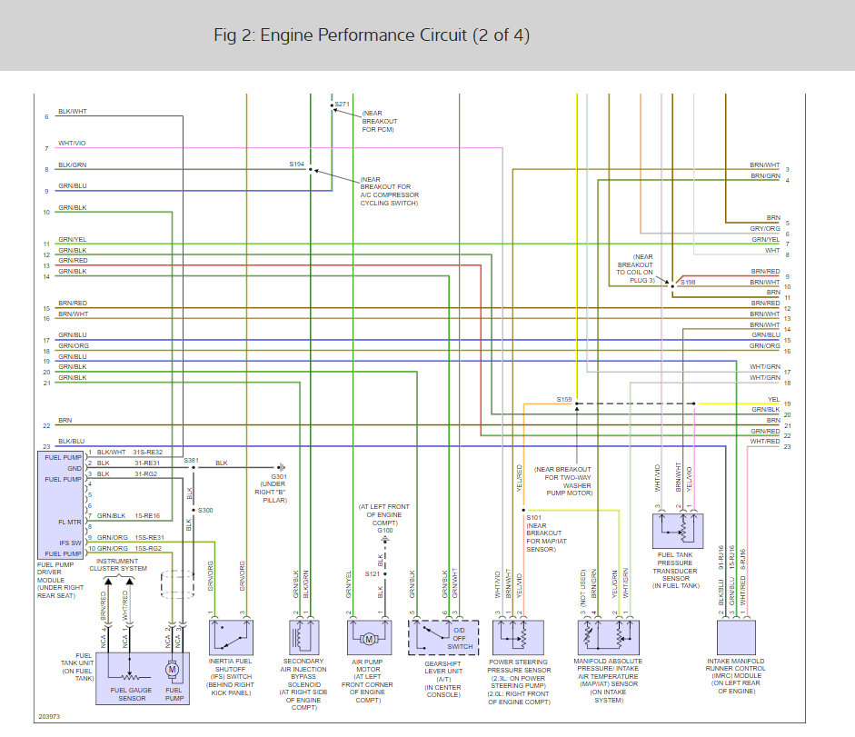

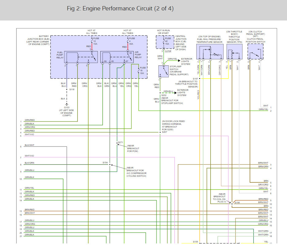

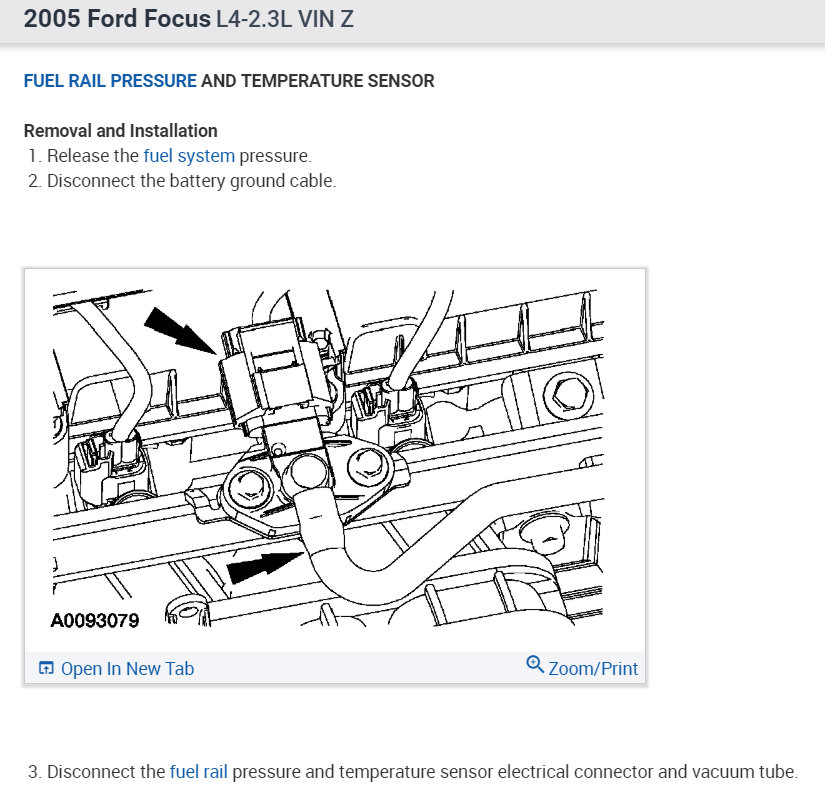

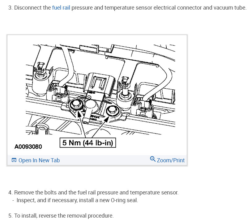

This codes comes up because the fuel pressure sensor went out which is common. Here is the location so you can replace it. Check out the diagrams (below). Please let us know what happens.

As I said in the first post, I replaced the Fuel Rail Pressure (FRP) sensor first. No change.

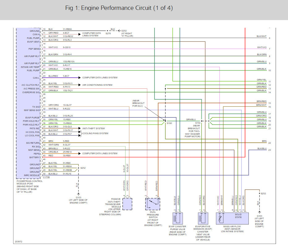

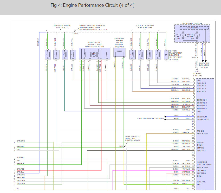

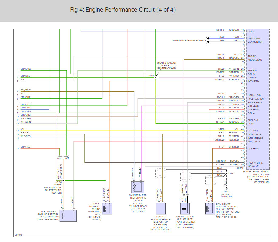

Sorry about that, the code is for a circuit error lets use this guide to check the connection from the sensor to the PCM the wiring diagrams are below.
