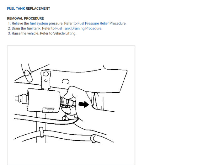

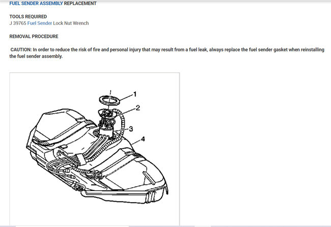

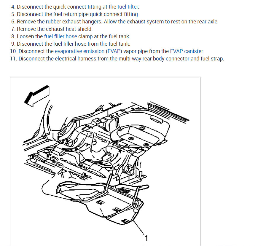

Good morning,
This sounds like the pump is failing under load.
The spec is below. Even with the key on, engine off, the pressure is too low. I would suggest replacing the fuel pump.
https://www.2carpros.com/articles/how-to-replace-an-electric-fuel-pump
