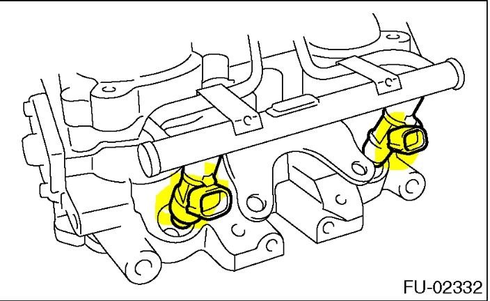

The fuel pressure seems good. However, it shouldn't drop off that fast. Since the engine isn't running as it should fuel mileage has dropped, it almost seems as if there is a stuck injector or at least a leaking injector.
Do me a favor. Here is a link that explains how to check injectors. Read through it and see if everything seems to be working properly on the vehicle.
Also, the reason I am saying injector for the pressure drop is because if the issue was before the engine (pump, filter, and so on) it wouldn't be causing decreased MPG. Try this and let me know what you find.
https://www.2carpros.com/articles/how-to-test-a-fuel-injector
The injectors aren't real easy to access. I attached a pic of how they are located on one side.
Let me know what you find.

Hi, thank you for your response Joe. Finally, I’ve tested injectors according to instructions you provided. It seems like injectors are good. All power and resistance tests are okay. Then, I removed fuel rail with injectors and watched them while fuel system was under pressure, and no one of them was leaking. Spray patterns are all good enough. Additionally, I decided to stop fuel flow on the pipe from gas tank right after the pressure gauge by holding it with pliers. So I could check if the pressure isn’t dropping on its way to engine. The result was that it doesn’t hold pressure too. So what can it be? Fuel pump and filter are inside of a gas tank. Can fuel pressure be lost through fuel pump?

Chances are it is the pump. If pressure is dropping between the pump and engine, the anti flow back valve may be bad in the pump.
