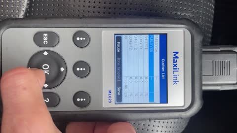

It had few codes that could be related or not, I deleted all to see what stay, you can drive it with check engine light off till you start it again. The only code that came back is P2540:LOW PRESSURE FUEL SYSTEM SENSOR CIRCUIT RANGE/PERFORMANCE

Here us a video if that helps

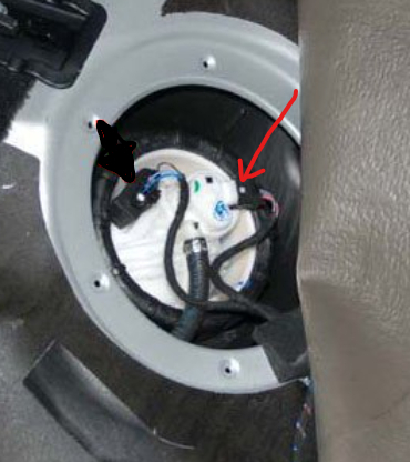

Yep, 9 times out of 10 it will be the sensor which is located at the tank on top of the low pressure fuel pump. Other possibilities are the fuel check valve is stuck open, the low pressure fuel pump is bad, or you have water in the tank (rare). Here is the location of the low pressure sensor so you can swap it out and then clear the codes. Luckily there is a trap door for the fuel pump. Check out the images (below). Please let us know what happens.

Sure here is the part number for the low pressure fuel pump pressure sensor.
Bosch (1561530028) Fuel Pressure Sensor
Clear the code once completed, Ken
Jan 10, 2026 at 1:09 AM
BHAMDOC1
  • 334 POSTS
Seems like this one maybe at the engine side. I thought we were talking about the one on too of fuel tank? Cause this one has bolts and in some sites says on fuel rail
Jan 10, 2026 at 1:42 AM
  • 55,224 POSTS
Hmm, good call that one does not look right. Let try this one instead.
OEM Mercedes part 1635422818
Let me know, Ken
Jan 11, 2026 at 1:08 AM
BHAMDOC1
  • 334 POSTS
Changed it, which was under the rear seats. Got a code p0193 without check engine being on
Jan 14, 2026 at 11:46 PM
  • 55,224 POSTS
NICE!! so we got the one problem fixed. Please start a new thread for the p0193 code. Which will involve the high pressure pump. Are you sure this car has the correct fuel, and the fuel is not contaminated?
