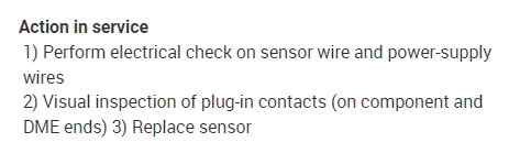

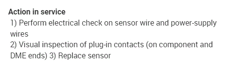

The code likely indicates a poor connection. The sensor could be bad, but according to the diagnostics, it indicates checking wiring and connectors first. (Pic 1 below)

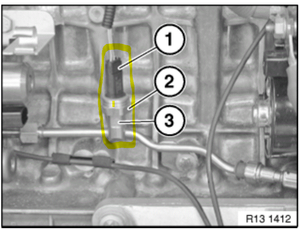

To access the low-pressure sensor, the throttle body needs to be removed. Once removed, you will have access. See pic 2 for location.
If the connector and wiring are in good condition, check for a 5v reference in the plug.
Let me know what you find.

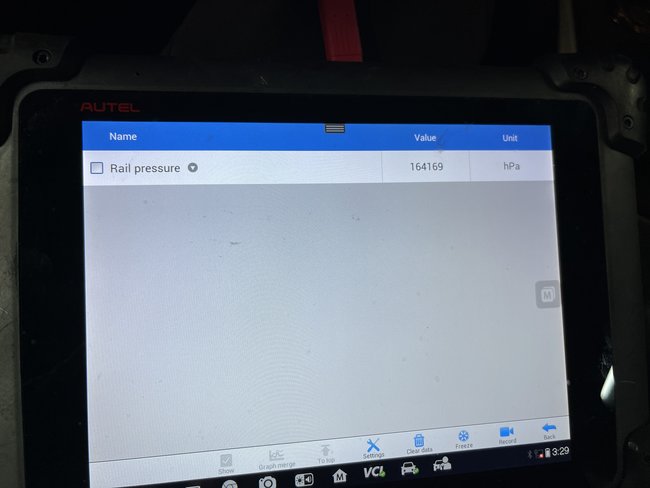

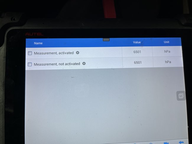

Got some readings from scanner, but this low-pressure reading does not change, whether car is off or on, while the high-pressure readings move.

I suspect you have an issue with the low-pressure sensor. Were you able to perform the tests listed above?
