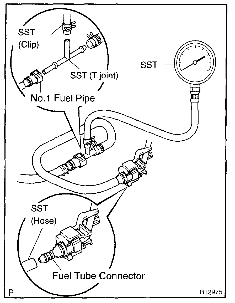

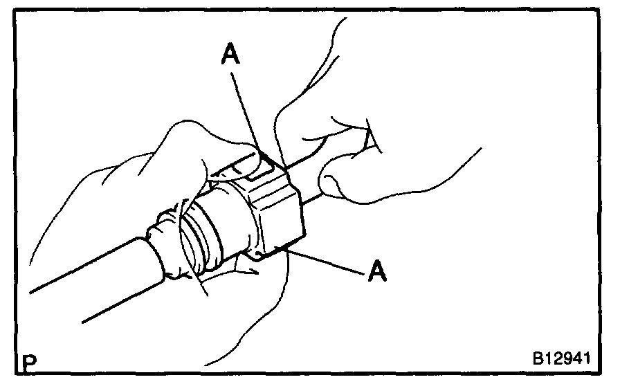

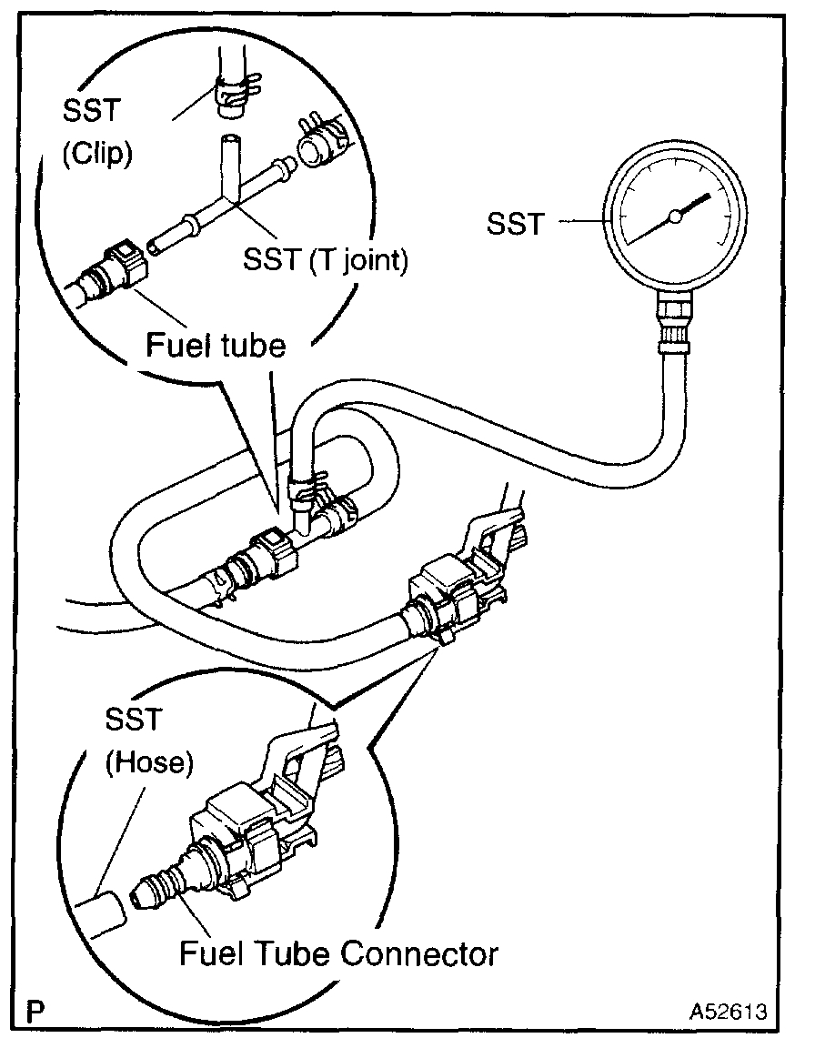

Where do you connect the fuel pressure gauge to check the fuel pressure? I do not see a Schrader valve like most cars have.

Here are general directions for testing fuel pump pressure:
Here are the directions specific to your vehicle. Note: No engine size was provided, so I have attached directions for both the 4 and 6 cylinder engine. First is the 4 cylinder. Pictures 1-4 correlate with these directions. Pressure specifications are in the directions.

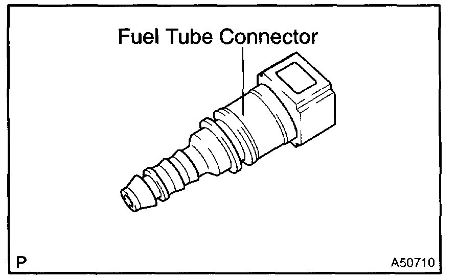

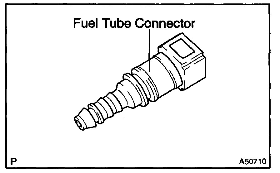

1. Purchase the new fuel tube and take out the fuel tube connector from its pipe.
HINT: Part No. 23901-28130

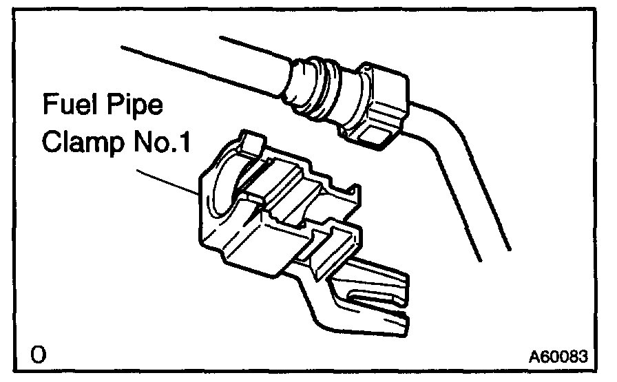

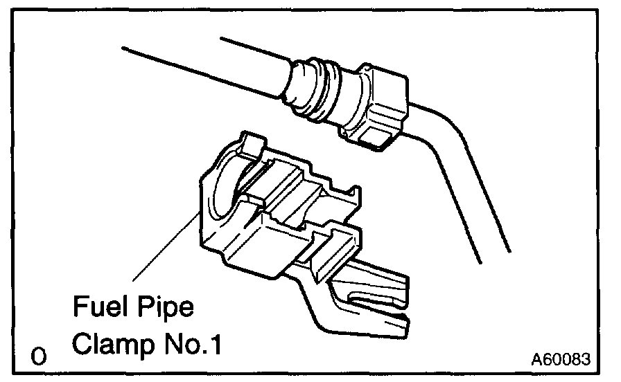

c. Remove the fuel pipe clamp No.1 from the fuel tube connector.

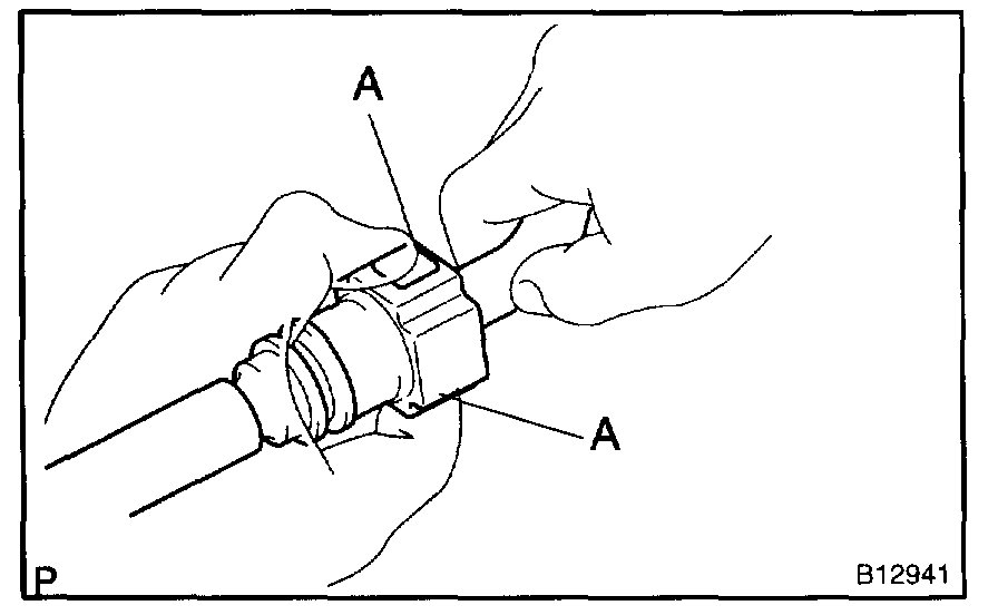

d. Disconnect the fuel tube connector from the fuel pipe while pinching part A with fingers as shown in the illustration.
CAUTION: Perform disconnecting operations of the fuel tube connector (quick type) after observing the precautions.
As there is retained pressure in the fuel pipe line, prevent it from splashing inside the engine compartment.
e. Install SST (pressure gauge) as shown in the illustration by using SST and fuel tube connector.
SST 09268-41047 (90467-13001, 95336-08070), 09268-45012 (09268-41250)

Here are the directions for the V6. All remaining pictures correlate with these directions.

1. Purchase the new No.1 fuel pipe and take out the fuel tube connector from its pipe.
HINT: Part No. 23801-20140
d. Disconnect the fuel tube connector from the fuel pip while pinching part A with fingers as shown in the illustration.
CAUTION: Perform disconnecting operations of the fuel tub connector (quick type) after observing the precautions.
SST 09268-41047 (95336-08070), 09268-45014 (09268-1250)
