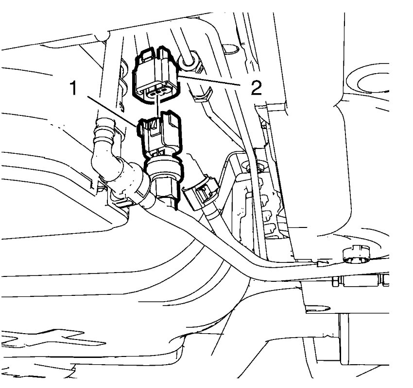

The car won’t stay running, it shuts off while driving. It’s not getting enough fuel pressure, and I just replaced the fuel pump.

There is a fuel pressure sensor which sounds like it is weak or gone out, I would run the codes to see if any are stored, here is a guide to help and the location of the sensor so you can change it out if there is a code for it.
