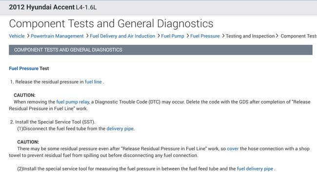

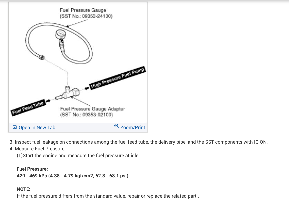

I need to know the fuel pressure of this car.

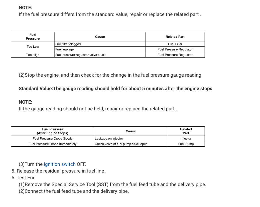

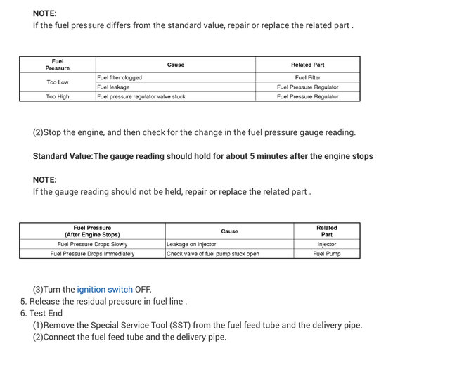

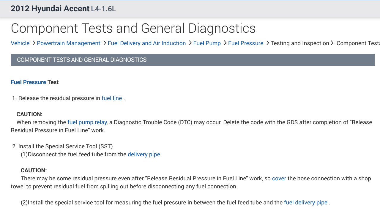

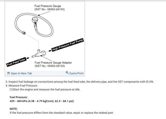

In the diagrams down below I have included the instructions for how to test the fuel pressure on your vehicle. You should be able to rent a fuel pressure tester from your local auto parts store, like AutoZone for a refundable deposit. Please go through this guide and get back to us with how everything turns out.

This guide will help walk you through the testing:
