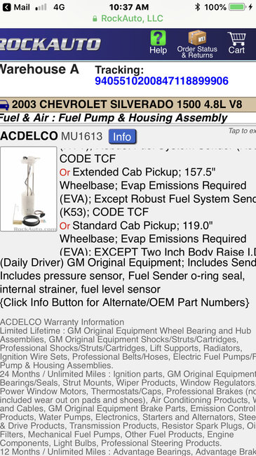

Installed AcDelco pump.

The fuel pressure is too low.
Chances are you got the wrong fuel pump when you bought it. They may not have asked you what you eighth digit was in the VIN.
Except VIN Z .................... 385-425 kPa (55-62 psi)
