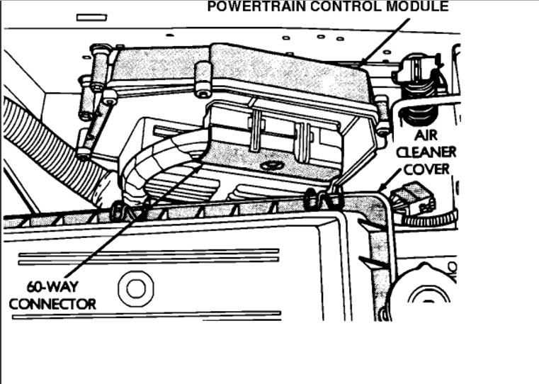

Hello and thank you for the reply. Once I realized that the relays were involved, I repeated the starting steps, holding my fingers on the Fuel Pump and ASD relays to see if either or both of those are the ones vibrating. It turned out to be both. Since I had replaced those last winter, and they DO kick in after the waiting period, I figured it's not a relay problem but must be something related to them. After further internet searching and forum research, using 'clicking sound from fuel pump relay" as my search, the exact symptoms that I've been describing began popping up in the forum topics. The majority of these attributed the problem to the ECM, and a typical Jeep problem with three specific capacitors that get loose over time. I'm convinced this is my problem, given all the other things I've already tried and the age of my truck.
The first thing I will do is clean the grounds around the engine compartment. Any advice you can give me on that would be appreciated (I can't find the one that is apparently on or near the fire wall). If that doesn't fix the problem, the decision I will be faced with is do I try to fix (resolder the capacitors), or fork out $250+- for a warrantied rebuilt ECM. I'm not a soldering guy, and don't really want to learn.

I was going to say I think the ECM is bad so its great we came to that conclusion together. I would try to find a used one BTW.

If you know how to identify a broken solder connection, and you find one, look for a local tv repair shop, if there's still one around that wasn't run out of business by the manufacturers. Bad solder connections account for at least half of their repair business. The problem I think you're going to be faced with is these boards are usually sealed in a gel material that is hard to see through. I've ground some of that stuff off to solder on wires and create breaks to build "bugs" for my students to diagnose. Ford computer boards are not sealed against moisture like that, so they're easier to break, but I built mostly Chrysler trainers because they donated a lot of cars to our school when they were done with their dealer training on them.
