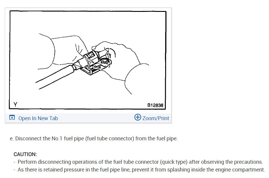

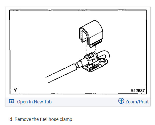

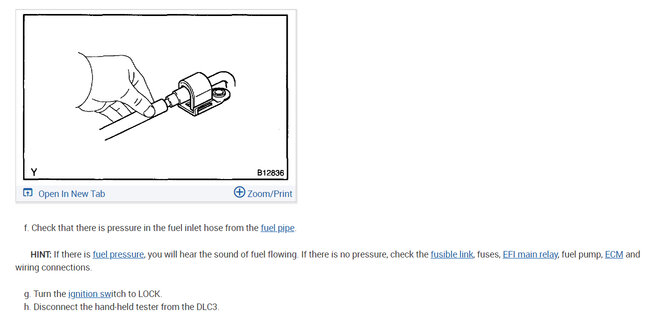

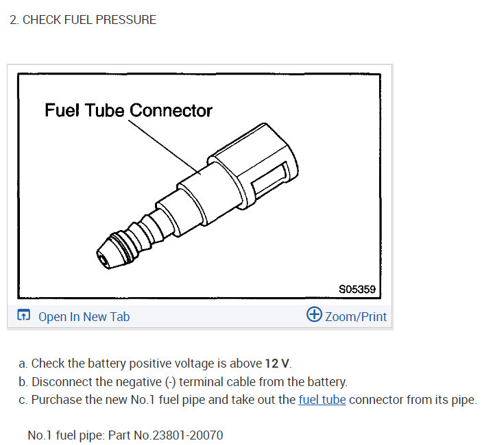

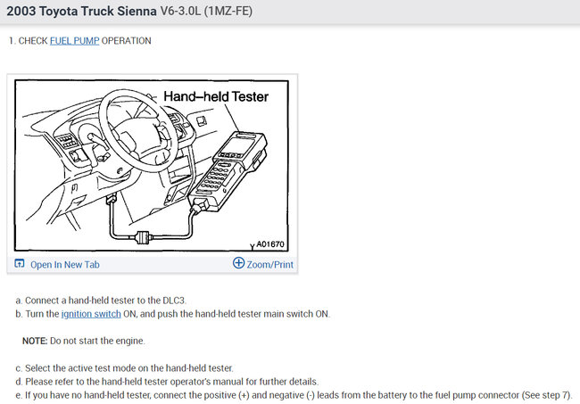

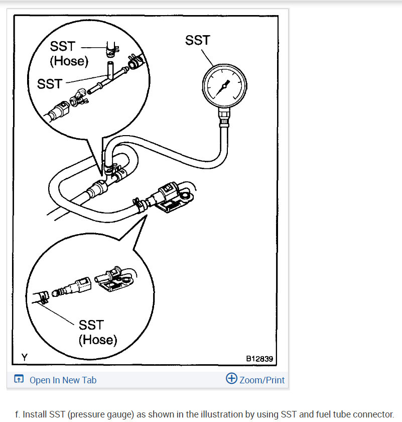

When the engine starts and stalls is the security light flashing? If so, this is the problem, and the security system needs to be reset. If not when the engine stalls, try to use starting fluid to see if that changes anything, if so then you are on the right track with the fuel pump. Here is how to check the fuel pressure a step-by-step guide with instructions below to help you with your car, you can rent a fuel pressure gauge from the auto parts store for free or cheap.
Fuel Pressure Specifications
Toyota DLC-3 Hand tester connected, Engine idling .................... 301 - 347 kPa ( 44 - 50 psi )
Toyota DLC-3 Hand tester disconnected, Engine idling .................... 301 - 347 kPa ( 44 - 50 psi )
Residual Pressure after 5 minutes, Engine off .................... 147 kPa ( 21 psi)
Check out the images (below). Please upload pictures or videos of the problem so we can see what's going on.
