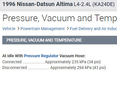

what is the fuel pressure for this vehicle?
240,000 MILES • 2.4L • 4 CYL • 2WD • AUTOMATIC
KRAUTHEAD
fuel pressure.
Jul 17, 2021 at 2:17 PM
SQM
  • 6,383 POSTS

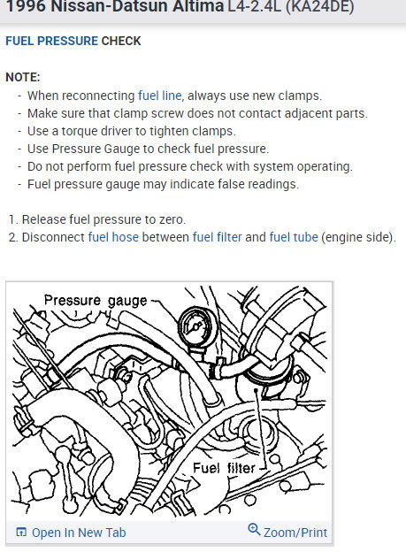

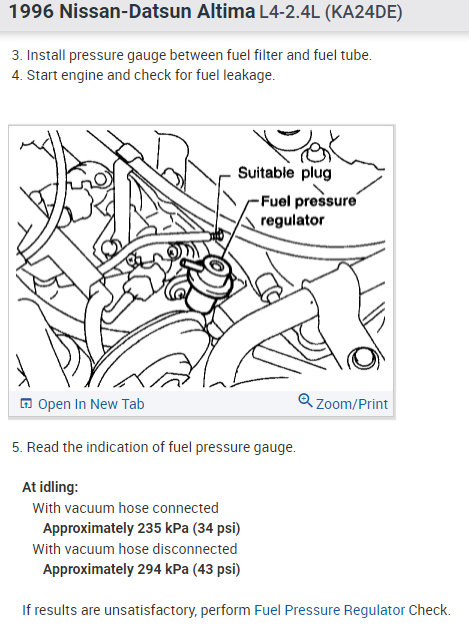

Here is the fuel pressure specifications:
At Idle With Pressure Regulator Vacuum Hose:
Connected .................... Approximately 235 kPa (34 psi)
Disconnected .................... Approximately 294 kPa (43 psi)
