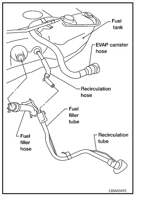

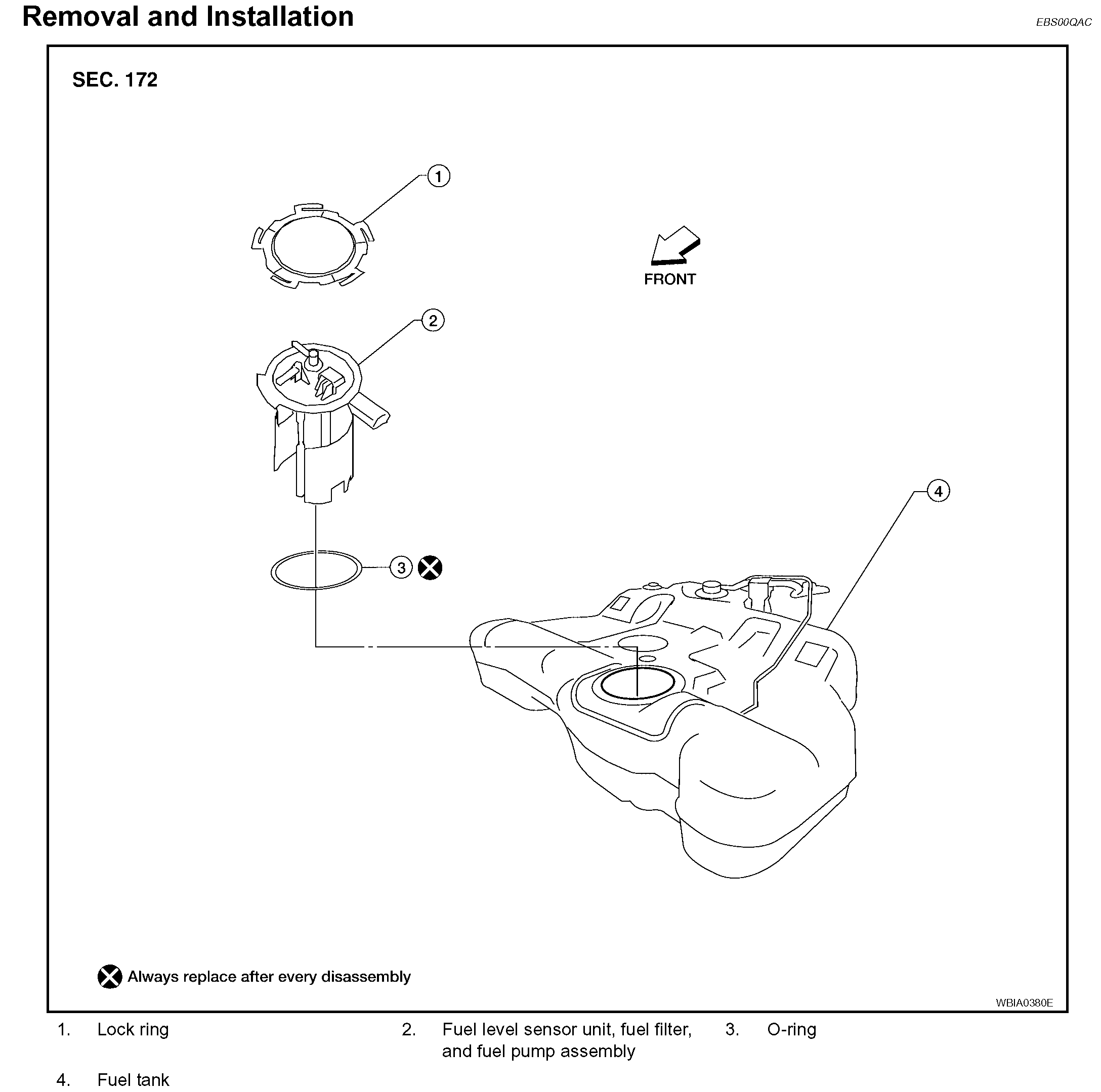

Fuel pump is not working can I fix it?
Jan 30, 2020 at 7:23 PM

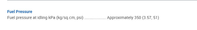

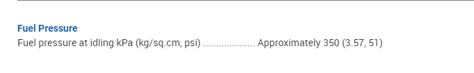

When you say the pump is working, do you mean you can hear it run when you turn the key on? If this is the case, we need to actually test the fuel pressure because I suspect the pump is running but not actually building pressure to send the fuel.
Let's run a fuel pressure test and see what we have and go from there.
Jan 30, 2020 at 7:46 PM
  • 110,194 POSTS

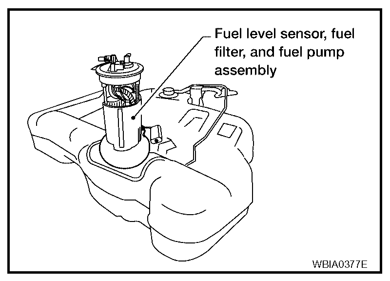

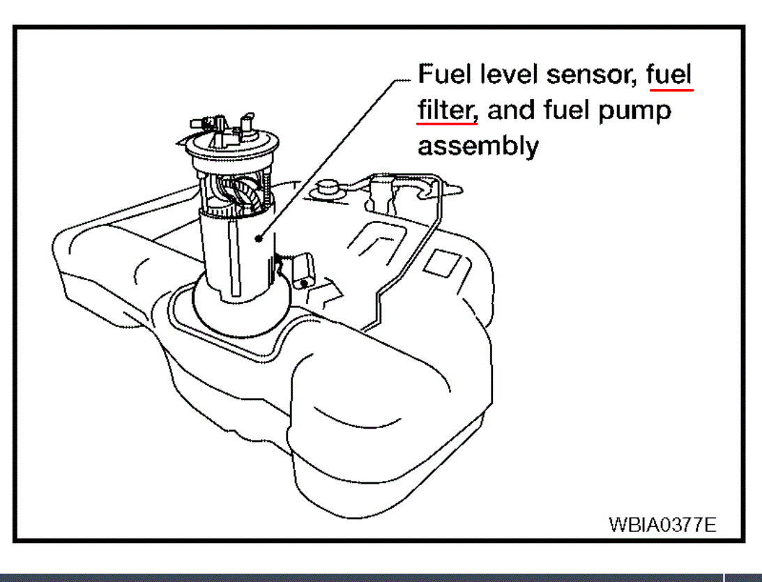

It is possible for the pump to run and not produce pressure. It could be the pump or a clogged fuel filter. The filter is in the fuel tank on this vehicle and part of the fuel pump assembly. (See pic 1.)
If there is no pressure making it to the engine fuel rail and there are no damaged fuel lines, chances are the pump is bad, but I would check the filter when the pump is out. Sadly, once you have everything out, it is a good idea just to replace the pump as well even if it is the filter because damage may have occurred to the pump leading to failure soon after. You don't want to remove it more than once.

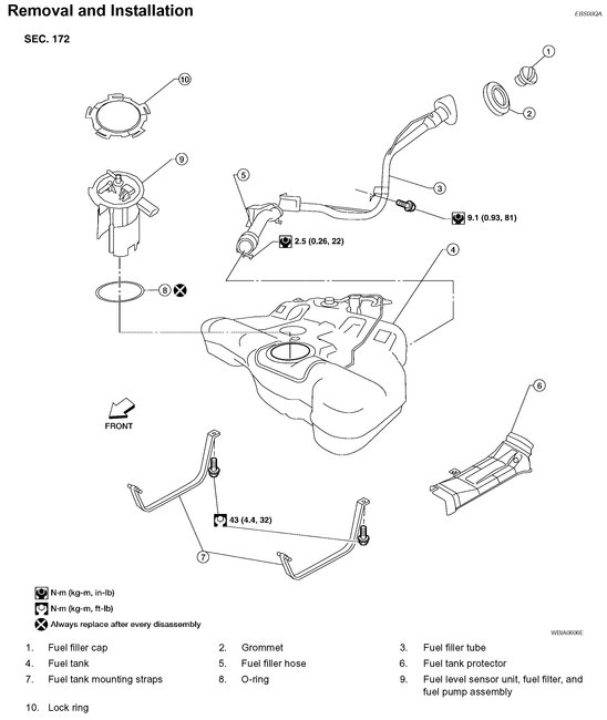

Here are the directions for replacement specific to your vehicle. To do this requires removal of the fuel tank. I will start with those directions. The pump removal will be second.
_____________________________
2006 Nissan-Datsun Truck Quest V6-3.5L (VQ35DE)
Fuel Tank Removal and Installation
Vehicle Powertrain Management Fuel Delivery and Air Induction Fuel Tank Service and Repair Procedures Fuel Tank Removal and Installation
FUEL TANK REMOVAL AND INSTALLATION
FUEL TANK
pic 2
REMOVAL
WARNING:
Read "General Precautions" before working on the fuel system.
Refer to "General Precautions".

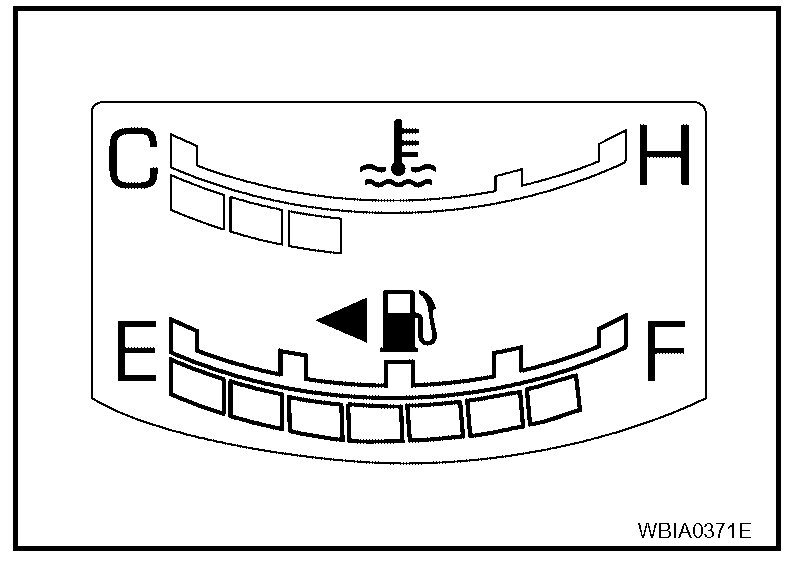

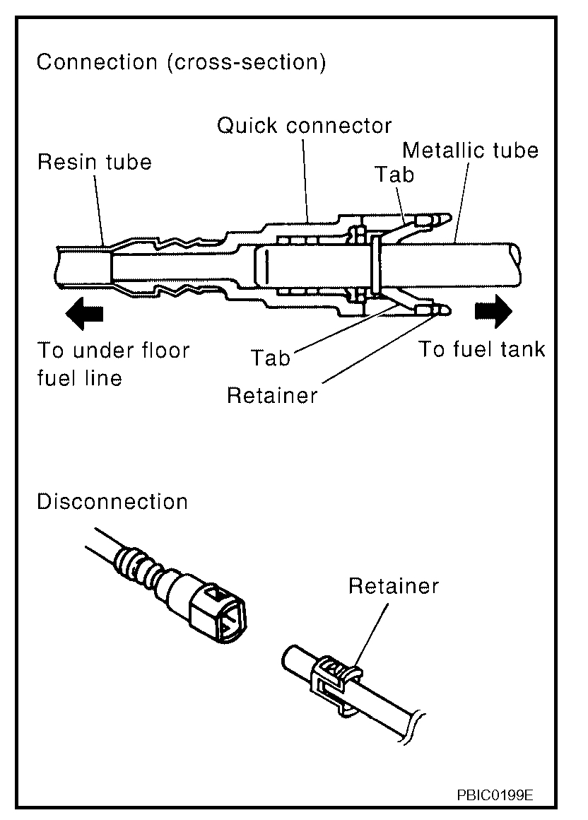

1. Check the fuel level with the vehicle on a level surface. If the fuel gauge indicates more than the level as shown (7/8 full), drain the fuel from the fuel tank until the fuel gauge indicates a level at or below as shown (7/8 full).
- In case the fuel pump does not operate, use the following procedure.
a. Insert fuel tubing of less than 25 mm (0.98 in) diameter into the fuel filler tube through the fuel filler opening to drain fuel from the fuel filler tube.
b. Disconnect the fuel filler hose from the fuel filler tube.
c. Insert fuel tubing into the fuel tank through the fuel filler hose to drain fuel from the fuel tank.
-As a guide, the fuel level reaches or is less than the level on the fuel gauge as shown, when approximately 10 liters (2 5/8 US gal, 2 1/4 Imp gal) of fuel is drained from a full fuel tank.

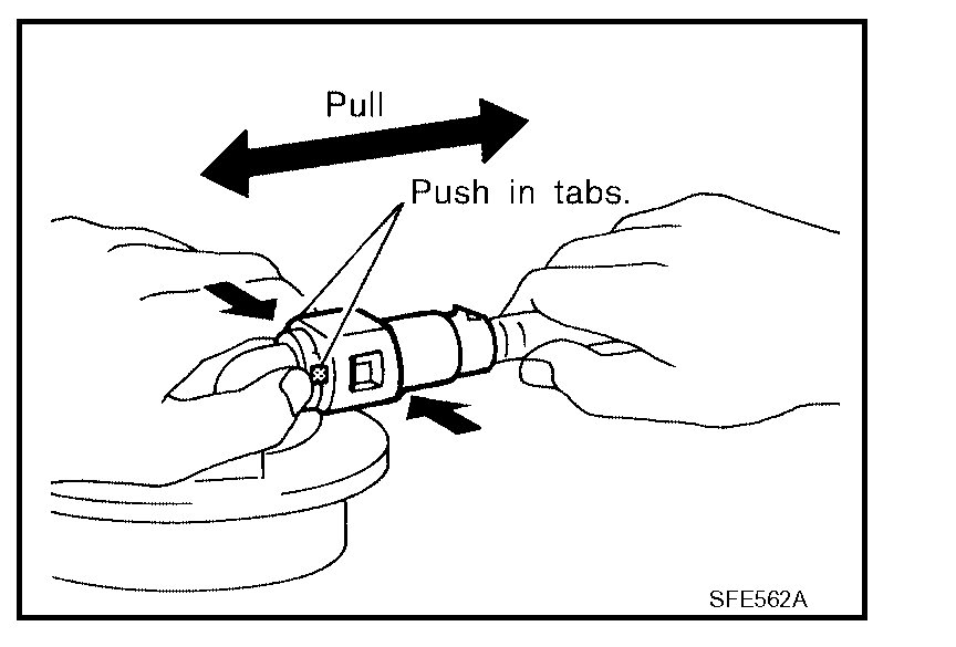

8. Disconnect the fuel filler hose, recirculation hose and EVAP canister hose at the fuel tank as shown.

10. Lower the fuel tank to access the top of the fuel level sensor unit, fuel filter, and fuel pump assembly.
pic 5

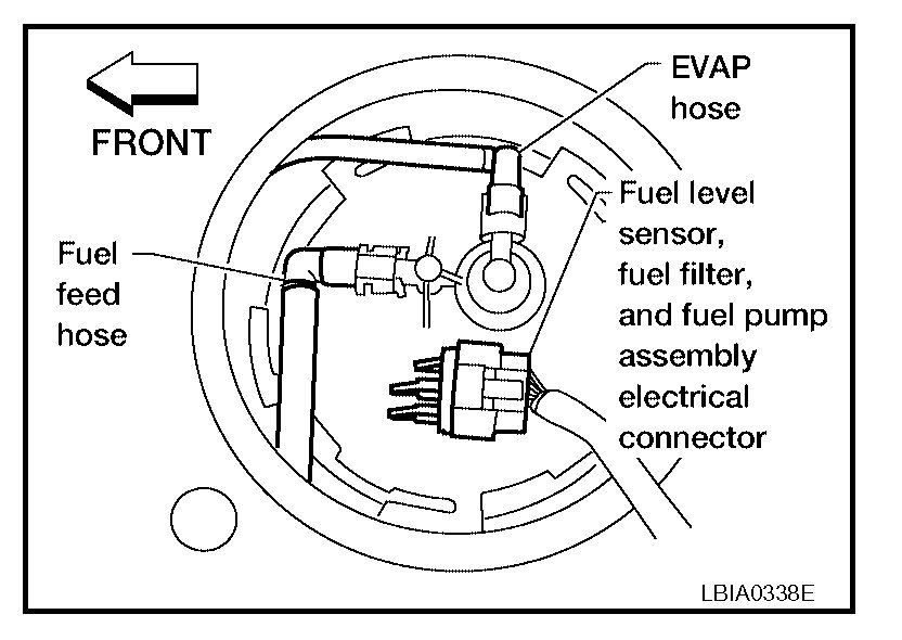

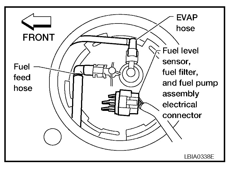

11. Disconnect the fuel level sensor unit, fuel filter, and fuel pump assembly electrical connector, and the fuel feed hose from the fuel level sensor unit, fuel filter, and fuel pump assembly.

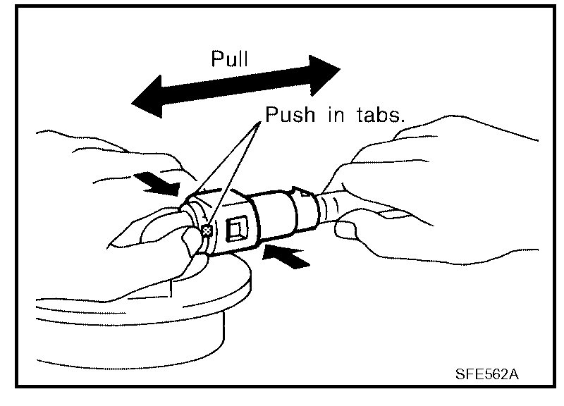

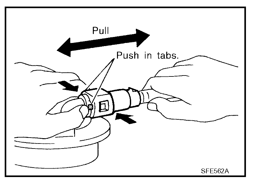

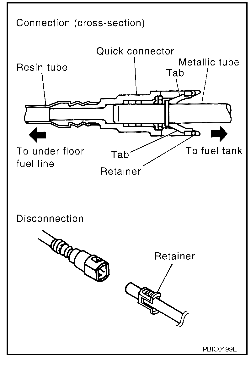

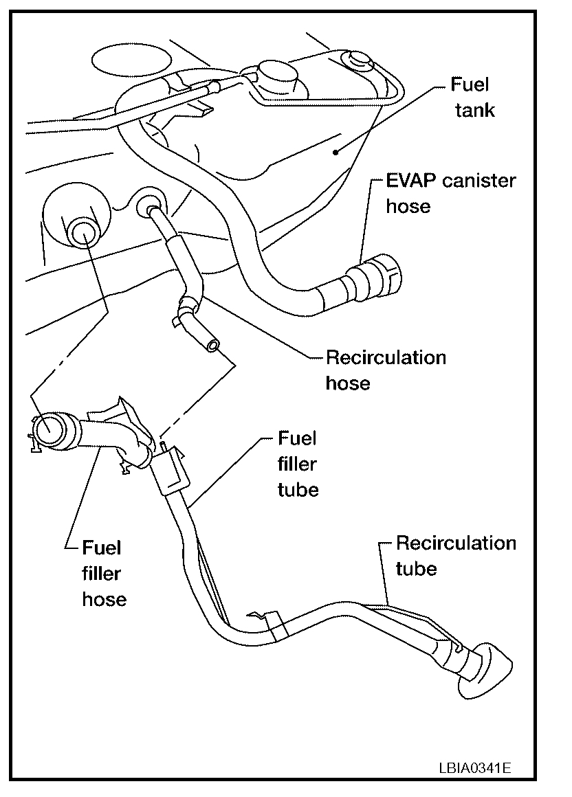

a. Disconnect the quick connectors as follows:
- Hold the sides of the connector, push in tabs and pull out the tube.
- If the connector and the tube are stuck together, push and pull several times until they start to move. Then disconnect them by pulling.
CAUTION:
- The tube can be removed when the tabs are completely depressed. Do not twist it more than necessary.
- Do not use any tools to remove the quick connector.
- Keep the resin tube away from heat. Be especially careful when welding near the tube.
- Prevent liquid acids, such as battery electrolyte, from getting on the resin tube.
- Do not bend or twist the tube during installation and removal.
- Only when the tube is replaced, remove the remaining retainer on the tube or fuel level sensor, fuel filter, and fuel pump assembly.
- When the tube or fuel level sensor, fuel filter, and fuel pump assembly is replaced, also replace the retainer with a new one (green colored retainer).

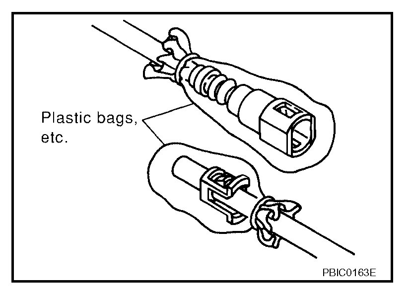

- To keep the connecting portion clean and to avoid damage and foreign materials, cover them completely with plastic bags or something similar.

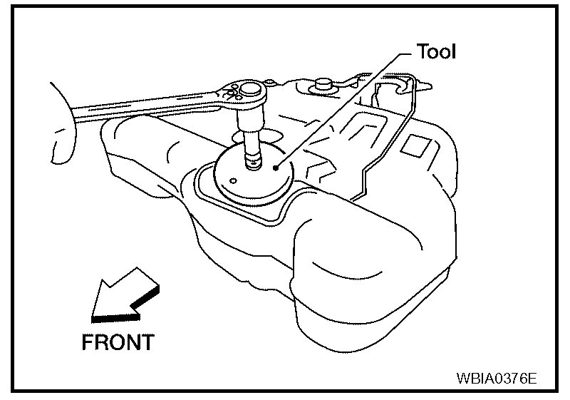

1. Remove the fuel tank.
pic 11

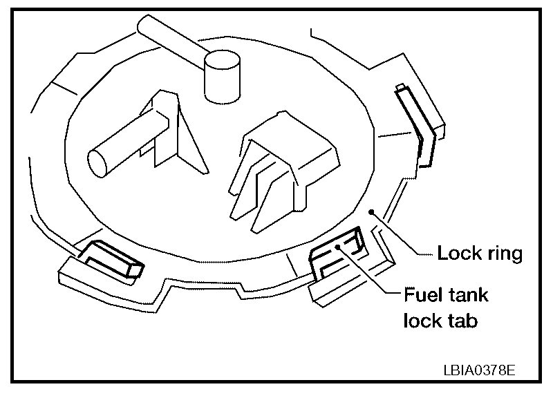

2. Remove the lock ring using a socket drive handle and Tool as shown.
Tool number : KV991J0090 (J-46214)

- Turn the lock ring until the lock ring is fully rotated into the fuel tank lock tabs as shown.

The fuel pump working but the gas not going through the line to manifold. I can blow high air from manifold to line at fuel pump but can't get air from gas line at pump to manifold.
Feb 1, 2020 at 2:21 PM
Just because the pump runs doesn't mean it is building pressure. I would measure the pressure before going any further. If there is not pressure then there is no fuel. If the line is clear then the pump is the issue.
