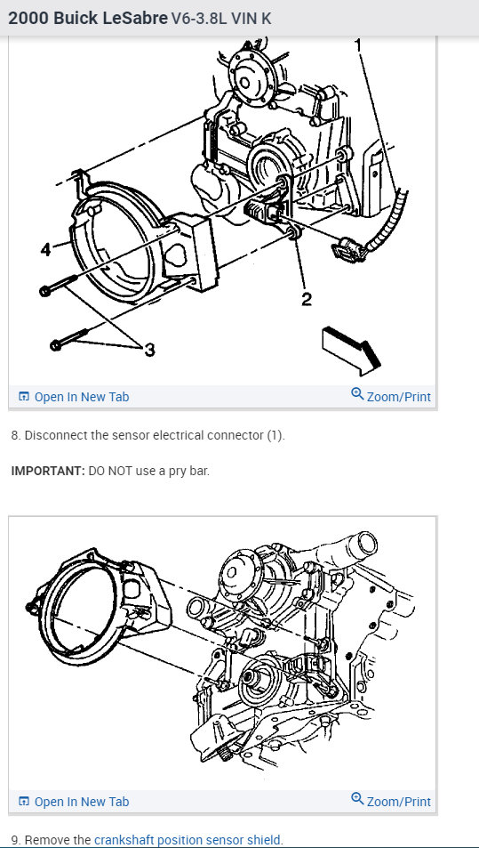

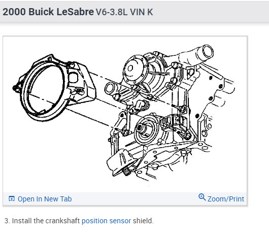

Have a crank won't start condition. While I was driving and felt like it ran out of gas, the car shut off and wouldn't start. The car has fuel, the fuel pump runs, and the fuel pressure gauge reads 40 PSI key on not running. Should it start? What pressure should a good pump run at? Fuel pump was replaced 4 years ago.
Jul 27, 2022 at 3:10 AM
SQM
  • 6,383 POSTS

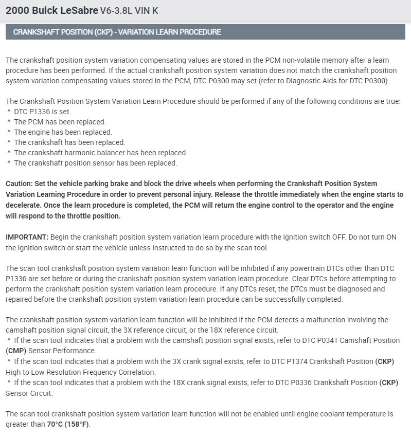

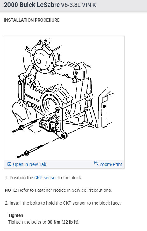

With the key on and engine off the fuel pressure should be 48 - 55 PSI. So, you are not too far off.
This could be due to a faulty crankshaft position sensor.
Over time with heat and vibration the sensor can go bad and can send an error signal to the ECM. That can trigger the engine to shut down. After the shutdown you may or may not be able to start it back up. It will usually only crank.
Take a look at this helpful guide:
https://www.2carpros.com/articles/engine-stalls

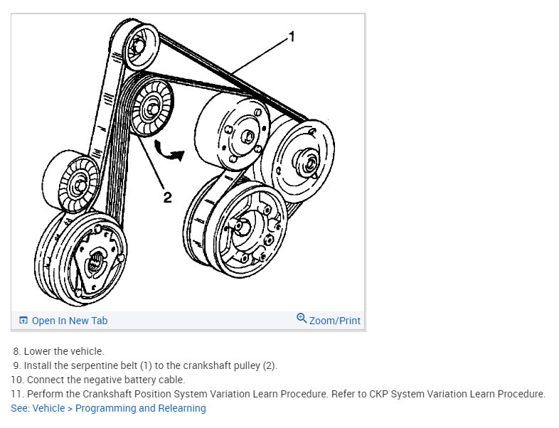

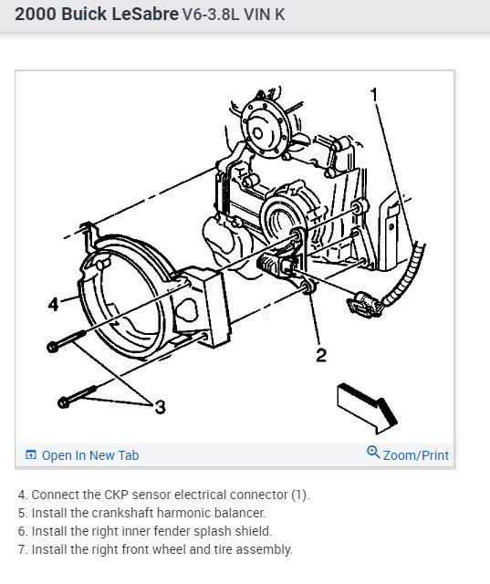

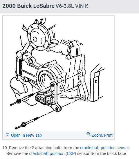

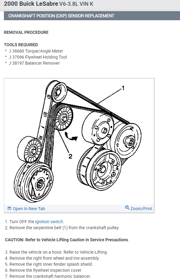

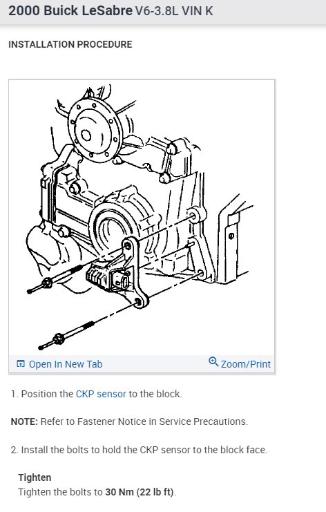

I have attached the crank sensor replacement and relearning procedure below.
Let me know of any questions.

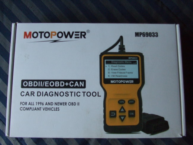

I ordered a multimeter and code reader...code reader came , still waiting for multimeter.

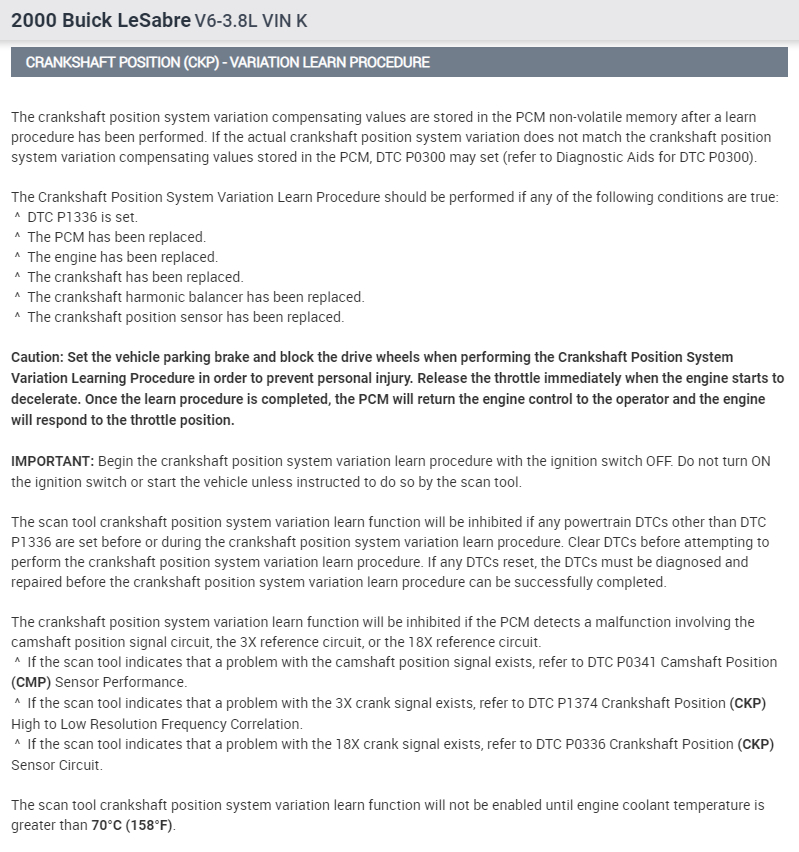

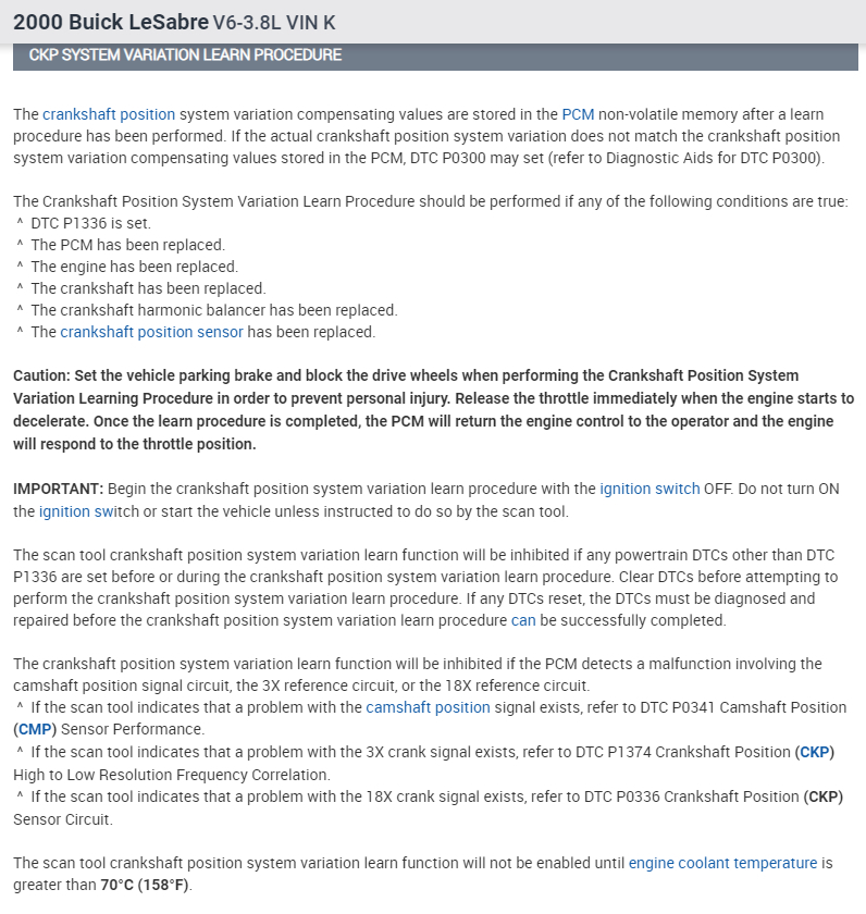

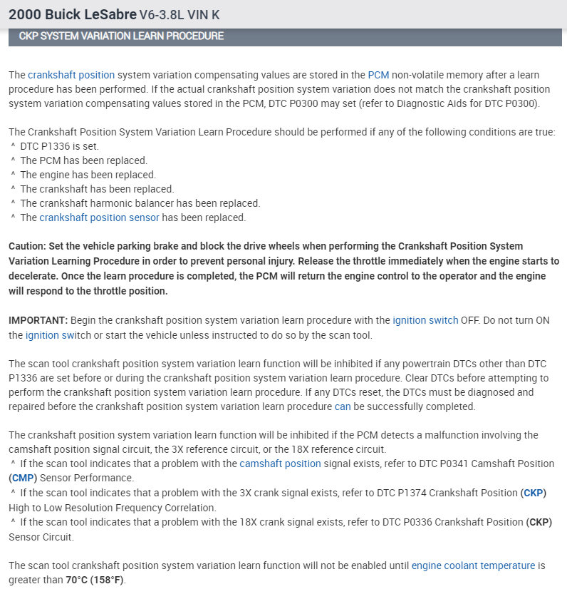

Is there a relearn process for the sensor or something I'm not doing?
Sep 20, 2022 at 9:18 AM
SQM
  • 6,383 POSTS

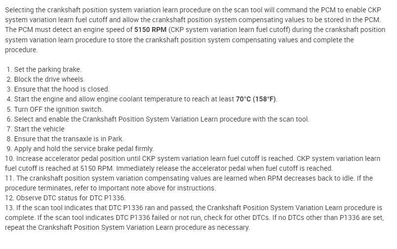

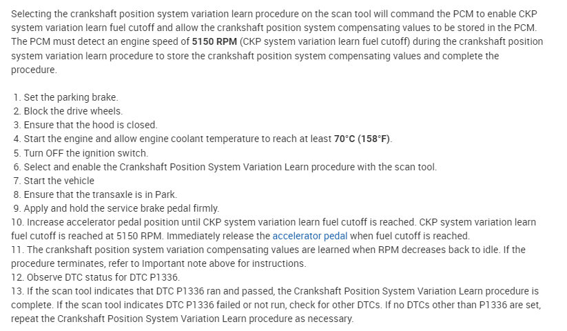

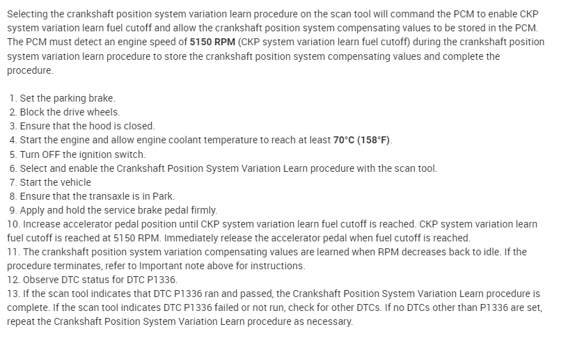

There is a relearn process for the crank sensor. It will require a scan tool.
See below for the procedure.

Will this do the relearn process? Or do I need something else? I don't have a bunch of experience with the scanners and Tech stuff.
Sep 21, 2022 at 1:37 AM
ARTHUR SWEENEY
  • 10 POSTS
Oh, and does the car have to be running to do the relearn?
Sep 21, 2022 at 1:41 AM
SQM
  • 6,383 POSTS
Relearn does require the engine to be running. Take a look at the instructions on the previous post above.
