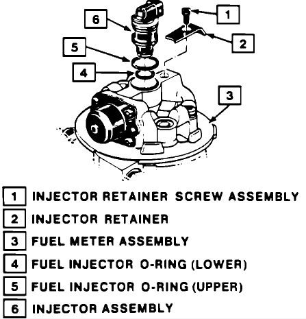

1. Am I right in that the round plastic piece (#6 in picture) on top of the throttle body with the two wires going to it (that fuel spray visibly pulses out of) is the actual injector that needs cleaning? Or, should I clean whole throttle body? And filter screen is in the fuel line? Or is there one in throttle body?

You are correct on item one. Item two isn't a really big deal as it's nothing but a coil of wire inside there that pulses to open/close the injector. For the pressure you will need an adapter kit that connects into the fuel line at the TBI inlet. Many parts stores have the gauges as loaner tools or you can buy the common vacuum/pressure style units that were sold for years as the pressure is lower than many of the newer gauges will reliably read.

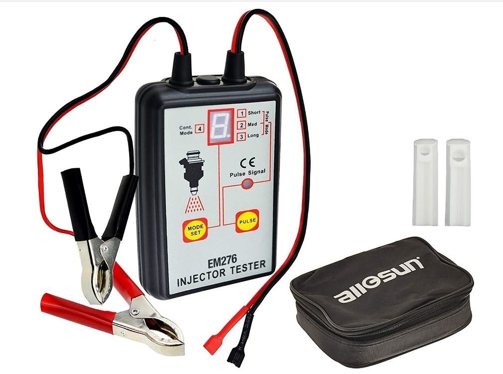

Only thing on the injector is to keep the connector out of the cleaner and get new o-rings for it. If you have a way to pulse it while it is in the cleaner great. A simple 12 volt pulse is all that's needed, I've used a 9 volt battery and a couple wires that get touched to the terminals rapidly. You don't want it locked open as that can damage the coil in it.
If you like electronics you can build a tester yourself.
http://hackaweek.com/hacks/building-an-electronic-fuel-injector-tester/
They are handy to test injectors on many things, and can be used for other things as well.

Will make an injector tester. Will check fuel pressure. And, will fix up

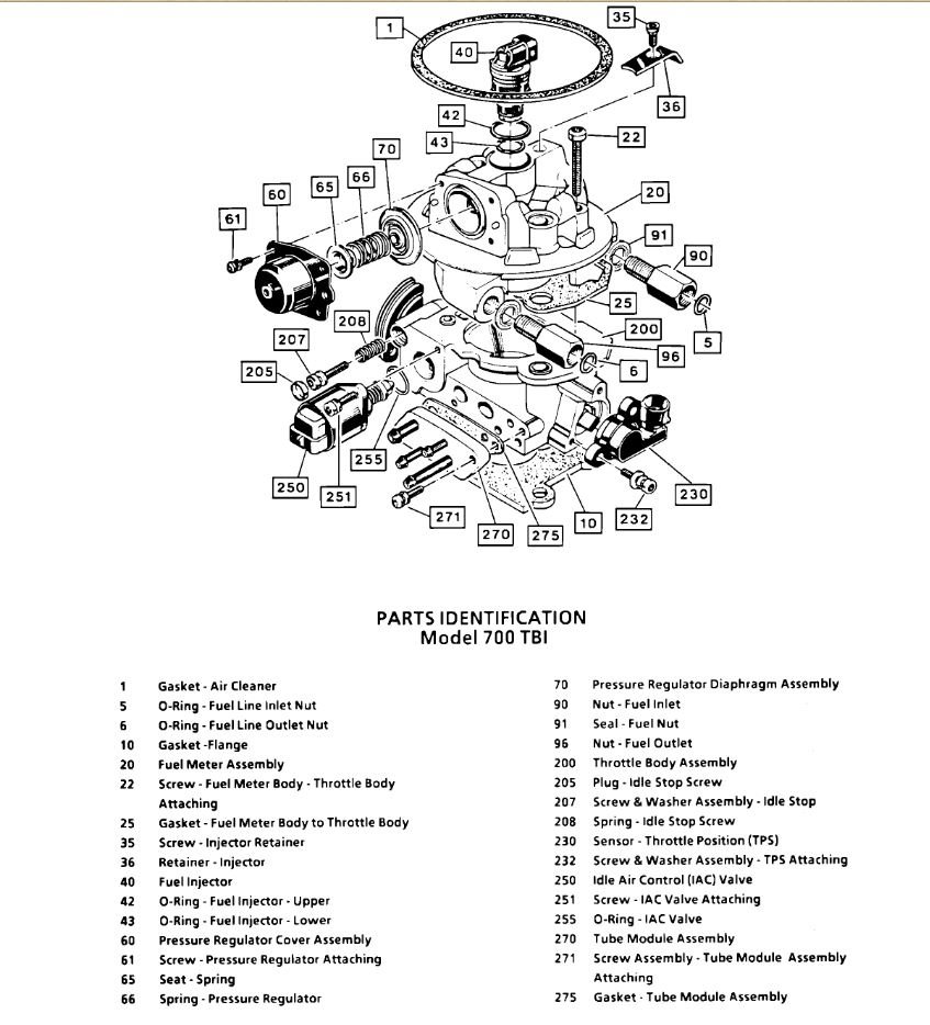

fuel pressure regulator.
It's in with the throttle Body correct?

I would get the regulator rebuilt, yes it's the black item in the image on the front of the TBI. If you don't want to build you can get one off amazon that does the job, it's usually about $40.00.

I would check the injector O-rings and the screen. That and look at the nozzle area of the injector. For that much fuel it almost has to come past the seals. A new injector and the regulator kit isn't a bad idea, but I would try to rule out just bad seals first.
