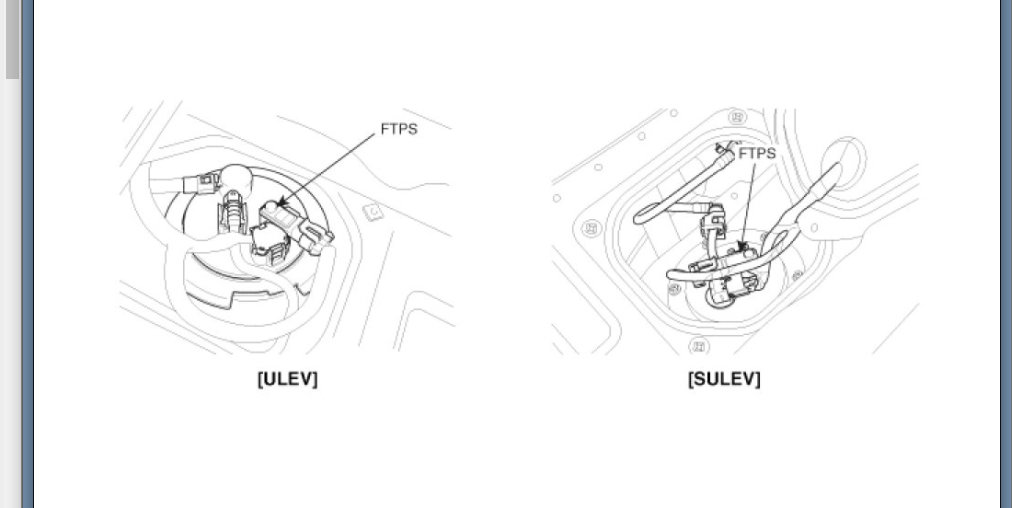

Car starts but won't stay on. Where is the fuel injector sensor?
Oct 5, 2021 at 10:07 AM

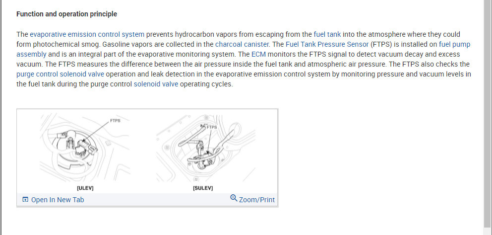

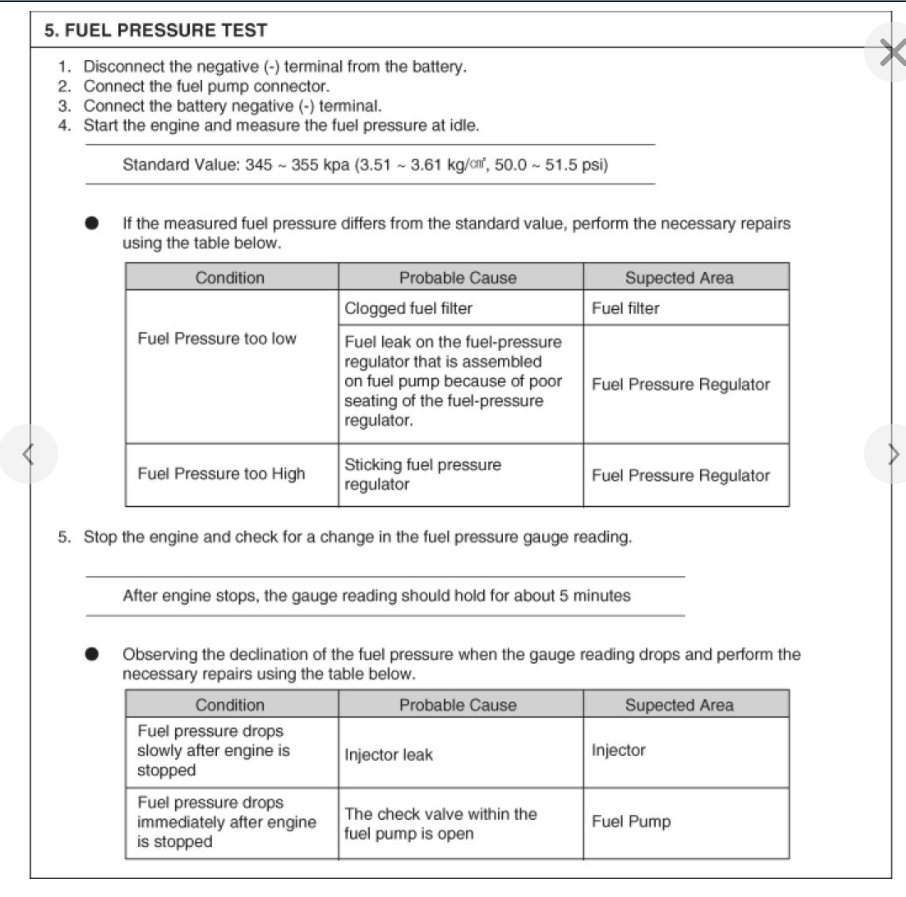

The best thing to do is start with a fuel pressure check. The fuel tank pressure sensor is most likely not going to cause this issue, but anything is possible.

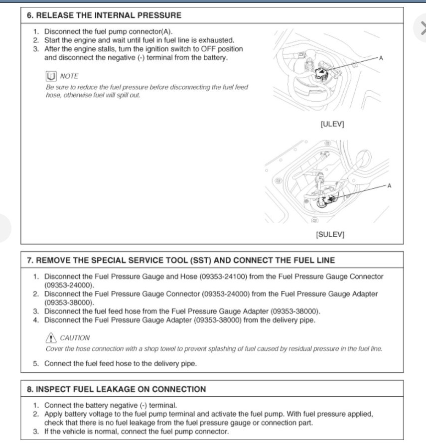

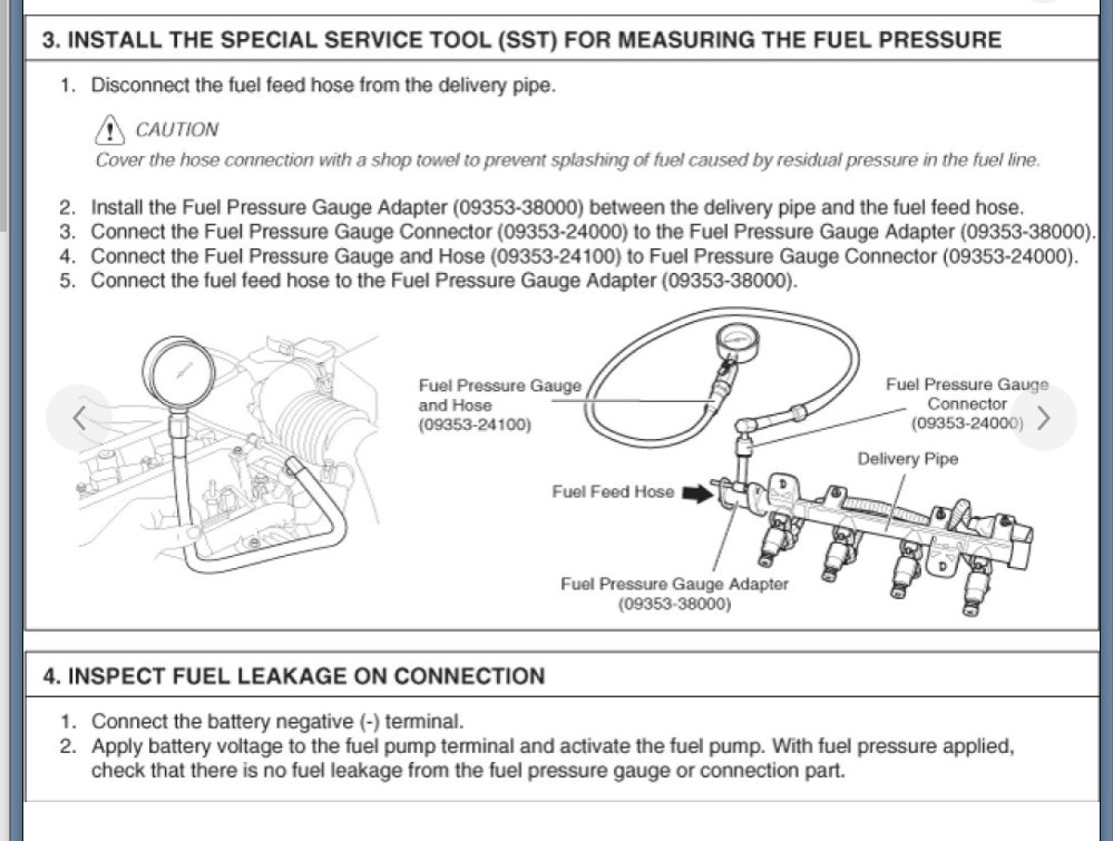

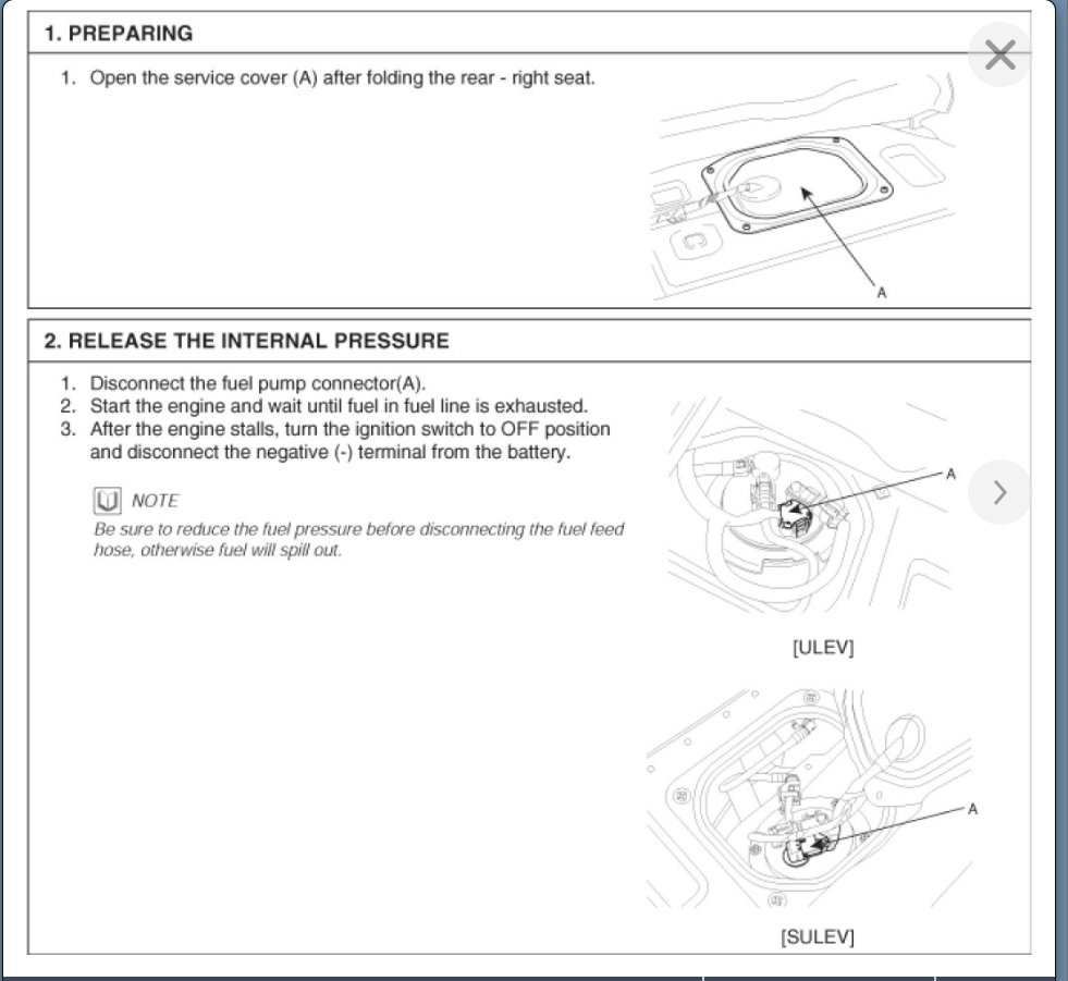

Here are a couple guides that will help with this:
https://youtu.be/dCjmRL3p4Cs
Below is the specific info needed from the manual to do the test.
I also attached the location of the sensor that you requested.
There is not a sensor for the injectors. It is just an overall pressure sensor for the tank so again, I would suggest starting with the pressure and we go from there.
