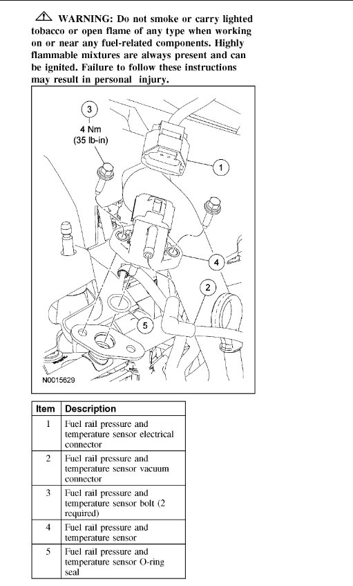

My truck stalled out while driving and tripped a p0191 code. Now it will start initially, and the fuel rail pressure is normal but after a few minutes at idle or after raising the RPMs the fuel rail pressure drops and the trucks stall out. Both banks are adding between 20 and 50% fuel before it shuts off. Does this sound like a bad fuel pump? I changed out the fuel pressure regulator with no change. The fuel filter was replaced 10,000 miles ago.
Jul 9, 2022 at 10:53 PM
  • 55,746 POSTS

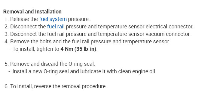

This is common when the fuel pressure rail sensor goes out. here is a video of the replacement on a similar car with instructions in the diagrams below to show you how on your car:
https://youtu.be/A9dbXbydGro
Jul 10, 2022 at 9:24 AM

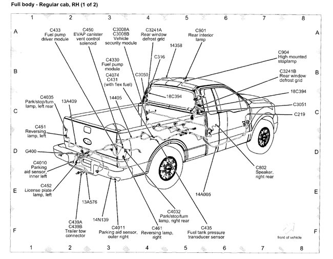

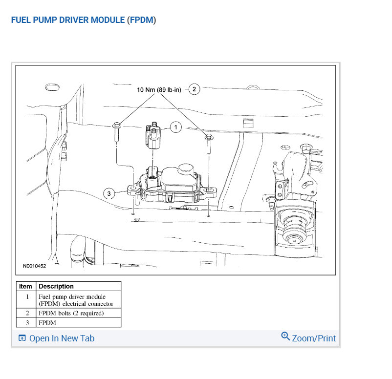

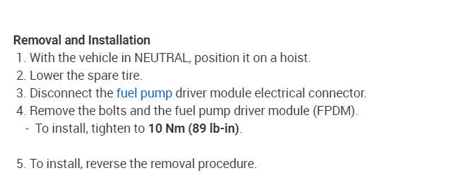

Can I ask if you changed the fuel pump driver module? I have seen these go bad and act like a bad fuel pump, did you use a Motorcraft pump? Here is the location of the pump module so you can check it out. Remove the electrical connector and look for water damage which is common. Check out the diagrams (below). Please let us know what happens.
