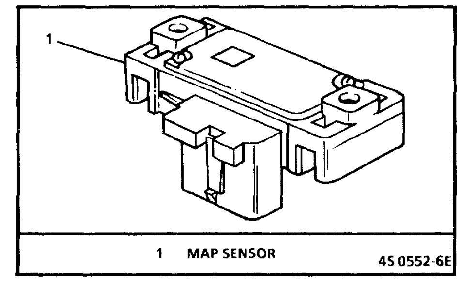

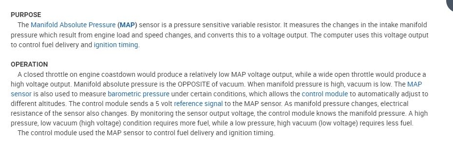

Are you still using the ECM? Without the O2 sensor, there is no signal from the exhaust for fuel control.
The MAP sensor may be the issue as it is dependent on atmospheric pressure.
Is the check engine light on?
