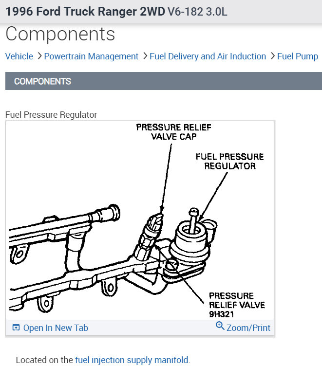

I've checked the fuel pump, it works. The fuel regulator looks like it's been changed, fuel filter is new. I'm not sure about the mass air flow, it seems like it has been changed or damaged. History, the truck has sat for about a year. I put some fresh gas in the tank (already 1/2 tank), dropped my battery in it and it started, very rough at first so I gave it a test run. Drove about a mile stopping and accelerated braking etc. All seemed fine, needing a tune up of course. At around 2 miles I turned on the A/C and it worked, started blowing cold air about a minute later I slowed for a stop sign when the engine seemed to go into limp mood! It didn't shut off, but every time I have gas it bogged down .so I feathered it and coasted to a safe spot. I'm not sure what to do now. I drained the gas and put fresh gas in. Changed the oil, the radiator fluid and all filters but it won't run past a idle very rough at that. This is what the fuse box looked like lol I'm sure something's wrong!

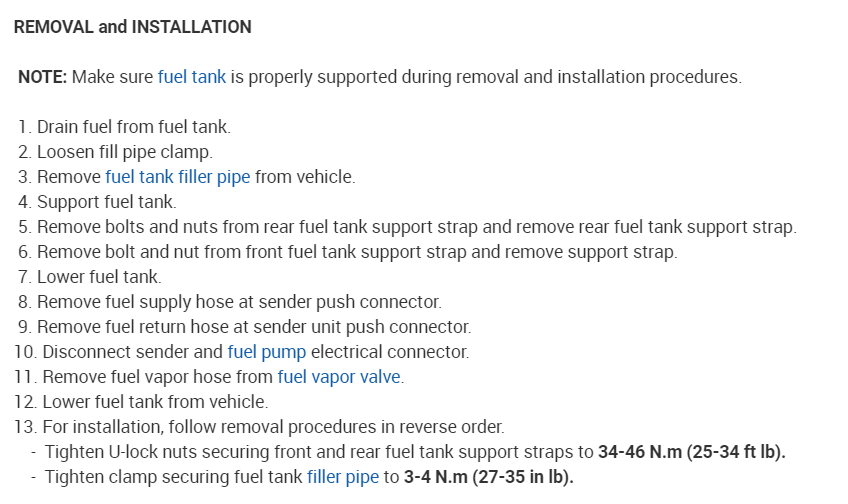

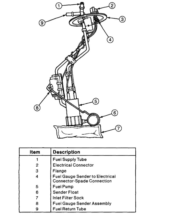

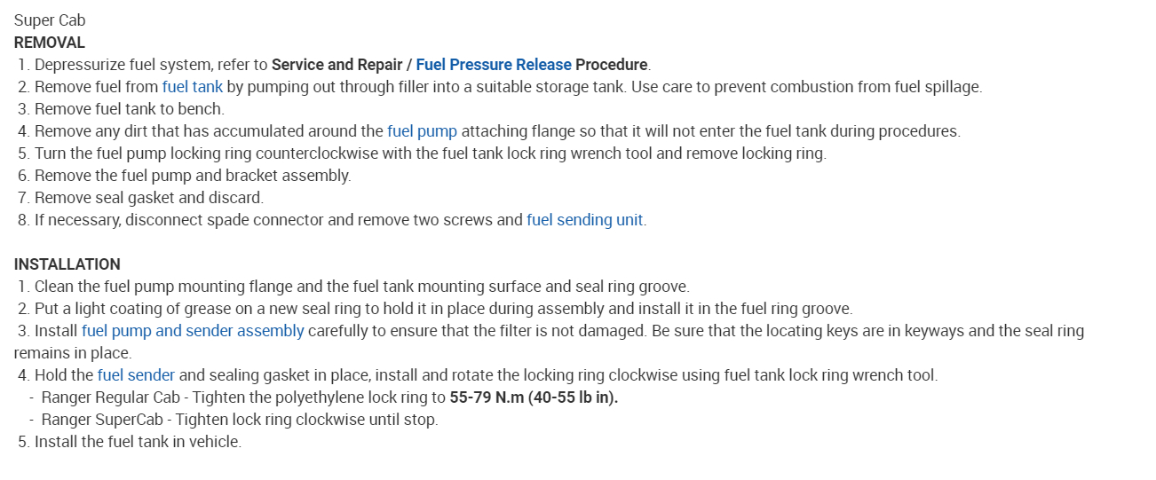

I do not see the image. It sounds like you have low fuel pressure but to be sure please follow this guide, you can rent a fuel pressure gauge from the auto parts store for cheap or free.
Key On Engine Off 35 - 45 psi
Key On Engine Running 30 - 40 psi
If the pump is bad make sure you drain the fuel from it before removal.
https://youtu.be/Q5MH2gnyFH0
