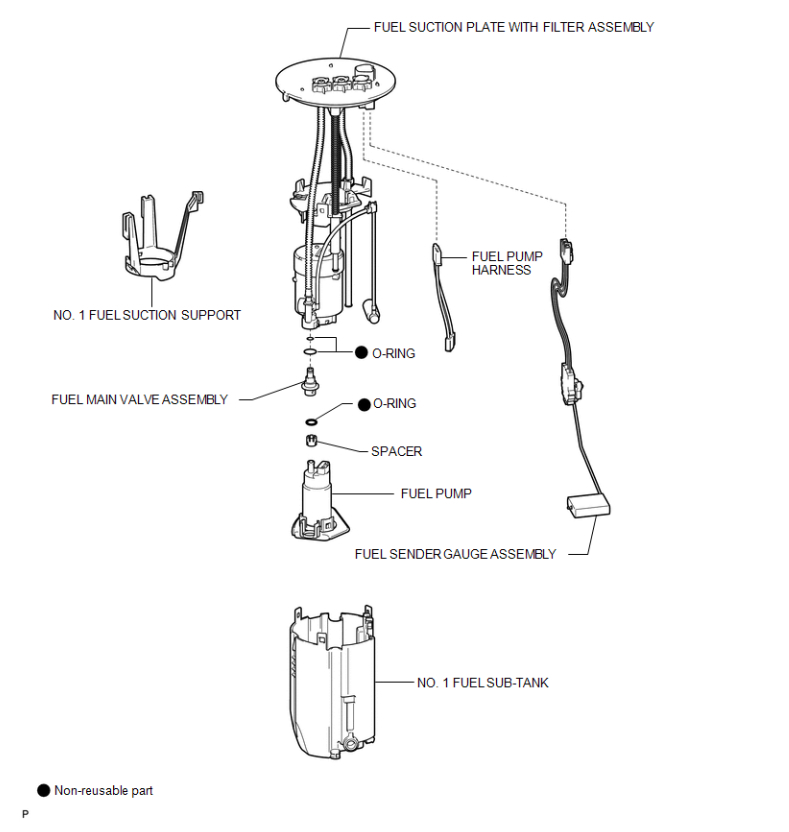

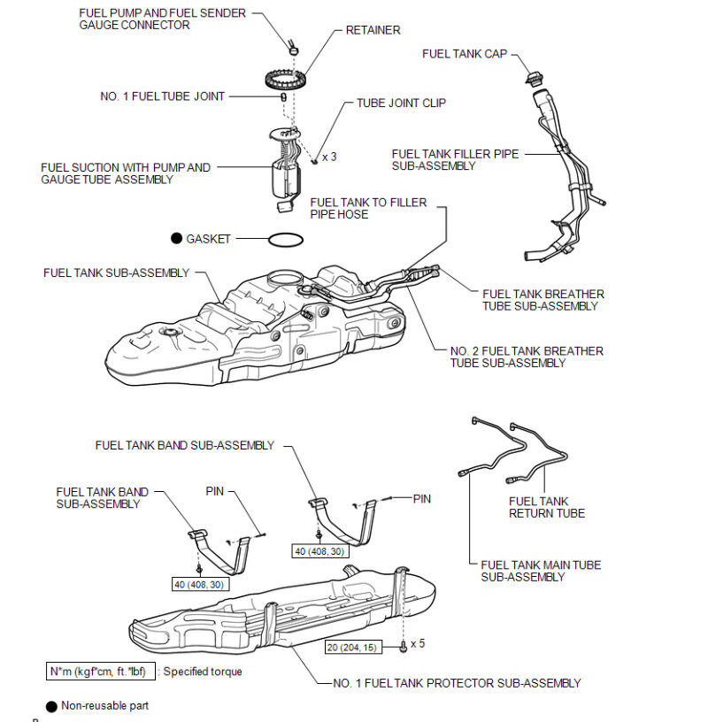

I would like to have a diagram of the fuel sender unit in the reservoir, how the fuel pipes that need to be connected. Fuel does not reach the gas filter in the engine compartment, but the low-pressure pump works well. Fuel just keeps rotating but never gets to leave the pipe which goes to the gas filter. Thank you.
Jun 15, 2023 at 3:04 PM
  • 54,837 POSTS
Sure, here is how the fuel pump is mounted and how the fuel lines connect to the pump. Check out the images (below). Let us know what happens and please upload pictures or videos of the problem so we can see what's going on.
