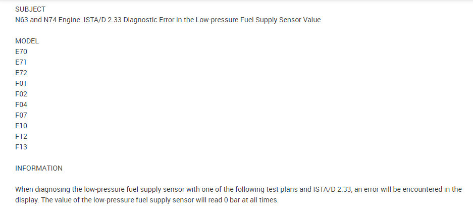

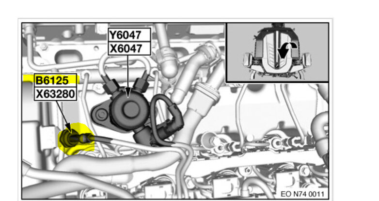

Please could I get the location of the fuel low - pressure sensor because I have a code on the engine ECU.
119201; fuel low pressure sensor, electric: short circuit to positive

Hi:
I have a feeling this is the 760Li. If I'm wrong, let me know.

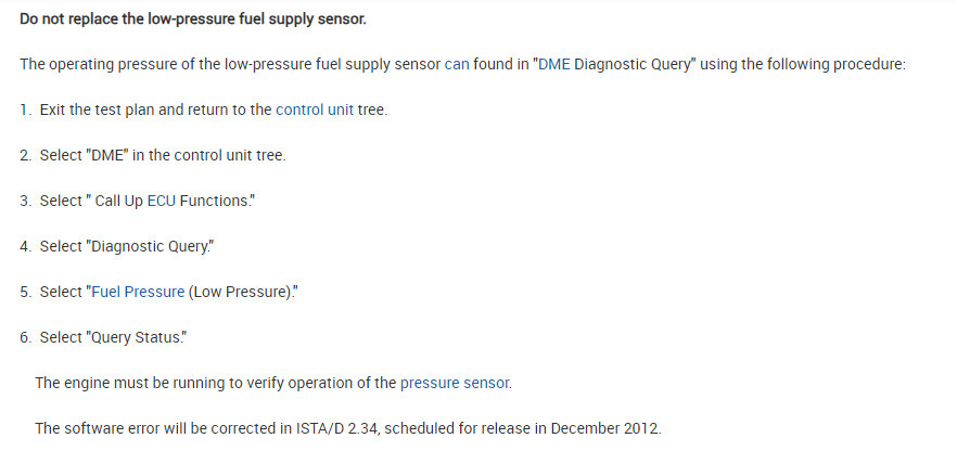

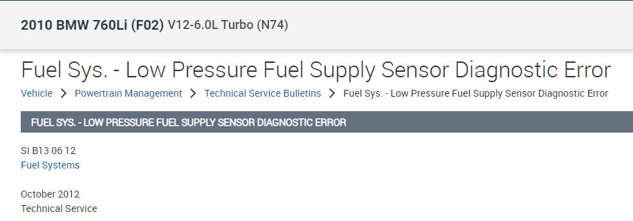

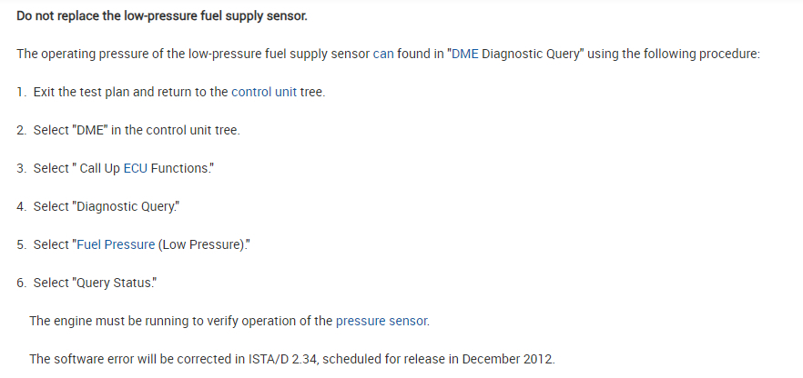

I attached a picture below showing the sensor. However, I found a technical service bulletin that indicates a software issue. I attached that as well.
Let me know if that helps.
See pics below. Also, if you have the P codes, let me know. The codes you are providing aren't showing up in any of my manuals.
