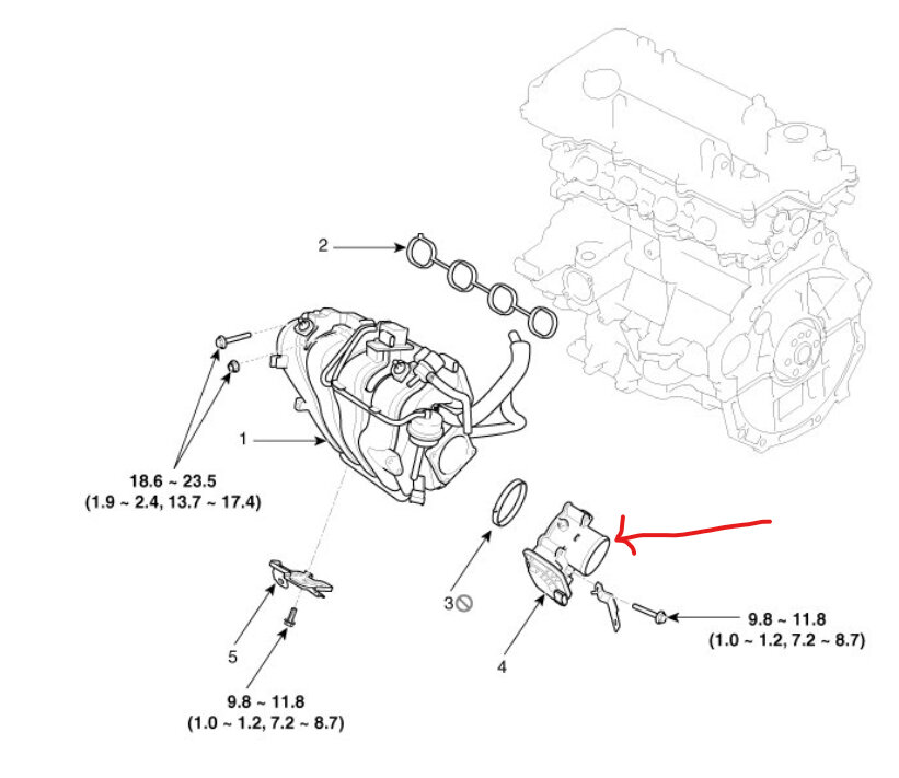

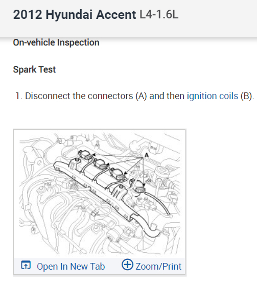

when i start my car, it bucks then stalls sometimes i put it back in park it stops bucking then sometimes when i drive it bucks a little like it wants to stall has power though.

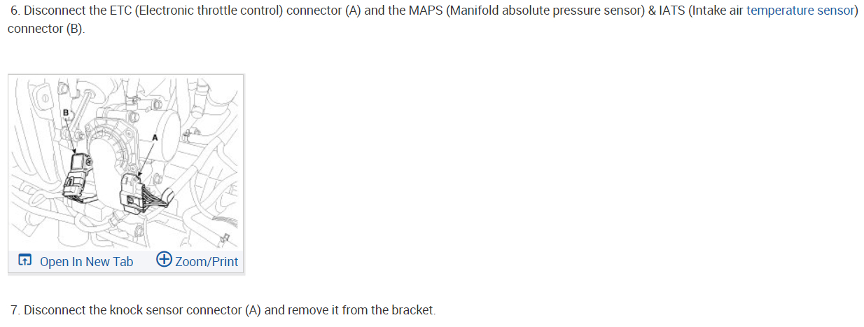

This can happen when you have a vacuum leak. But we should run the codes to see if any codes are stored.
This guide can help:.

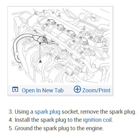

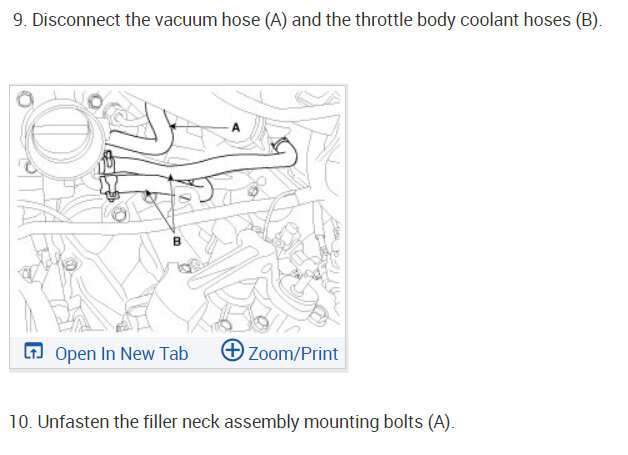

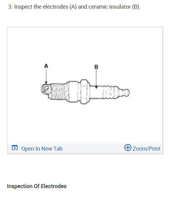

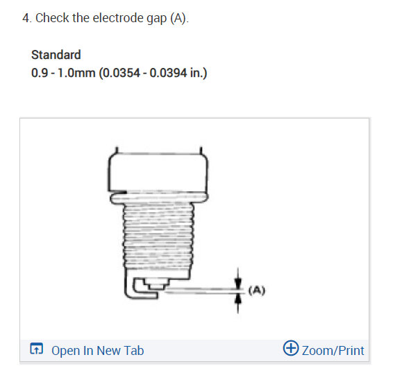

Can I ask if you changed the spark plugs? If not, I would start there as well, also I would service the throttle body.
These guides can help:
and use this guide when the engine is cold only.

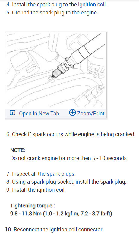

Here is information on how to do the work on your car.
Gap .................... 0.9 - 1.0 mm (0.035 - 0.039 in)

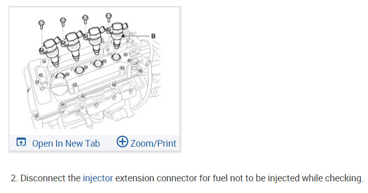

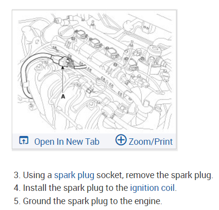

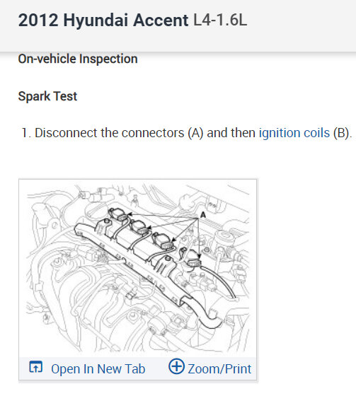

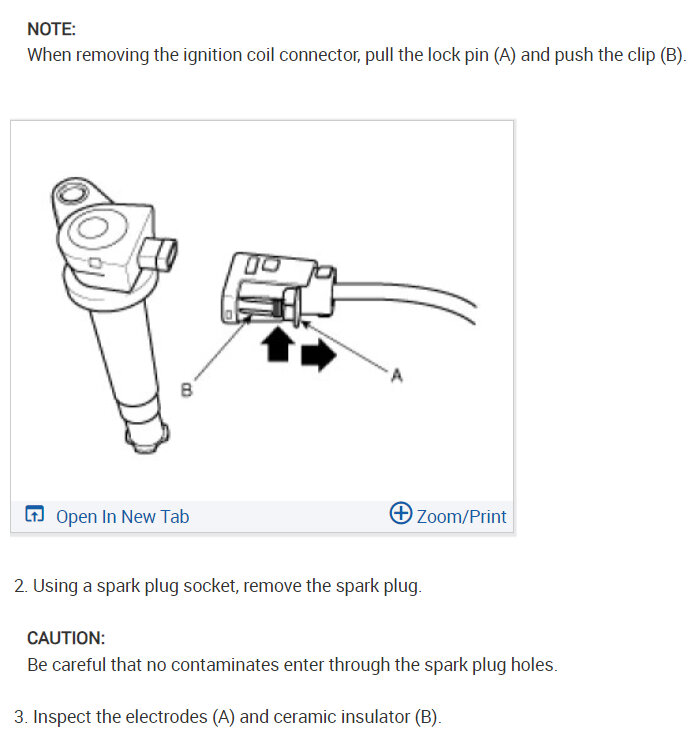

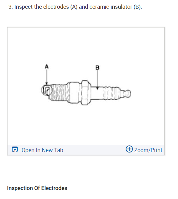

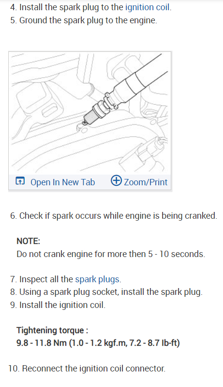

I would replace the ignition coils as well; they go out along with the spark plugs. Check out the images (below). Please upload pictures or videos in your response to the problem so we can see what's going on.
