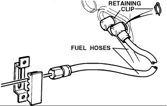

How do I disconnect the fuel lines of the bottom of the fuel tank to pull the tank?

Fuel Tank Hose Connections
Remove clips securing fuel supply and return hoses and disconnect from fuel tank. Fit protective plugs to open hoses and tank.
Remove sealing rings from hoses and lower car.

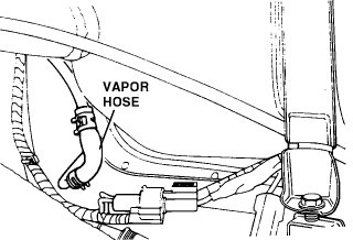

Vapor Hose
Disconnect vapor pipe assembly from underbody pipe.
Push back collars on quickfit connectors and remove vapor pipe and over-pressure pipe from evaporative loss flange port.

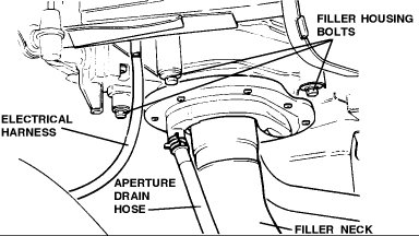

Fuel Filler Aperture Seal
Disconnect drain tube from aperture seal.

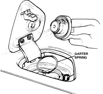

Fuel Filler
Open fuel filler cap and remove filler neck garter spring.
Remove filler housing bolts.
Displace filler housing from body opening. (It will remain on filler neck).

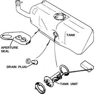

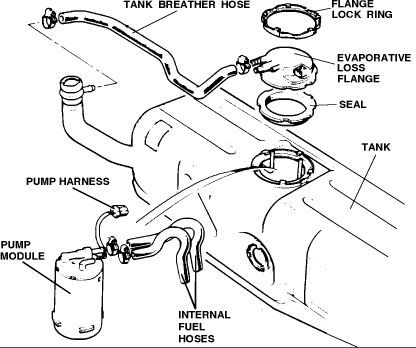

Fuel Tank And Pump Module
Remove hose from evaporative loss flange and filler neck. Bend weld tag upward to release hose.
Remove evaporative loss flange lock ring.
Lift flange from tank enough to disconnect fuel pump harness.
Remove flange and seal.
Inside tank, use Jaguar tool JD175 to loosen hose clamps and remove fuel hoses from fuel pump module.
Remove fuel pump module and mounting rubber. Note position of mounting rubber lugs.
Using Jaguar tool JD175, loosen hose clamps and remove two fuel hoses inside tank.
Remove tank sending unit.
Remove magnetic drain plug and clean plug.

I removed the fuel line clips but I cannot get ether line to let go very little room to get hand up there. Any Ideas?
Jun 12, 2018 at 12:12 PM
  • 55,325 POSTS
Can you remove the other side of the fuel line and just take the lines down with the tank? Can you send pictures of what you are talking about?
