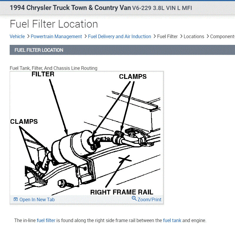

I'm having a hard time figuring out why there in no pressure from pump to rail. everything is on rightvansc. there is fas in the tank almost full actually, yet still no fuel at rail.

Are you sure the fuel pump hasn't failed? When you first turn the key on, do you hear the pump prime for approximately 2 seconds?
Also, there is an inline fuel filter between the tank and engine. It is mounted on the passenger's side frame rail. See pic 1 below. Has that been checked or replaced?
See pic below.
