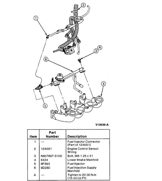

The fuel lines that go to my motor won’t disconnect. the quick connect tool that is the right size won’t push into the fitting. it’s the last thing I need to do to get the motor pulled. but I’ve tried everything and still no luck. I watched the video on how to do it and I tried it and it still wouldn’t go in! It is the fuel return line which is a size 5/8 and the tool won’t spread the spring. any ideas?

Got it.
You could remove the fuel rail from the motor and set it aside. You will be removing it while you rebuild the motor.

No, you need to release the clamps holding or securing the lines down under the engine by the transmission. Then Release the fuel rail with the injectors and set them off to the side.

I would take the rail off the donor motor and install the rail from your motor with the lines connected to the donor motor.
