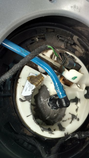

Fuel line that connects to top of sending unit
150,000 MILES • 2.0L • V6 • 2WD • AUTOMATIC
JOHNNIE LEE YOUNGBLOOD
Need to find out where the fuel line that connects to the top of the sending unit goes to so I can replace the whole line

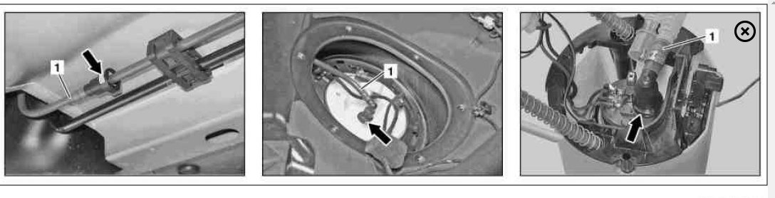

This line runs the entire length of the car and connects to the fuel rail lead by the engine.
Please let me know if you need anything else to get the problem fixed.
Best, Ken

Can you send me a picture of where it connects and what side it runs along the car. Im just trying to replace the faulty leaking quick disconnect and if I can find it without taking the whole line out it would be great

Actually it look like the plastic line only runs to the front of the tank and then connects to a metal line. Lucky you!
Here is a diagram
Best, Ken
