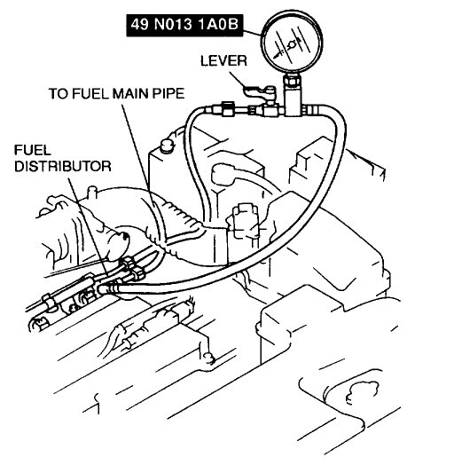

I want to measure fuel pressure. i am wondering what size is the fuel line. I am looking for fuel pressure kit that fits my car.
Apr 13, 2018 at 10:07 AM
STEVE W.
  • 15,200 POSTS
You need the special adapter that goes between the supply line and the fuel rail so the gauge can tap into the line, it will be in most pressure test kits. This guide can help
Do not try cutting the line and tapping in, it will leak and probably fail. If the pressure test kit you have does not have it check the parts stores for them, they are a common fitting. Check out the diagrams (Below). Please let us know if you need anything else to get the problem fixed.

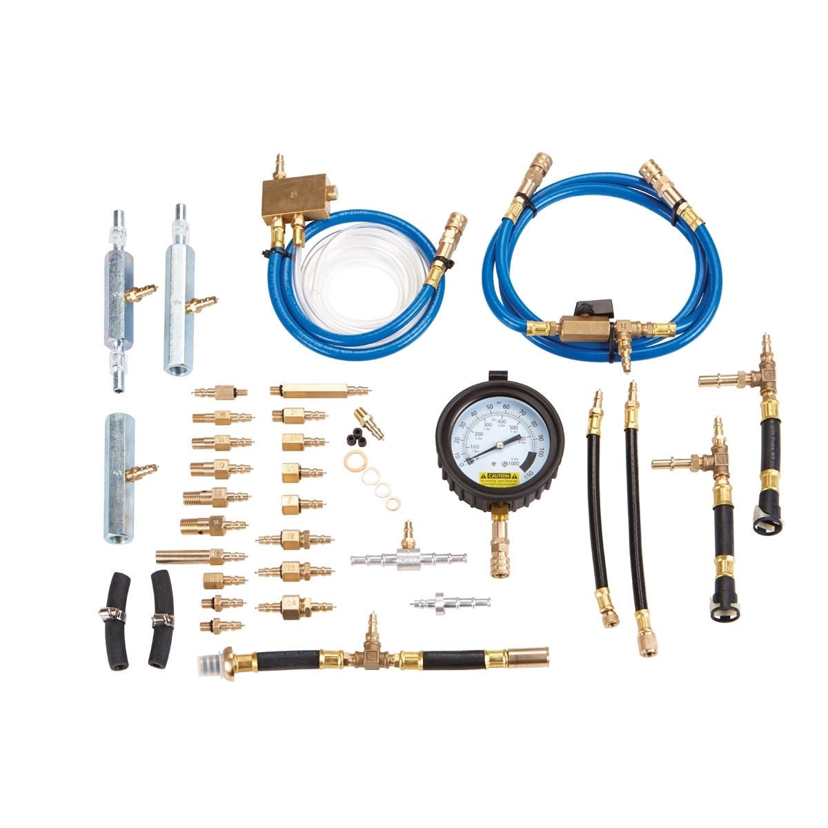

I do not have a fuel pressure tester neither the adapter . i was looking online i do not know which one i need to get
Apr 16, 2018 at 8:56 PM
MIKE H R
  • 3,094 POSTS
Most Auto zone and advance auto have fuel pressure testers they loan out with a refundable deposit that as all the fittings for most cars and trucks.
Apr 17, 2018 at 12:03 PM
STEVE W.
  • 15,200 POSTS
As MH says, the loan a tool kits will have a bunch of adapter fittings and lines to make them work. The one you want will plug into the factory fitting for the fuel rail.
